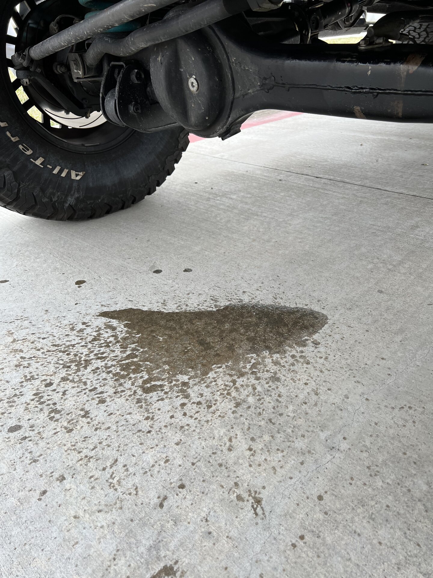

Howdy yall.
My 1HD-T injector pump has a good drip at times. Seems cold induced. Comes and goes. 270km on it. I deleted ACSD myself, but IP work frightens me.

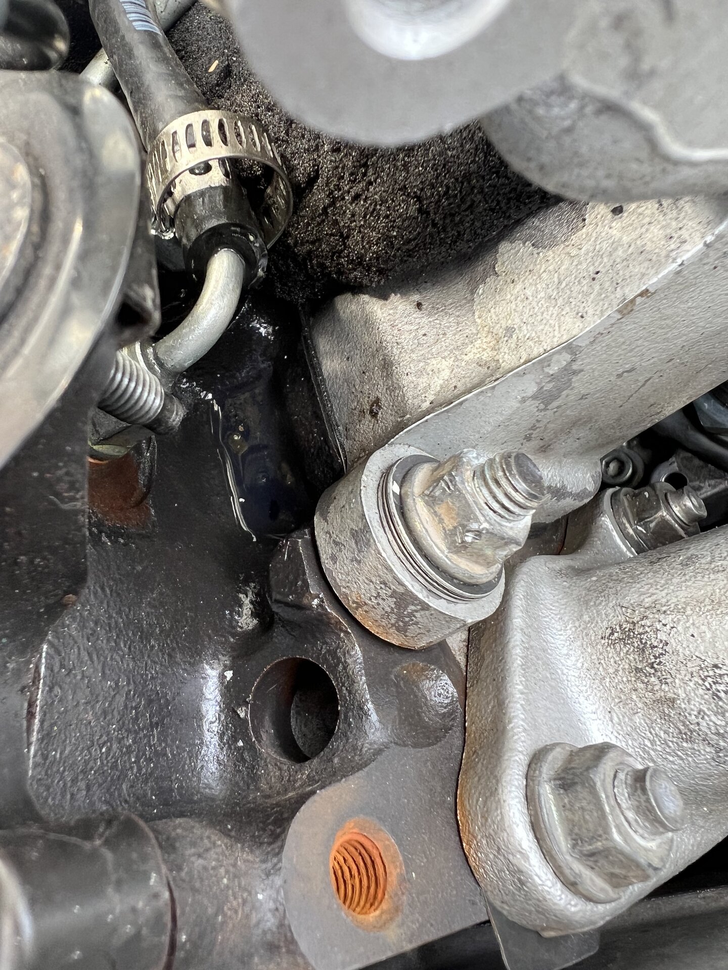

Grab a flashlight and look around for the source of the leak. Some of the seals are easy to do with the exception of the pump body one referenced above.
I like Pacific Diesel Injection in Portland, OR.
I had the #1 injector nozzle leakage pipe … drip at the little hose joint in Amarillo on my 1hd-fte converted lx450.
Looked for all the world like it would’ve been the IP, (and it’s a new pump out of Saudi) … but nope.
Yes that hose clamp is way too big. I didn’t put it there but I will be replacing it (and its brethren) as soon as I figure out and obtain the correct sized hose.
