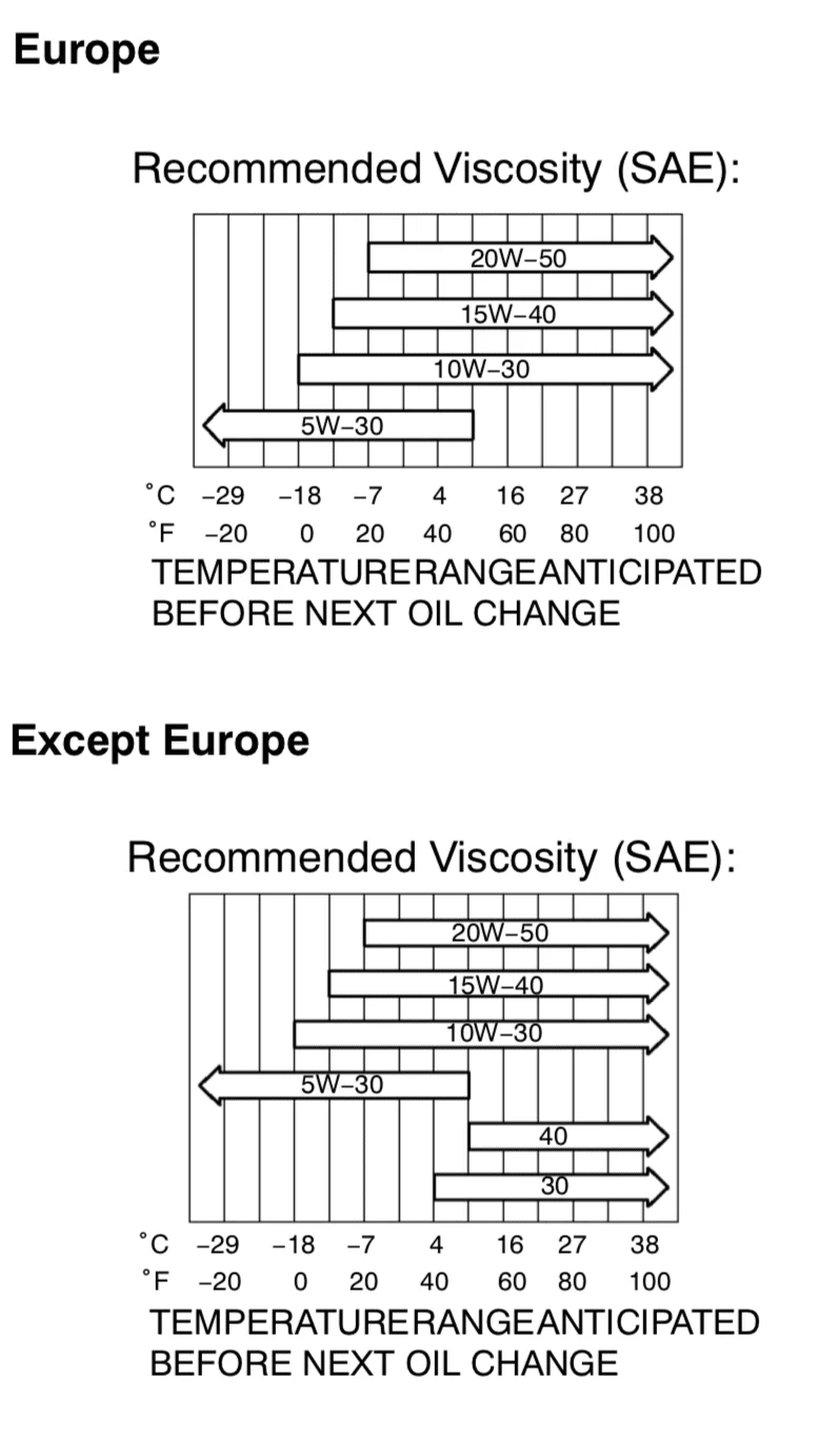

From the diesel manual:
screenshot-2019-03-06-at-13-03-02-png.1920679
Europe/Except Europe is due to different turbo, EGR cooler and other European emission related things
