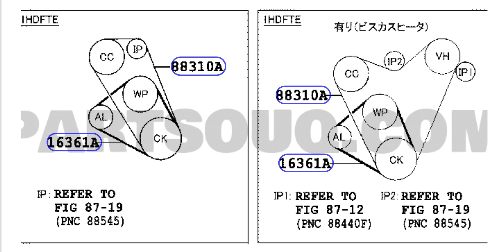

I’m seeing two versions listed, but I don’t know which I need. Mine is the one in the left diagram, 88310A, without the viscous heater. 1998 JDM HDJ101. Is it 99364-31240 or is it 99364-31720? I can’t find which is which. Thanks.
99364-31240 is the part you want. 1240mm in length. Available from overseas. Not available from US Toyota dealers.
Thank you! I saw an earlier thread where you did say the lengths are indicated in the part numbers. That’s really good to know. Even the parts catalogues with vin give me two options. Hopefully this is helpful to someone else as well. I appreciate the response.
