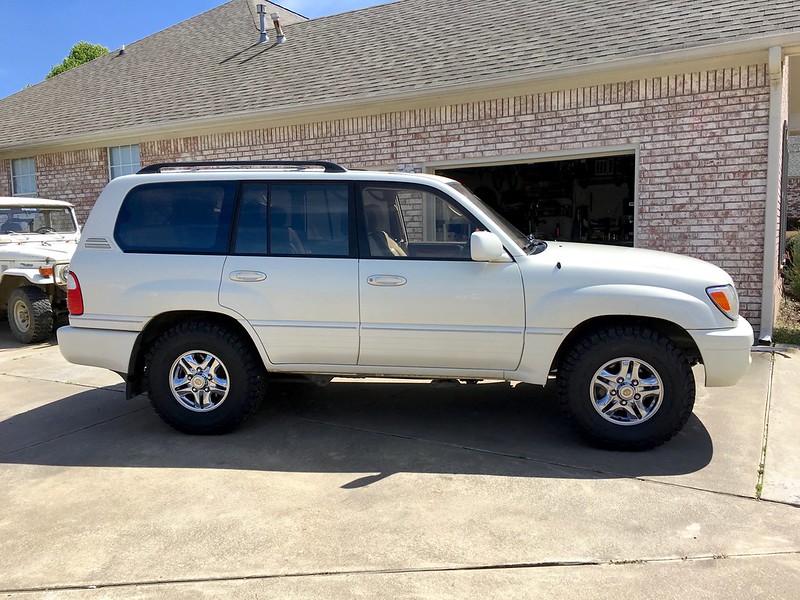

I put 33 inch tires on my LX last May. Plenty of clearance with stock AHC.
I have 305/65r18's on stock AHC and ride around in neutral all the time (when not on a trail). My tires are 33.6x12 inches and all I had to do is trim a tiny piece off of the inner fender. Keep in mind that I have a +35 (+60 is stock) offset which allows a wider tire.
