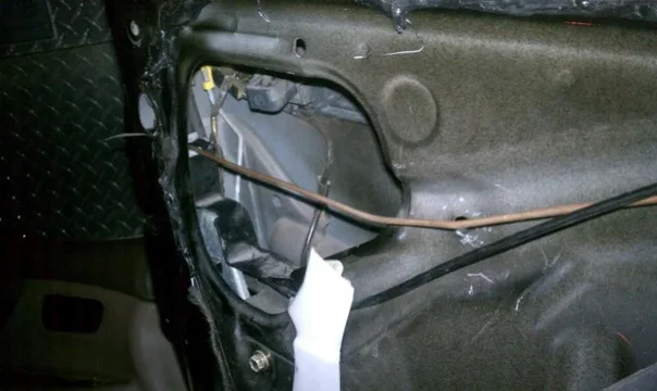

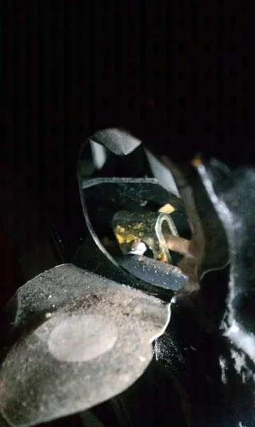

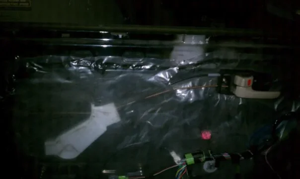

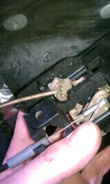

This is a total resurrection of an ancient thread. I ended up having the same issue, broken cable. After reading and finding out I can't just buy the cable, and how expensive the alternative would be, it dawned on me that in older Toyotas, the connection used to be a rod. So to save a ton of money, I made a connector rod. It worked perfect!
Cleaver repair. If it holds up that's awesome. The driver's door cable broke in my 1998, I think the door lock actuator assembly was around $300. I saved the broken assembly part for some reason. My passenger door lock actuator went out very shortly after, so I was able to steal the small motor from the broken part and fix my passenger door for free.
