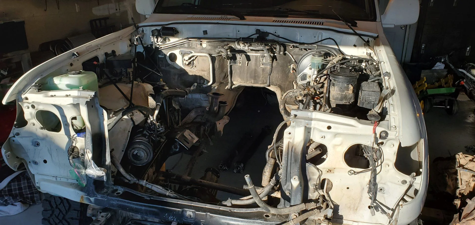

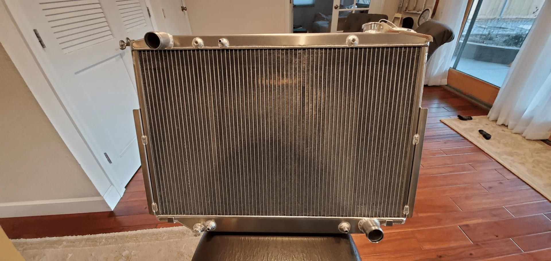

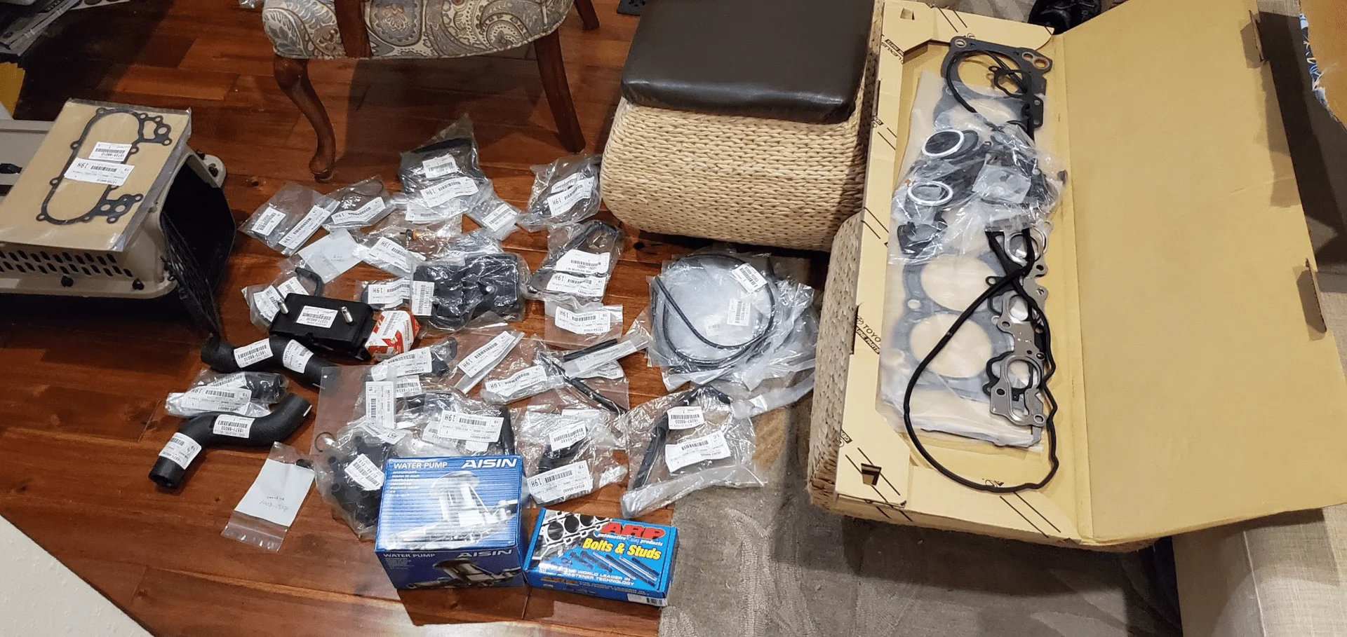

I think I am going to start tearing into Kronk tomorrow. Got most of the parts, and some extra tools that I didn't have before (like a 300 ft-lb torque wrench). I went ahead and sprung for the Ron Davis raddy. It is supposed to show up Monday.
Anyway, just in case you were wondering what ~$1K worth of parts looks like:

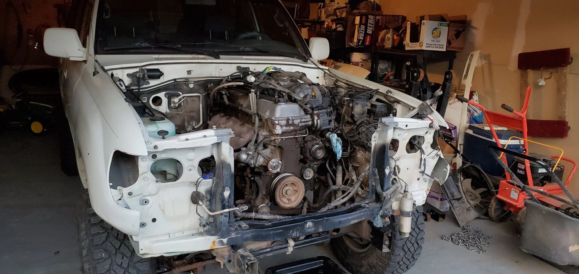

I didn't get much time to work on the Cruiser yesterday. Did get the ARB bumper pulled. Hoping to get rolling today.

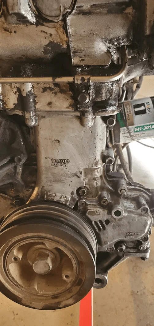

Big breaker bar against the frame, a quick turn over of the engine, crank pulley bolt lose.

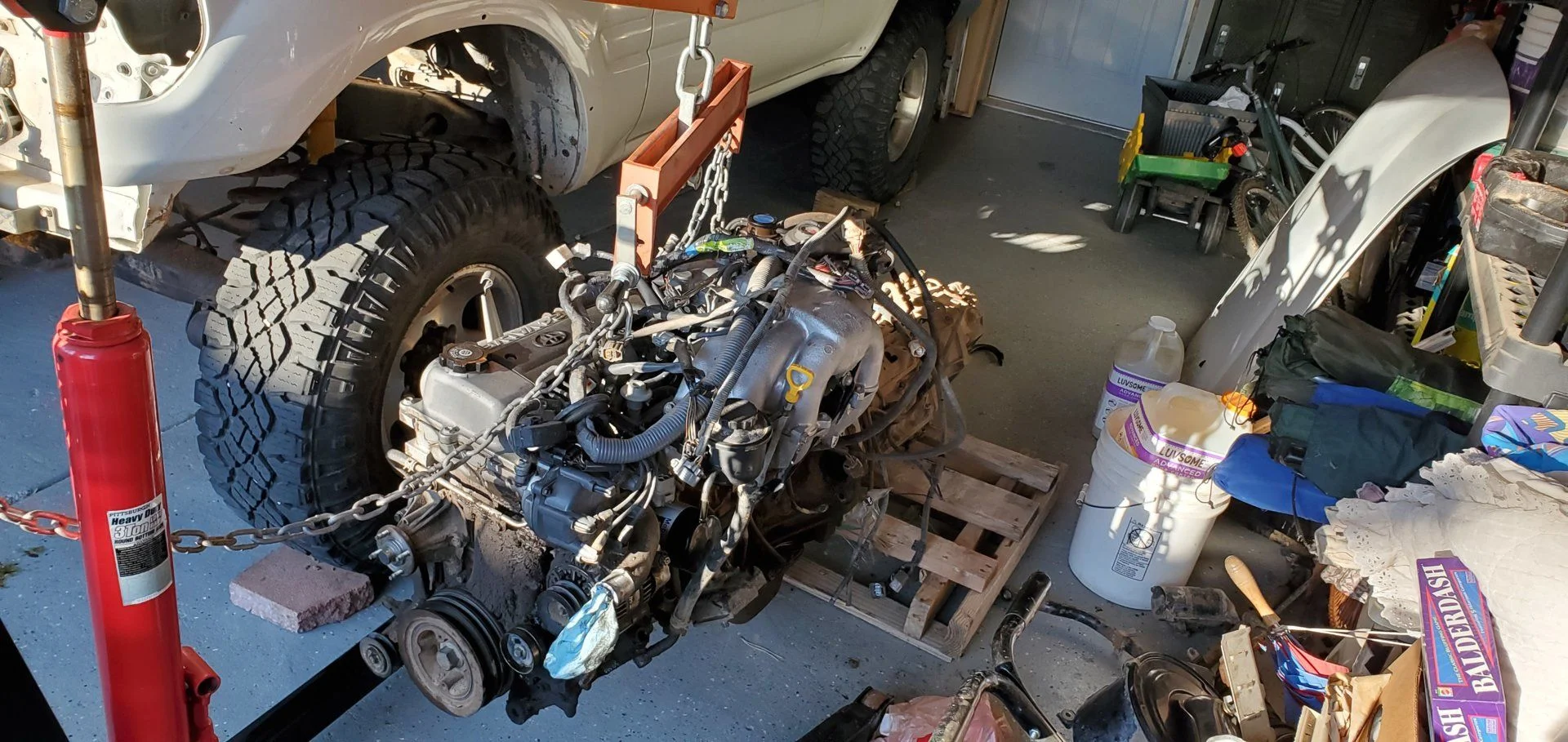

I have done the starter bump method with previous vehicles, but to be honest - I forgot about it until I had all of the electrical pretty much torn apart. Luckily the impact wrench is as strong as advertised.

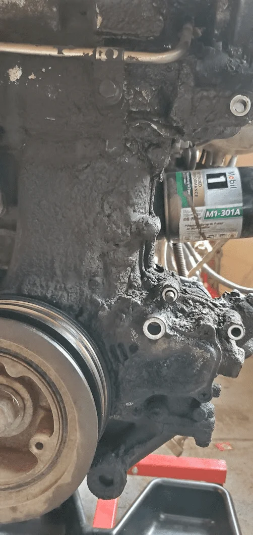

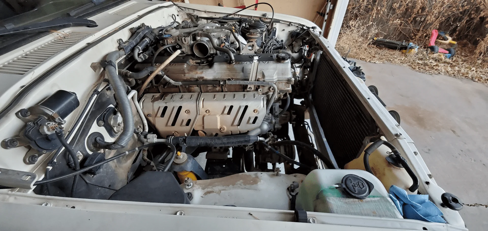

Got some more work done today, but didn't disassemble too much. Spent time degreasing before opening too much up. Also, the previously "fixed" arch seal appears to be leaking again.
Got a bit more done today. Just about ready to crack the head bolts, but ran out of time today. It appears that pretty much all of the valve guides were leaking. Dizzy o-ring was cracked - that was the major source for most of the grime on the front end. I went ahead and ordered all of the seals for the timing chain cover as well. With the condition that dizzy o-ring was in, I figured I might as well just seal everything up again.

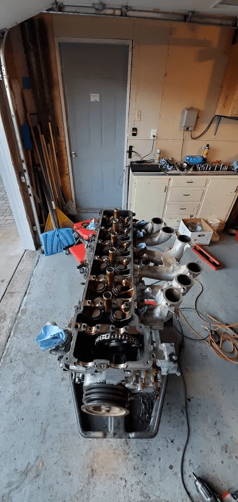

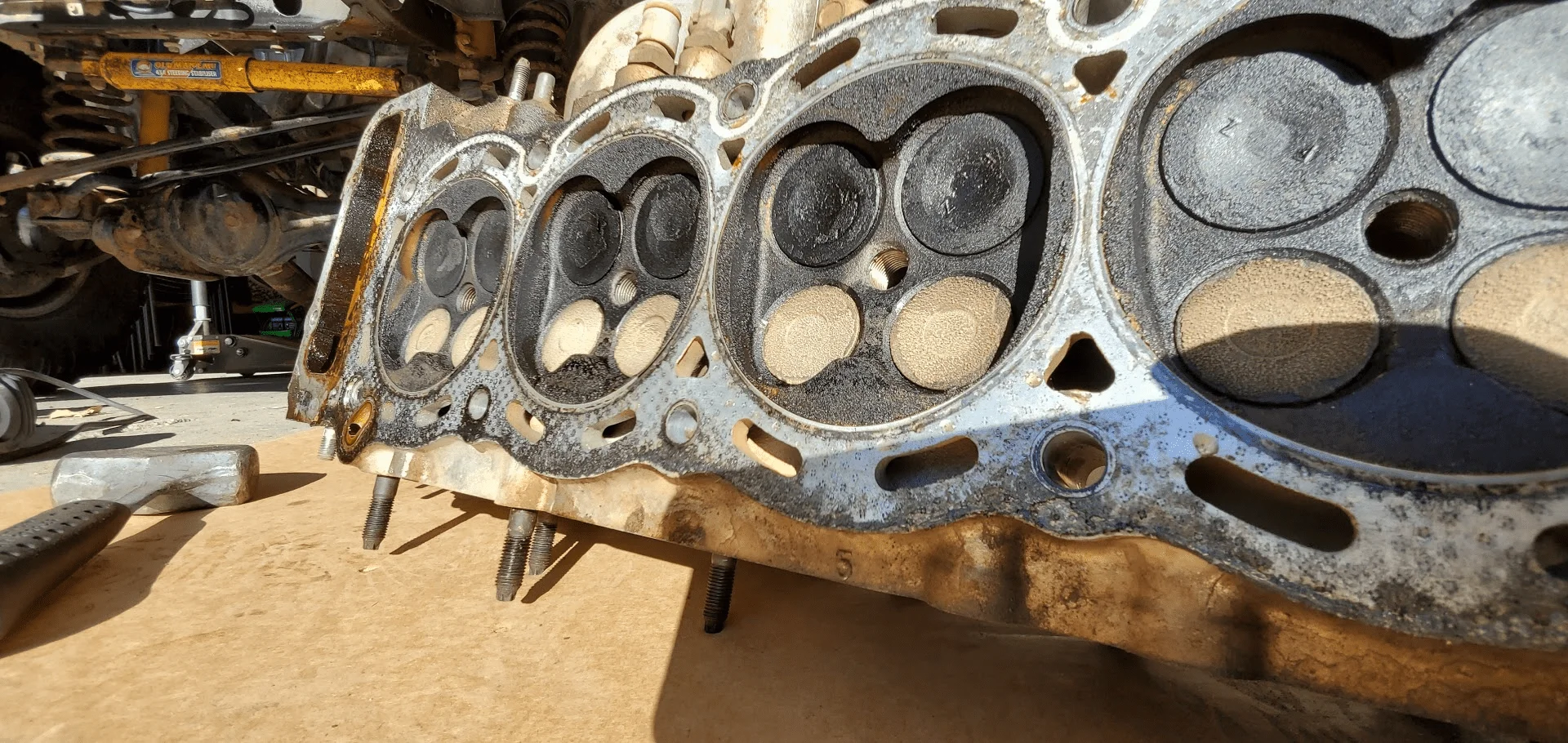

Got the head pulled today. I don't see any real difference in the appearance for the valves on cylinder #3. The cylinder walls all look pretty good - I can still make out some of the cross-hatch. I was sort of hoping to be able to see an obvious reason for the low compression in #3, though. Makes me think that I should have done a leak-down test. The wet test did bring the compression up slightly, but not much. Definitely glad I did all of this, though. The valve guides are definitely leaking. I am wondering if it is the rings after all causing the low compression, though. Or maybe I effed up the compression reading on the cylinder....with two different gauges....:rolleyes:

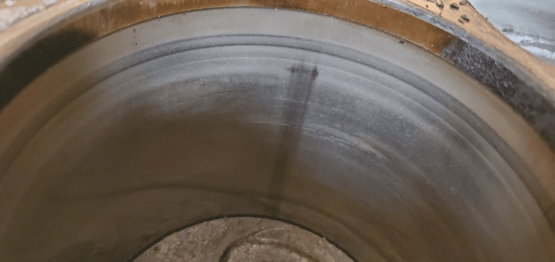

I dropped the head off at the machine shop a few days ago. In the meantime, I have been going over and cleaning parts. Today I went to start cleaning the head mating surface. I started by cutting cardboard circles to put into the cylinders to help stop any debris from getting down in between the bore and the piston. I pushed the circles in place, and then I saw something in cylinder #3 that I didn't notice before. I don't know how I didn't see it the other day - a vertical mark. At first, I thought it was from something stuck to the cardboard I had just pushed in place. I removed the cardboard and spun the crank slightly to lower the piston, and it wasn't from me putting the cardboard in - the mark continued down lower than where the piston was resting when I put the cardboard in.
I have no idea how I didn't see this the other night - maybe it was the funky lighting in the garage - but I could have sworn I hit each cylinder with a flashlight. Anyway, I can't really "feel" this mark - but cylinder #3 is the only one that has one like it, so I am assuming that it is the reason that I had lower compression.

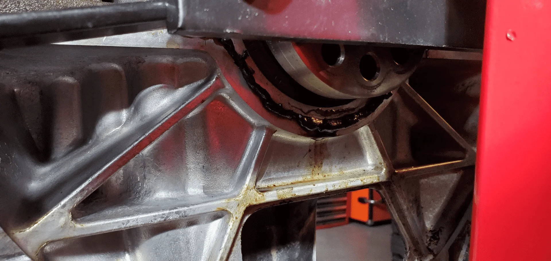

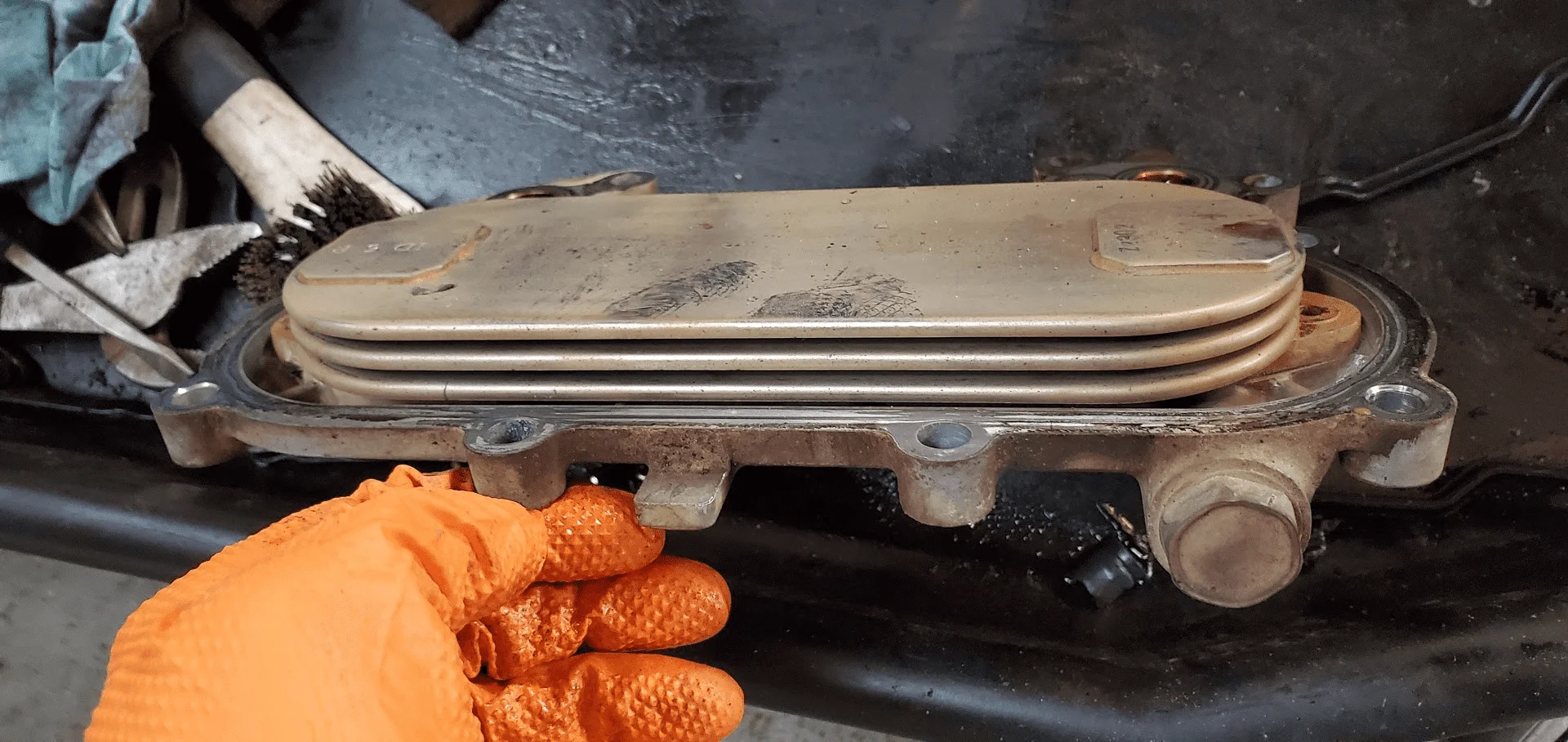

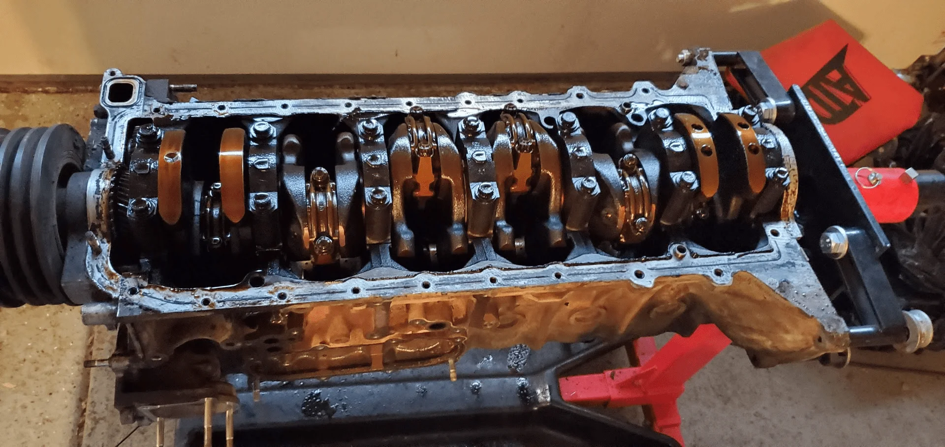

Well, I figured that since I am in this far, let's just do it right. My OCD side wouldn't have liked it otherwise. This way I can get everything truly clean and baselined. So, I started tearing into it more. The oil cooler looks really good compared to some I've seen. I got the oil pans pulled. I have to go snag a dial indicator and some plastigage before I tear down any more.
I got everything torn down and ready for the machine shop. I didn't take any more pictures, but all of the bearing surfaces on the crank looked great.
I am going to take it in and have them clean it really well and then measure the bores for me. Hopefully everything will able to be cleaned up with a just a hone. We shall see. I'll have them inspect the crank and pistons as well.

Very strange to have vertical marks like that on only one cylinder.
