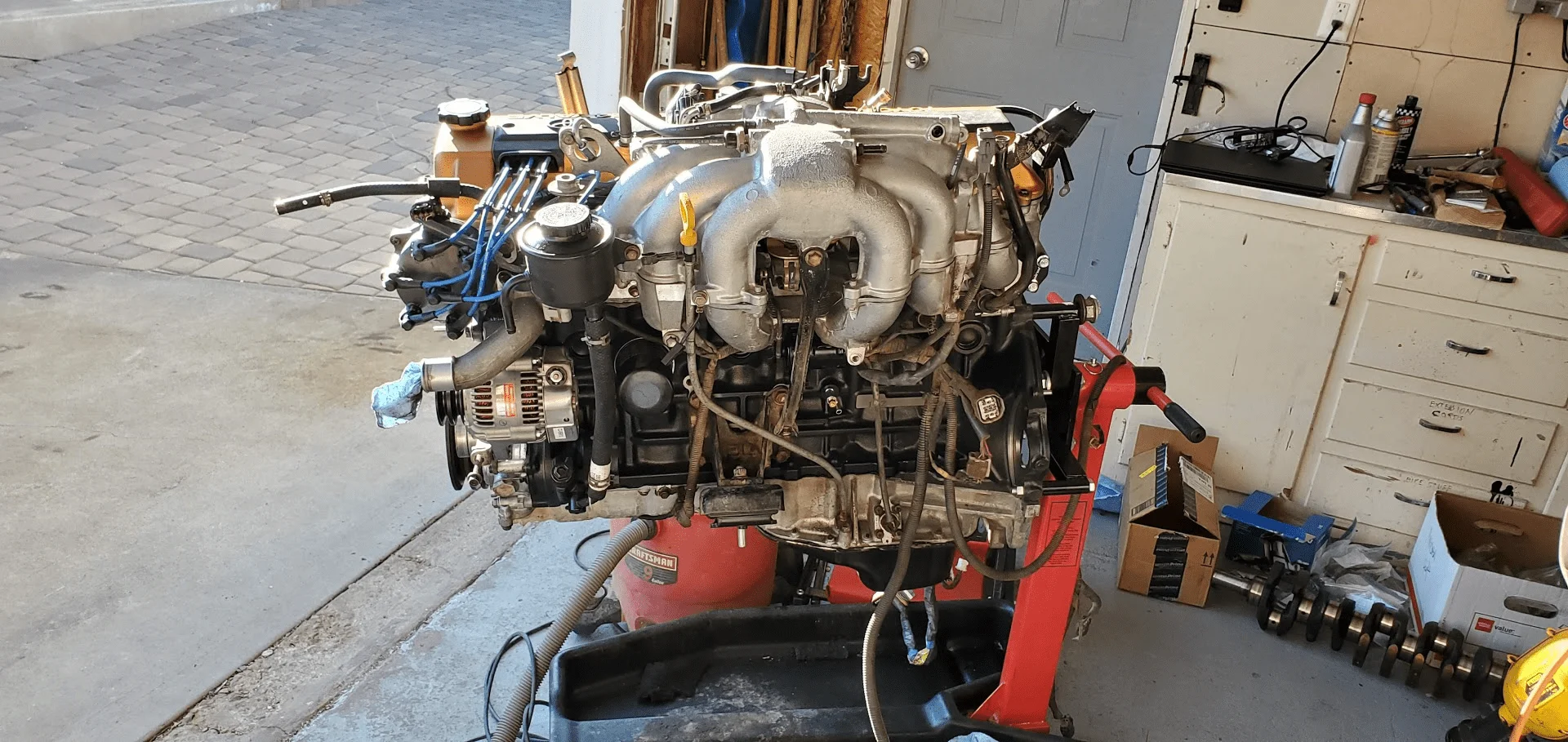

Getting some more work done. I went through all of my valve shims and mixed and matched to get five of the valves in spec. The rest I ordered new shims for from partsouq. They were half the price of anything in the states.

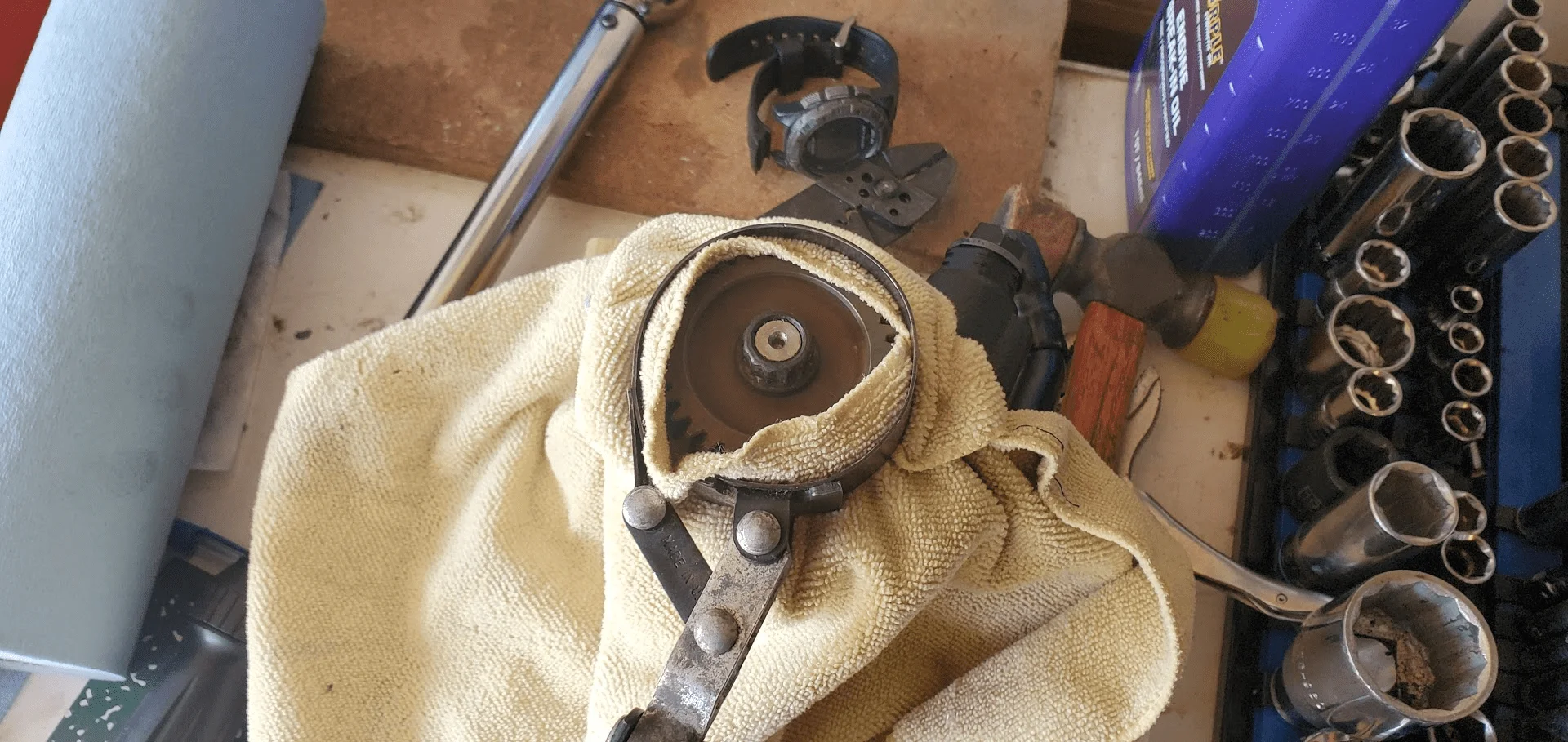

In the meantime, I am assembling what I can. I transferred the power steering pump gear to the new power steering pump. I used an old filter wrench and a towel to hold it in place while I torqued it down to 54 ft-lbs.

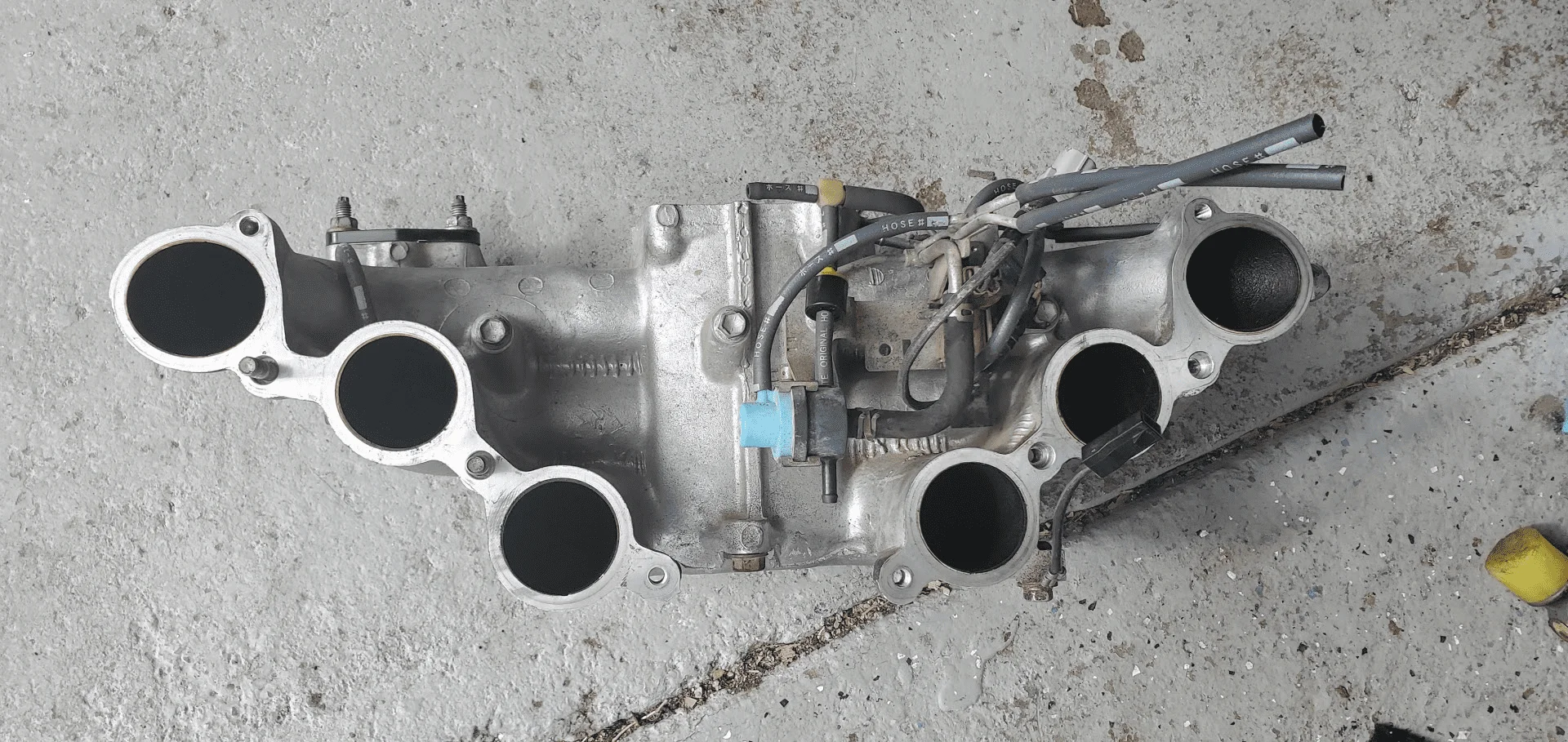

I also replaced all of the vacuum lines under the upper intake. I am deleting the EGR on this rig, so I decided to ditch the EGR VSV. I wanted to keep the charcoal canister and fuel VSV, though. One question: If I just unplug and remove the EGR VSV, is it going to give me code? Do I need to put a jumper in or something?
Anyway, a few pictures:
No VSV and new hoses:

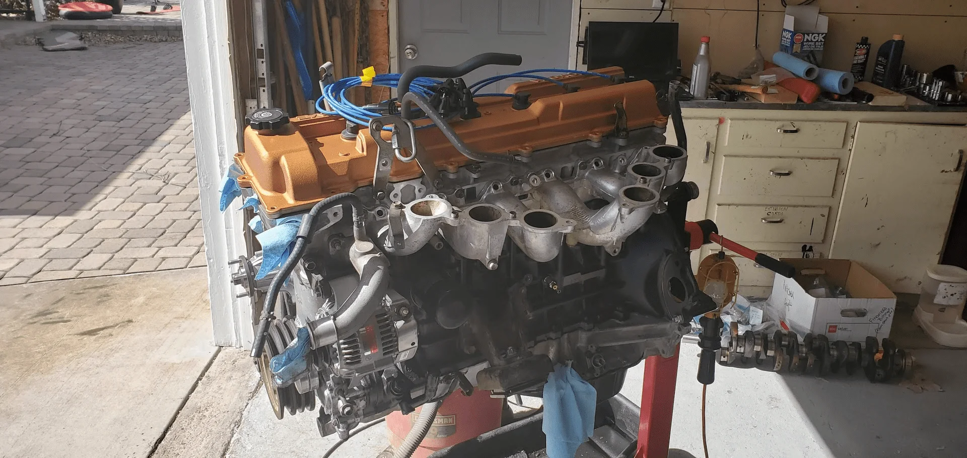

Valve cover is temporarily on just to keep stuff out. Still have to adjust the valves:
This is what I used
Yeah, I have all of those - you can see one of the keychains in the picture of my upper intake. I just decided to also remove the EGR VSV from under the intake plenum. I wasn't sure if unplugging that connector would cause a code. I did some more digging and found a post that seems to indicate that it should be fine.
yea I just used the test plug, and it did not cause any codes. It took my p401 egr code away.

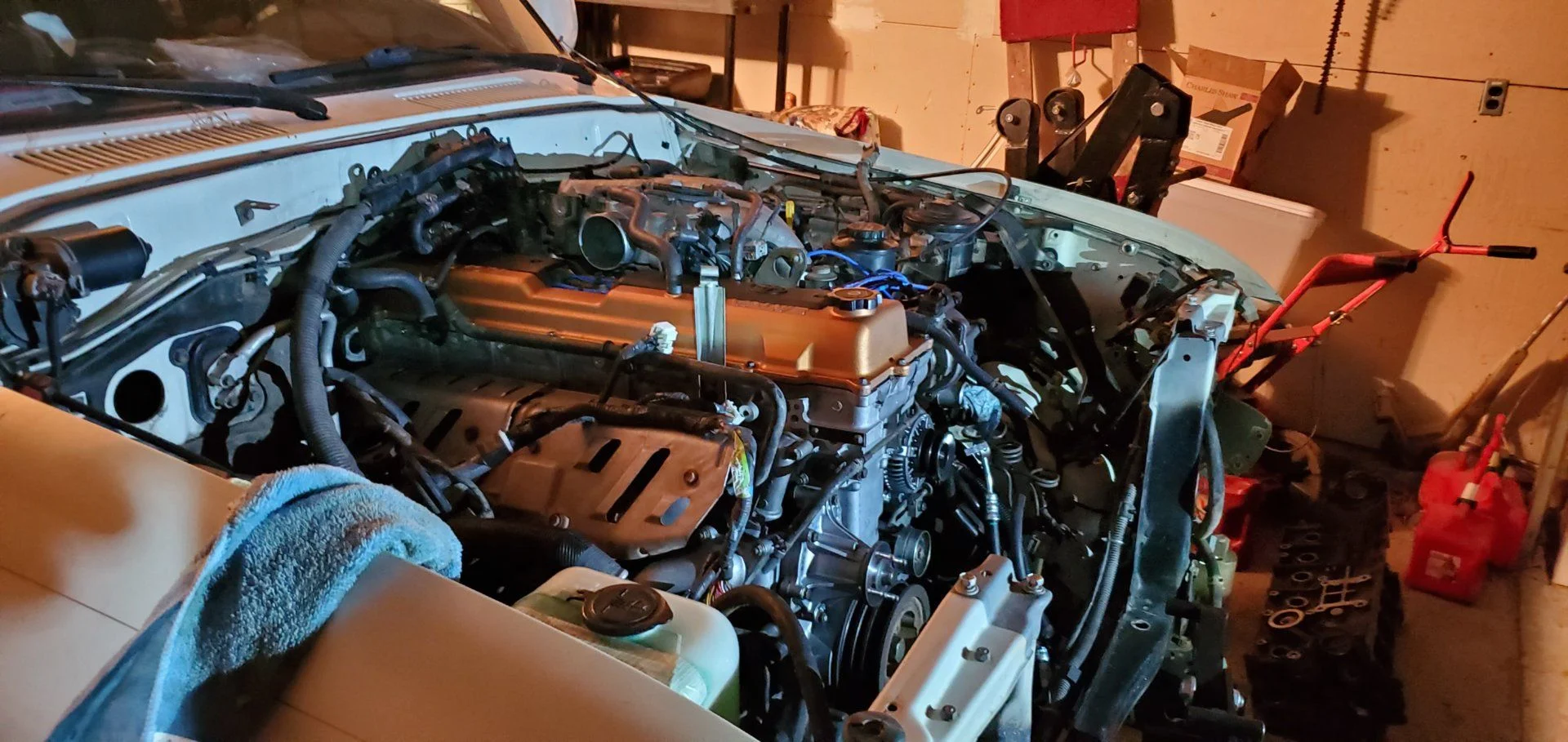

Got all of my valve clearances within spec and finished buttoning up the engine. I then started tackling replacing the hoses near the rear heater core. Man, what a PITA. I hate those stupid roll-up hose clamps that Mr. T uses. Then, getting a knife up there to cut the crusty hoses off is a reach. I got one off, but had to quit for the day before getting the second one off. After replacing the hoses, I will flush the front and rear cores prior to dropping the engine back in.
Got all of the hoses for the rear heater core replaced. Then I went to mate the engine to the transmission. Fought that for about 1.5 hours and threw in the towel. Jeebus what a stubborn bastage. Will hopefully get some time to go mess with it some more tomorrow.

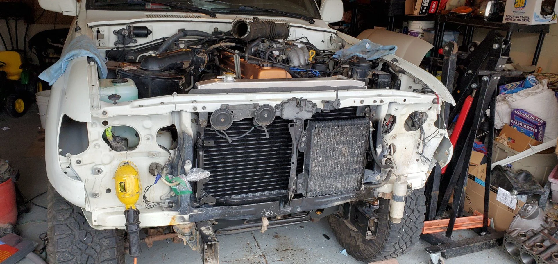

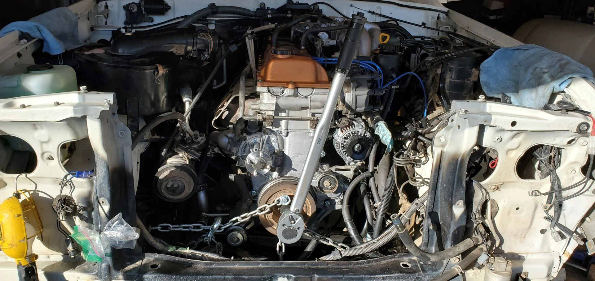

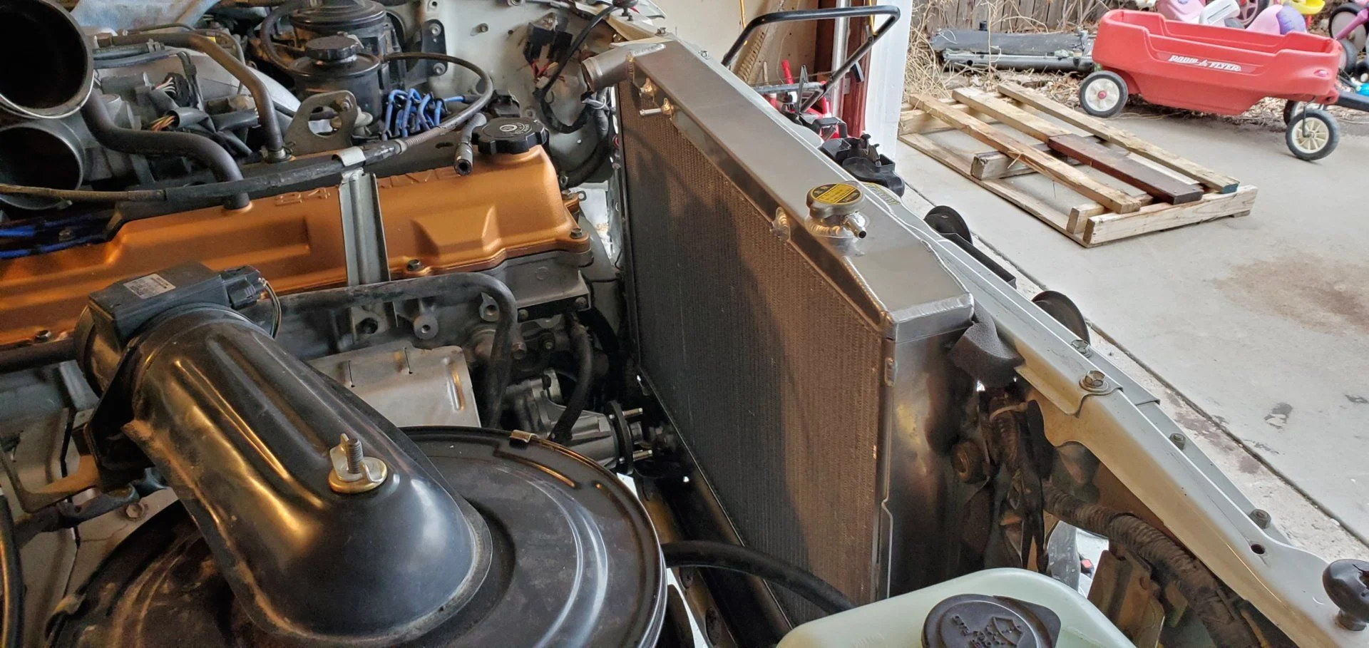

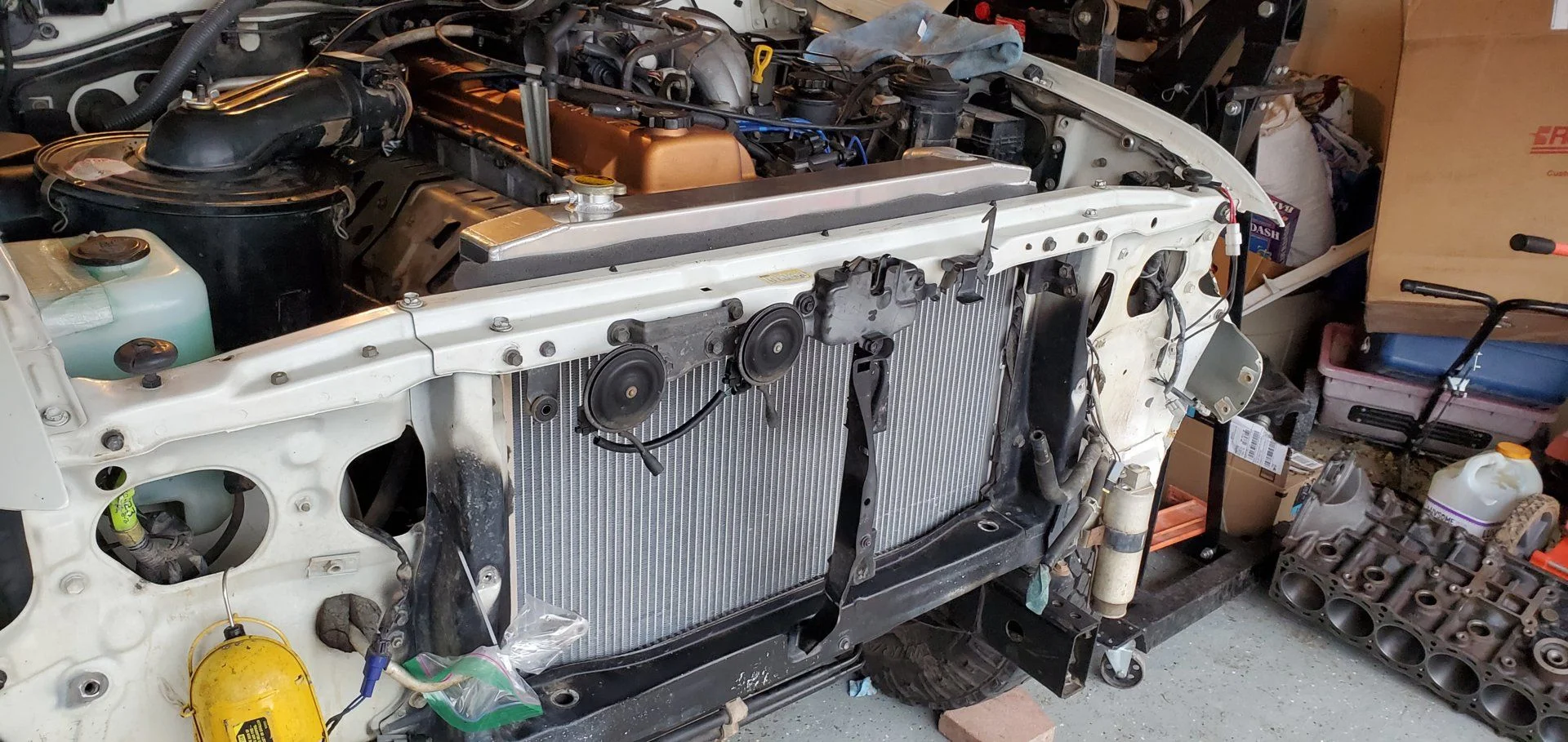

Finding a bit of time to work on Kronk here and there. I had a big note to myself to torque the crank bolt taped to the steering wheel. I got that done and all of the electrical connections made as well as the accelerator, cruise, and kickdown cables connected. Next up is dropping the new RD raddy in place.
