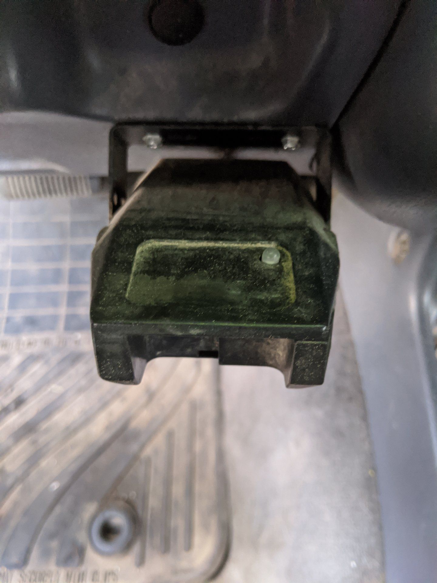

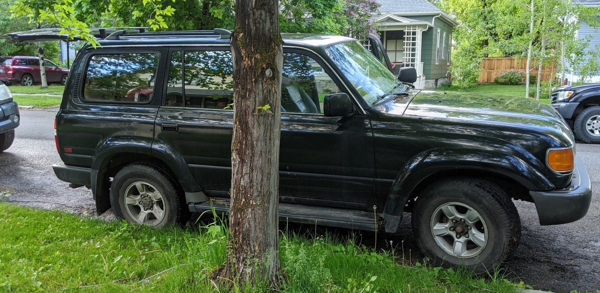

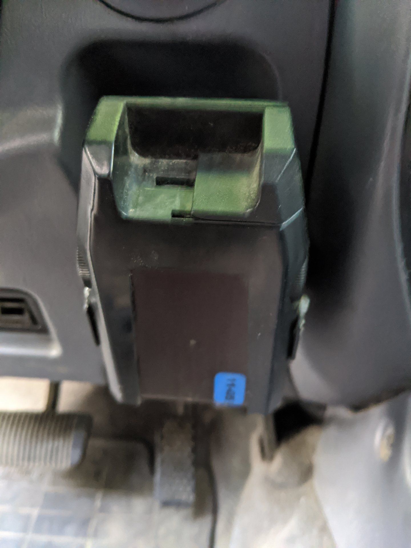

In your first set of pictures posted the hood and driver side fender look real shiny like they have been repainted. Given the DUI Immobilizer that may explain the new paint although all the dirt in the engine compartment indicates it may have been a long time ago.
Isn't that a trailer brake? The sliding switch is to manually engage the trailer brakes and the other two knobs should be the settings right?
