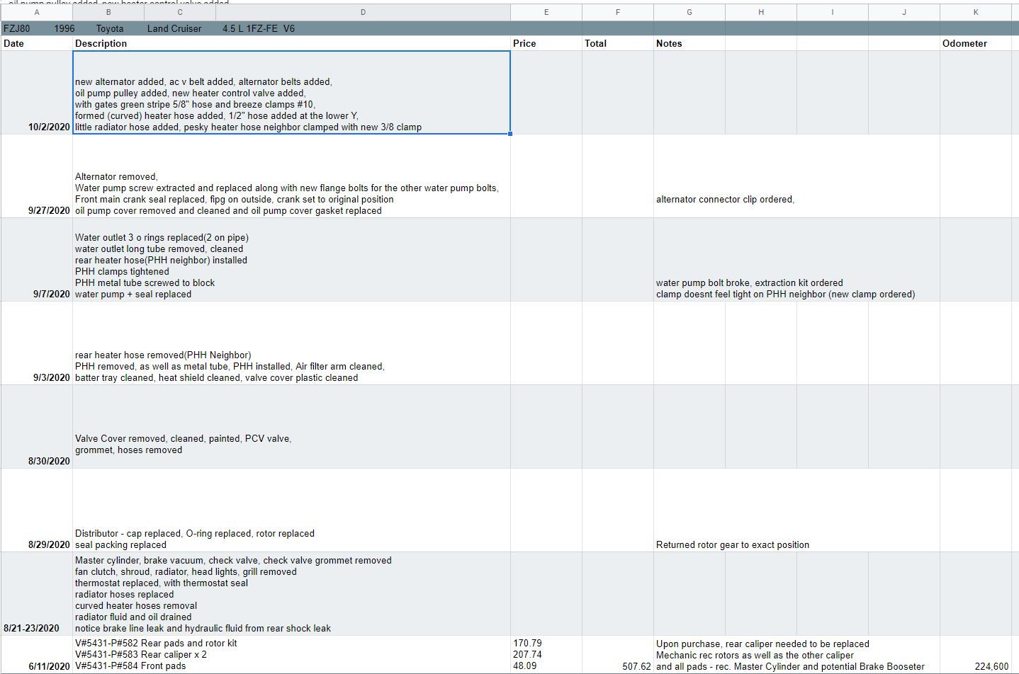

Yes! I bought it - I took it in to the mechanic immediately to fix the brake issue as I didn't even want to drive it to the garage im doing work on it in. They ended up doing more than just the rear passenger caliper and pad, they did both rear rotors, calipers, and new pads on all brakes. Then they wanted to do the master cylinder and potentially the power booster. I picked it up and started ordering parts to get to work on it on my own - that spreadsheet up above shows the things I have ordered so far and i'm still updating it with the vehicle history tab that shows recorded work by mechanics which i have a binder with all receipts for. One of the things that bothered me when I took it to the mechanic is they would default to just ordering whatever cheap part from orielly's - unless you specifically told them not to. I could see how quality and cost wise you take a huge hit by using mechanics unless you brought your owns parts to them. I wish I had time for that brake job, but he did only charge me $90 for the labor which was nice. I'm starting on the master cylinder this weekend.

So far,
Brake vacuum hose, check valve, check valve grommet replaced
Thermostat and thermostat seal replaced
Radiator hoses replaced
Curved heater hoses removal on T pipe, need to put the new ones on but trying to find better clamps for them.
Distributor - cap replaced, O-ring replaced, rotor replaced, seal packing replaced (old O-ring just cracked apart).
Will get the master cylinder back in tomorrow(just received the new gasket (threebond, way different material than the rubber one that I pulled off), then maybe start on the valve cover gasket, PCV valve or front main seal and oil pump work.
Beyond that thinking about the power steering rebuild @Killdozer1776 mentioned, refreshing the water pump, and maybe alternator as well before I put the new radiator back in. I also noticed brake line leak near passenger door and hydraulic fluid leak from rear shock which looks stock.
What a treat this was, removed this phh neighbor and the phh, got the new phh on. Trying to figure out clamp tightness now.
Been getting things done here and there, definitely coming together. I am about ready to put the valve cover back on and radiator/fan back in. I have some broken pieces on my headlight assembly so trying to look for option there -was ziptied to the body. Also thinking about ordering that Power Steering rebuild now.
