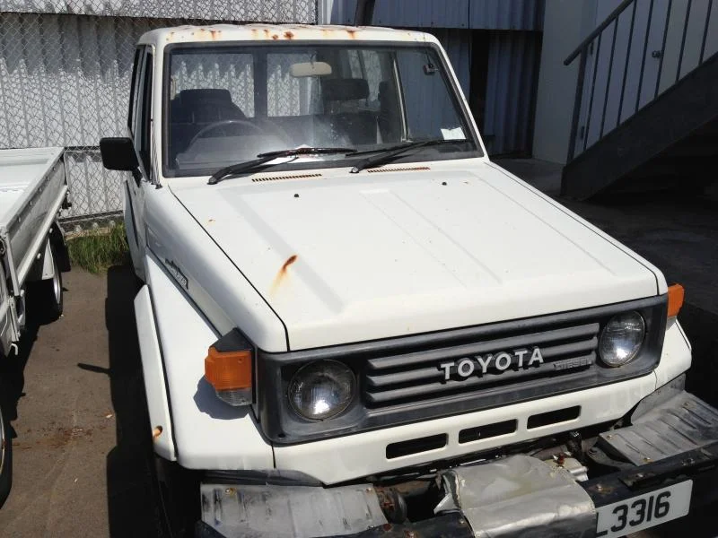

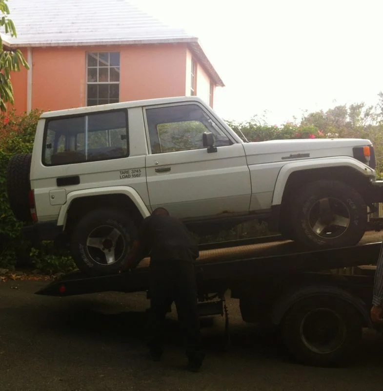

just bought this rare find a couple months ago for 4,500 us dollars, after hunting the scrap yards found everything to repair it. It sat in a yard for six years never touched, i shot some ether into the breather and fired up first crank...toyota makes an incredible vehicle
im looking for some toys to really make it mine...any one know where in the US or Canada i can get chrome grill, indicator housing, trim pieces etc?\
Good find. You can get the metal grill sandblasted and chromed,most of the used ones wont be looking all that great now.
the grill is actually plastic, i know what you are talking about though, My father has an 88 bj70 with the metal grills

I didnt notice it was a 93. The best place to get a chrome plastic grill is on aussie ebay.I think they go for $140
They were usually found on the HDJ78/79 but I think the South American and Middle East 7* series also had them.
A bit of advice,remove the fibreglass flares and check for rust.Also check for dirt/mud at the rear of the wheel arches
Is this one from Japan,it has that look?
Nice find ! It comes with the Aisan 1000 winch !
thanks for the flares advice... i already removed them and did find the red cancer that had grown happily for a few years...these pics are from a few months ago i have since cut out all the cancer, re welded the bottom halves of the doors, cut two sections of the frame and re welded in new steel, replaced all fuel, brake lines, rebuilt the clutch, front/rear diffs, suspension, and tomorrow morning the last thing to do is put the frond discs on the lathe and re cut them. i have to say i was amazed that the air-con fired up first try after new belt installed. the five cylinder engine is really smooth compare to the 4 cylinder i have in my bj 70. i see that they seem to be hard to find in the us but ob=ver here the 70 swb are still roaming the roads... all imported from japan
thanks for the advice on the grill... ill upload new pics as soon as i figure out how to up my file limit
