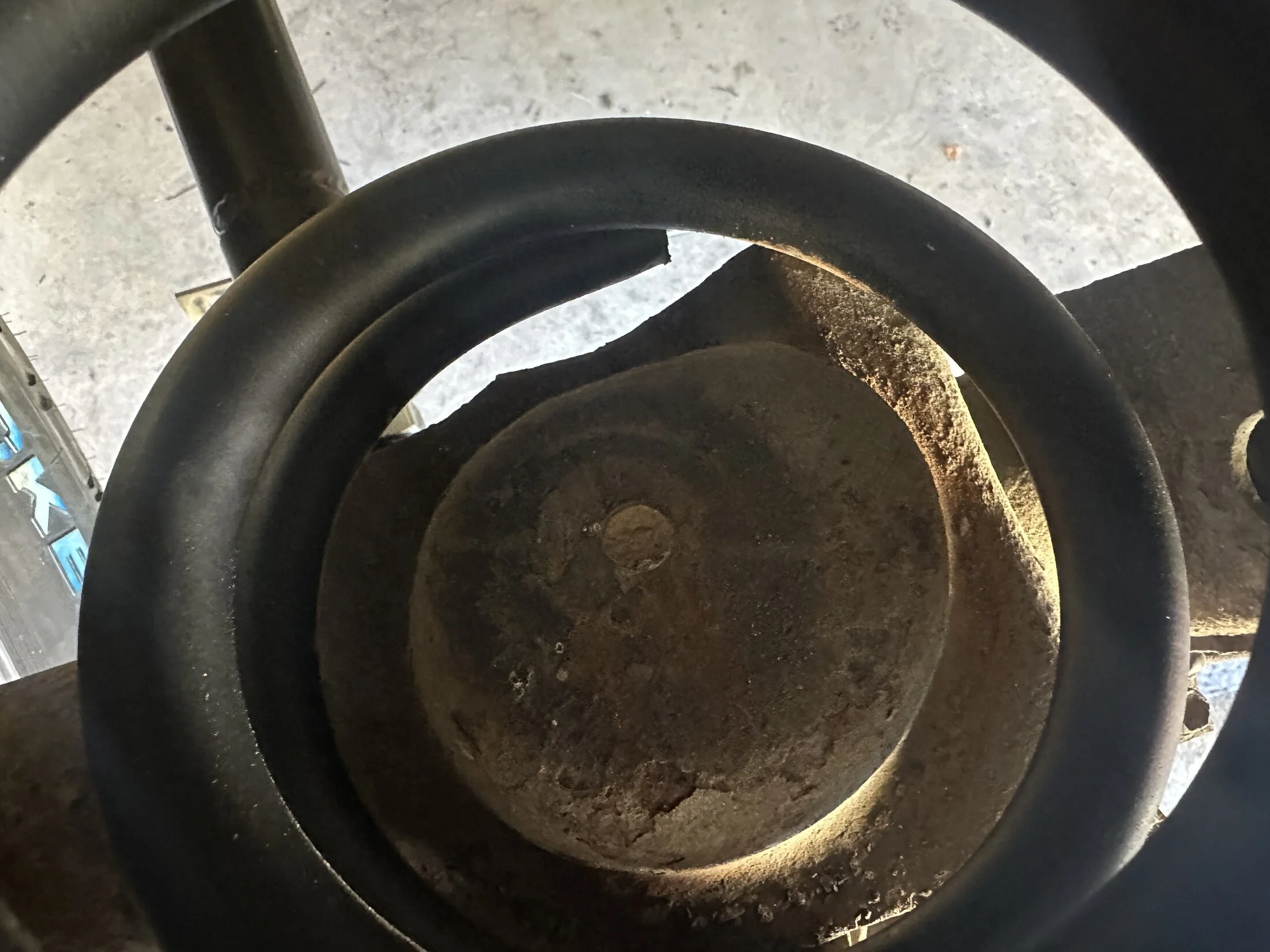

Hey guys, wrapping up an 80 build and we used the OME 3034 coils on the rear of this project. I noticed right away that they don’t really fit the coil pads on the axle. The factory rear springs were tapered down to a smaller radius at the bottom but these ones aren’t and they don’t fit the factory coil pads securely. What’s the fix for this? Is this just how the OME coils fit? If so it seems pretty cheesy. Thanks ahead of time for the responses.
I would start by getting the correct springs for the application.
ARB does not list the 3034 springs for the 80 Series.
Wow, that’s embarrassing but sure enough! That would explain why I was having such a hard time finding any info on this coil in the FJ80. I’ll call my supplier this morning and get it corrected. I’ll see myself out, thanks for the reply.

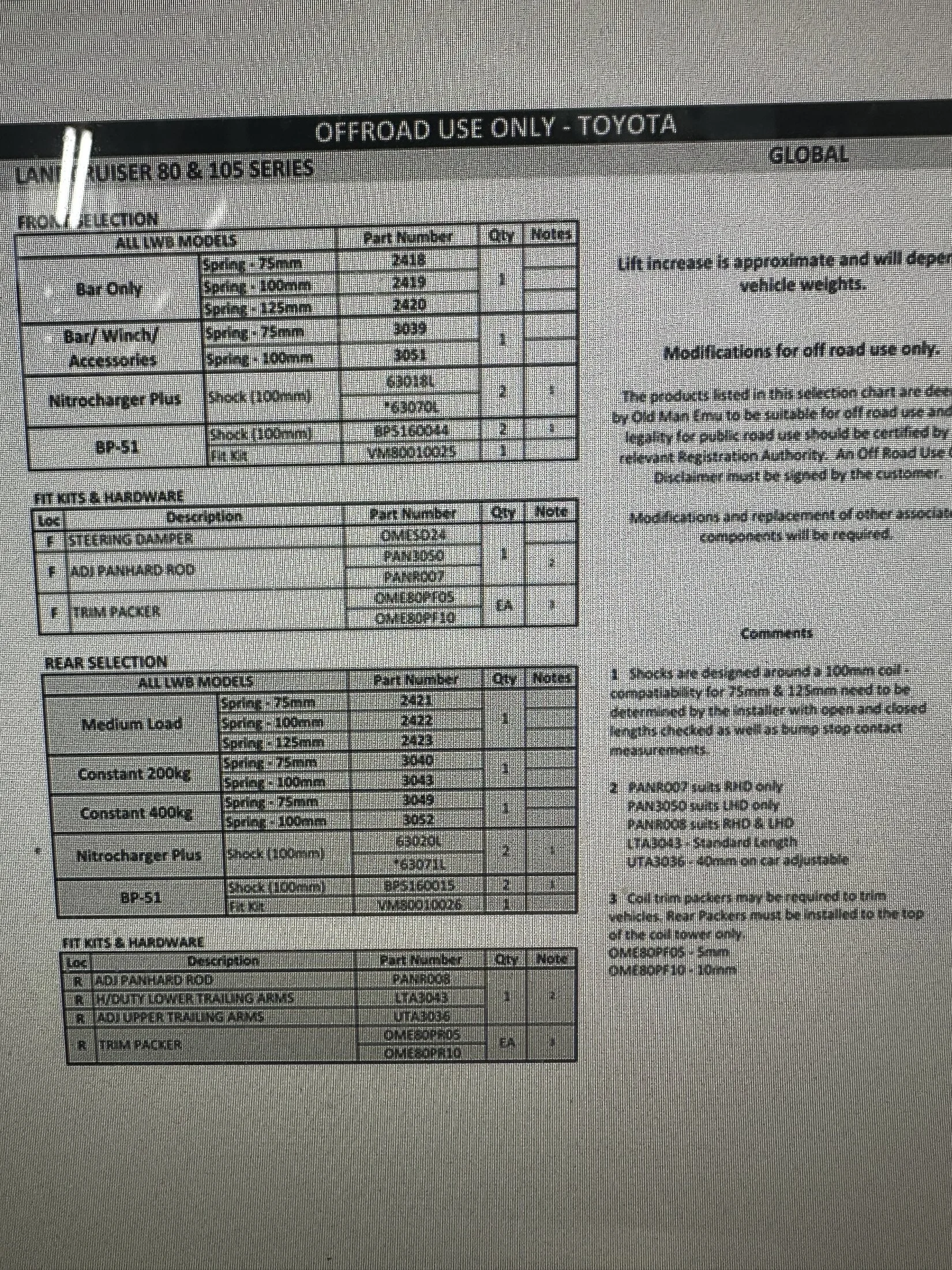

Thanks for the info! Attached is the guide ARB Wholesalers receive, these are the part numbers we are working off of.
You are looking at competition springs. They are taller and stiffer than even "J" springs. Here is a chart that lists all the OME part numbers.
Cruiser Outfitters - https://www.cruiseroutfitters.com/tech_OME_coils.html
Cruiser Outfitters would be a good choice for ordering your suspension.
The chart you attached from Cruiser Outfitters shows the 2418-2423 p/ns as the competition coils, we are using p/ns 3039 and 3040/3043 (depending on which rear suits the customers preference better) on this build. This chart makes it seem like the part numbers we are using are just the standard application coils for the 80.
