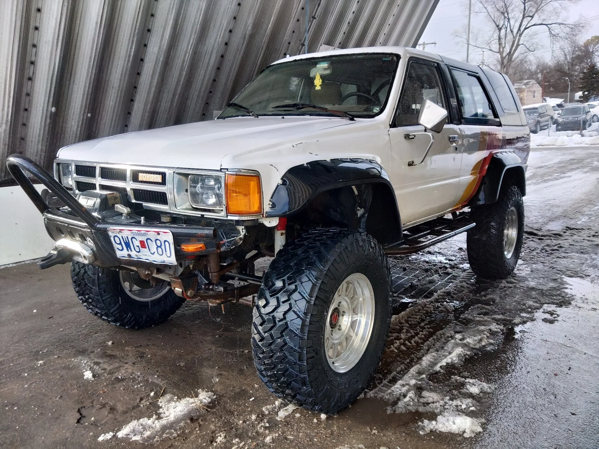

I figured I would give a long term update on the 2tr swap. I converted the pickup into a 1st gen 4runner and during the maiden voyage the fan hit the bottom of the radiator and causing it to dump all the coolant. I did not know that so I catastrophically overheated it and killed the engine that was in it. I replaced it with a 2tr-fe from a 2022 taco that only had 22k miles on it. I have now put another 22k miles on that engine and its going strong. I installed the secondary air injection pump, and the evap canister and it now runs perfectly with zero codes.
