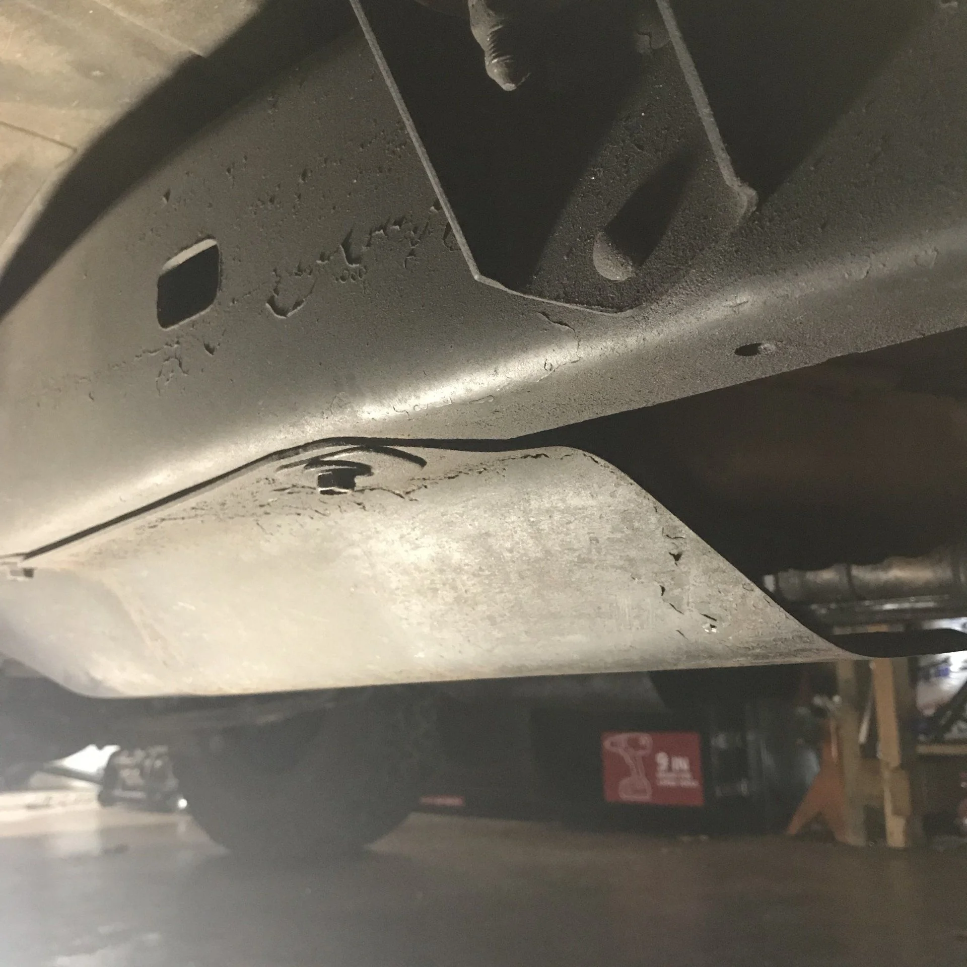

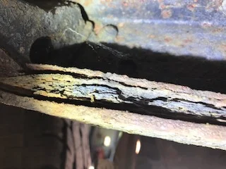

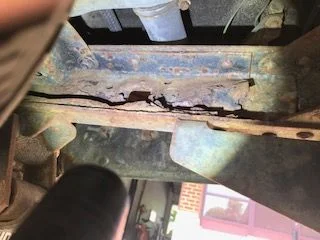

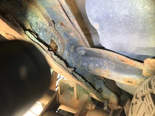

Hi all, I have been lurking for awhile, but new to posting. I have been shopping for an FJ62 for some time and finally came across one I wanted to move forward with. The catch is there is some interior frame rust on the rear end. I have taken it to a few shops in our area, and the responses I have received range from "don't buy it" to "no big deal." I wanted to see what others thoughts on the rust are since I have received such a range of responses. Pictures attached

Usually rust like that is indicative of other rust in places you might not expect.
That looks like delamination of the inner c channel reinforcing. The outer frame c channel looks to be in good shape. This is typical on these old cruisers. I think Trail Tailor sells replacements. If this is the only rust issue and the rest is fine, you should be ok. How is the shock tower support?
Agreed on both above. I personally find tackling rust like this a beat down, and honestly beyond my skills and set of tools to do properly. You will surely have plenty of other ways to spend money on a cruiser without having to fix rust issues. As @ceylonfj40nut points out, very common on these rigs and parts to fix are available. I'll second that the rust you can see could pale in comparison to the rust you can't.
I have always thought there are enough rust free examples of these rigs available (at least around my area) as to not bother myself with rust issues. But if the price is right, it might be a steal for you, especially if doing the work yourself. You would be doing the world a service by saving another 60 series and would have my gratitude. Of the possible rust related problems on these, I think this is one I would be the least worried about. I wouldn't underestimate the strength of that steel if cutting that old stuff out yourself though. Its stout back there. Burned up three drill bits trying to drill a single hole when installing a hitch. To me this really comes down to asking price.

Thanks! Asking price is $12.5K (obviously negotiable). The rest of the truck is in really good shape. There is some rust on the rear quarter panel, but that seemed like a more straight forward fix. Shock tower looks pretty good, but I will post a picture shortly. I have had it checked by a few shops. The frame rust seems to be the biggest issue at the moment.

While you could drive that around as is, not repairing it isn’t a realistic option. Right now that is a c channel replacement job. Wait on it, and it will turn into frame rail repairs as well.
