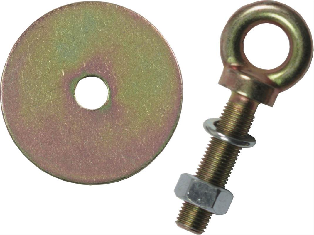

I also needed a place for my 4 year old to sit. In this pic you can see both the amazon mat I ordered and cut to size and the eye rings I used for mounts for her car seat.
