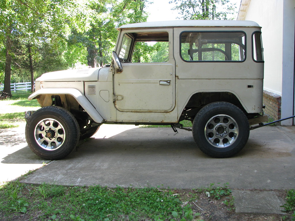

I'm wussing out...at least to start. I'm starting off staying spring under while doing the FJ60 axle and leaf spring swap. I am still gonna move the axle back like I had planned to do with the SOA. I just think the thing needs to have a lower center of gravity until my daughter gets plenty of seat time.

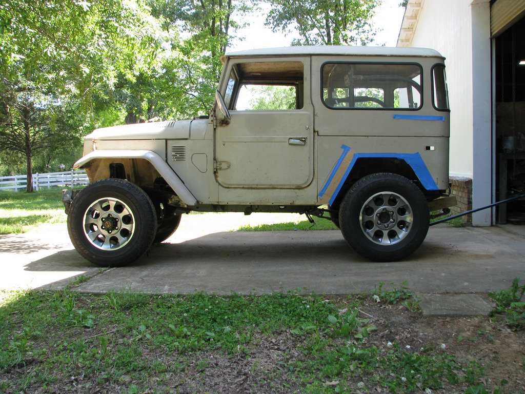

Here it is with the wheel opening relocated with cardboard and tape.

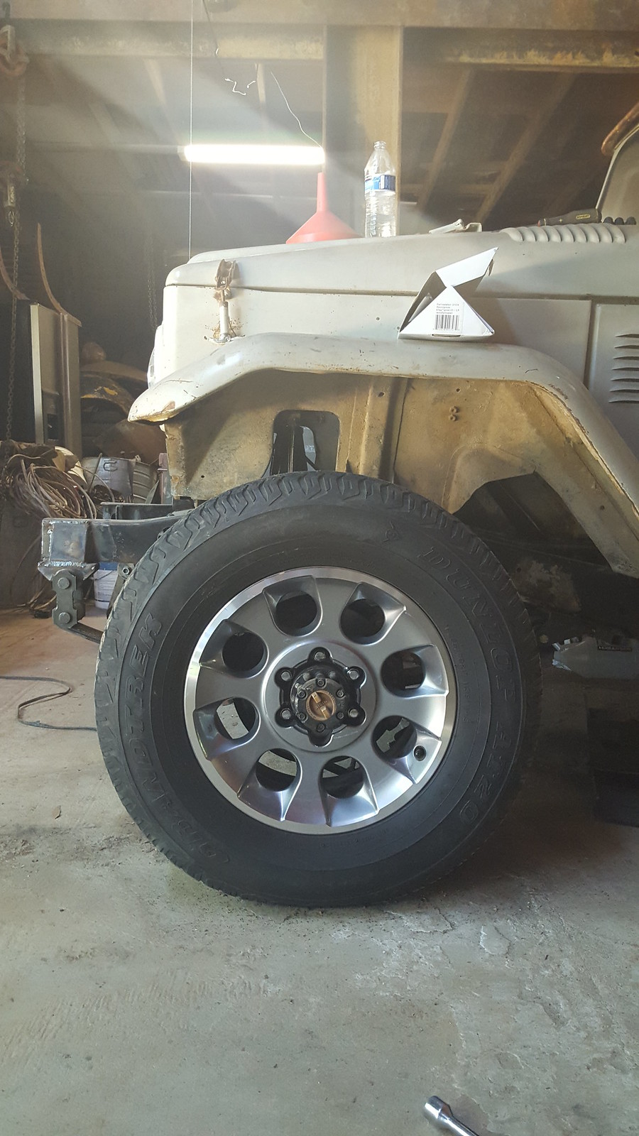

Wheels and tires came off of craigslist. FJ Cruiser 17's. I need to buy spacers because they rub on the passenger side drag link end.

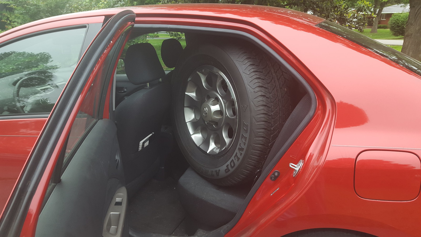

Did you know a set of 5 will fit in a Toyota Yaris?

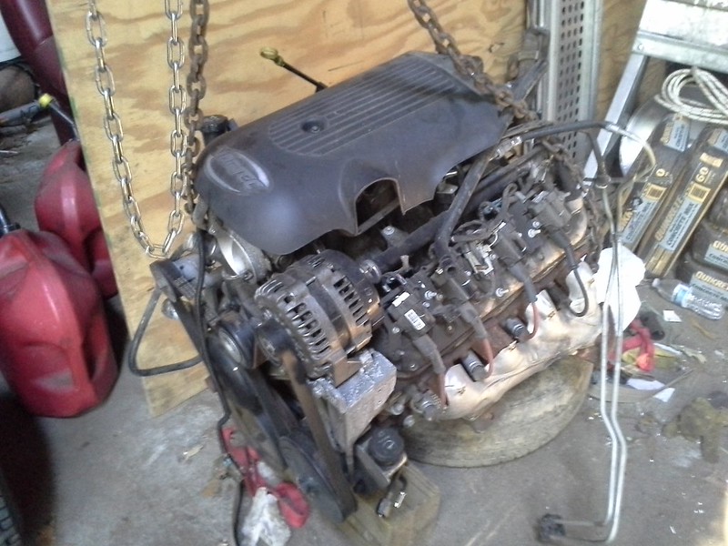

Anybody done a chevy ls motor swap on a stock-ish height fj40 using the chevy truck oil pan? Does everyting clear (I'm using fj60 4 speed and split case)?
Any rear sumpt oil pan is ok, only clearance issue is when the engine goes too far forward, puts the front harmonic balancer right over the front diff, right at the banjo housing. Plus prevents you from using a stock Chevy fuel pump (old school) for the same reason.

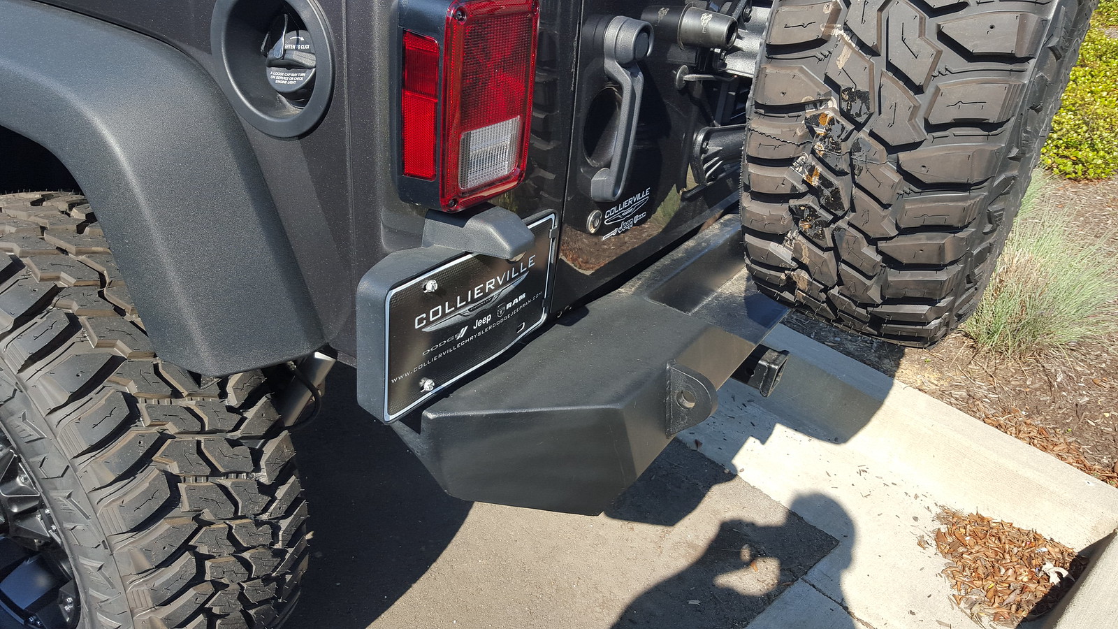

I bought a set of used TJ fender flares off of craigslist. I think I am going to mock them up on the quarter panel and see how much forward I need to bring the rear axle to be centered in the opening. Right now the fixed end hangers are just tacked on.
