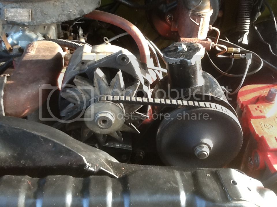

Mount for my second alternator, it used to be built above the smog pump holes. Now I've got it next to them, so the hood won't hit it. Not as much belt contact now. A bigger pulley will give more contact, but I put this on so it will spin faster and make more power at lower RPMs. Will have to test it to see if it's enough contact to drive it under load.

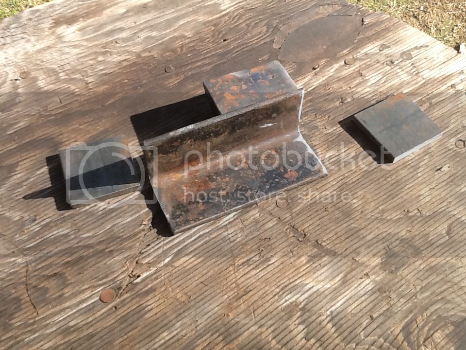

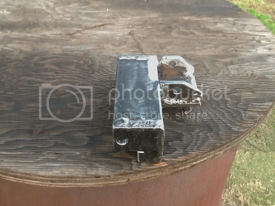

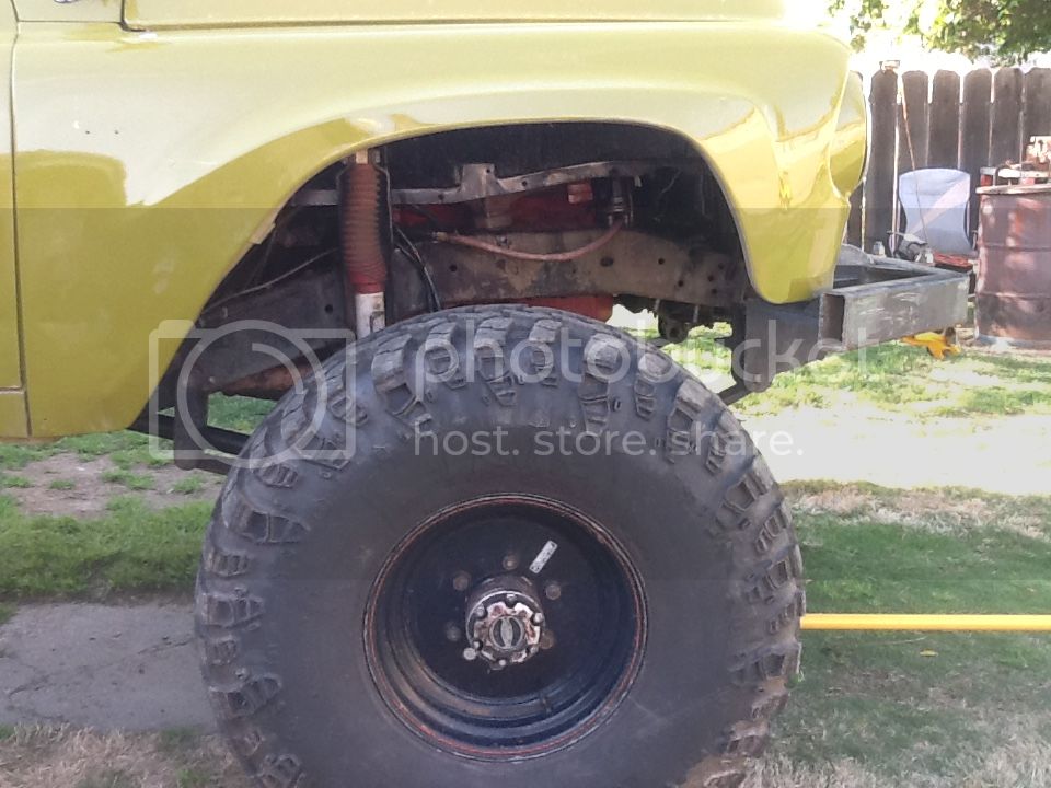

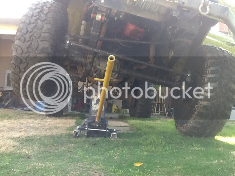

I wanted to look at doing bump stops before IHWR. It's not lifted in this picture. I had the fenders trimmed before, and the wheel would go all the way into the wheel well and rub paint off the firewall. This over flexing would break leaf springs occasionally too, so this might solve a couple problems.

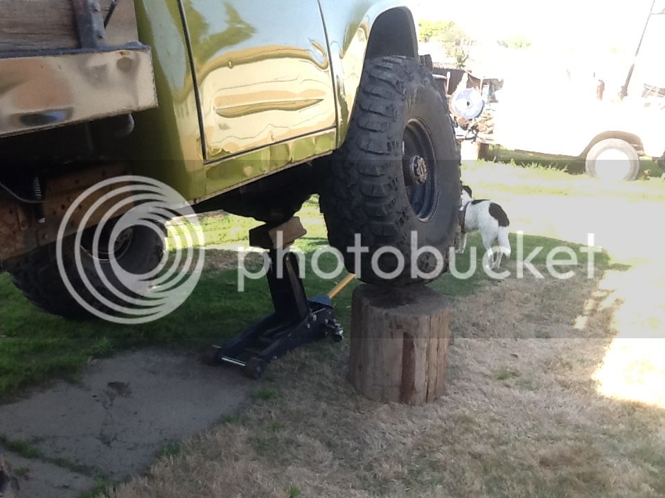

Lifted without a block on the Jack.

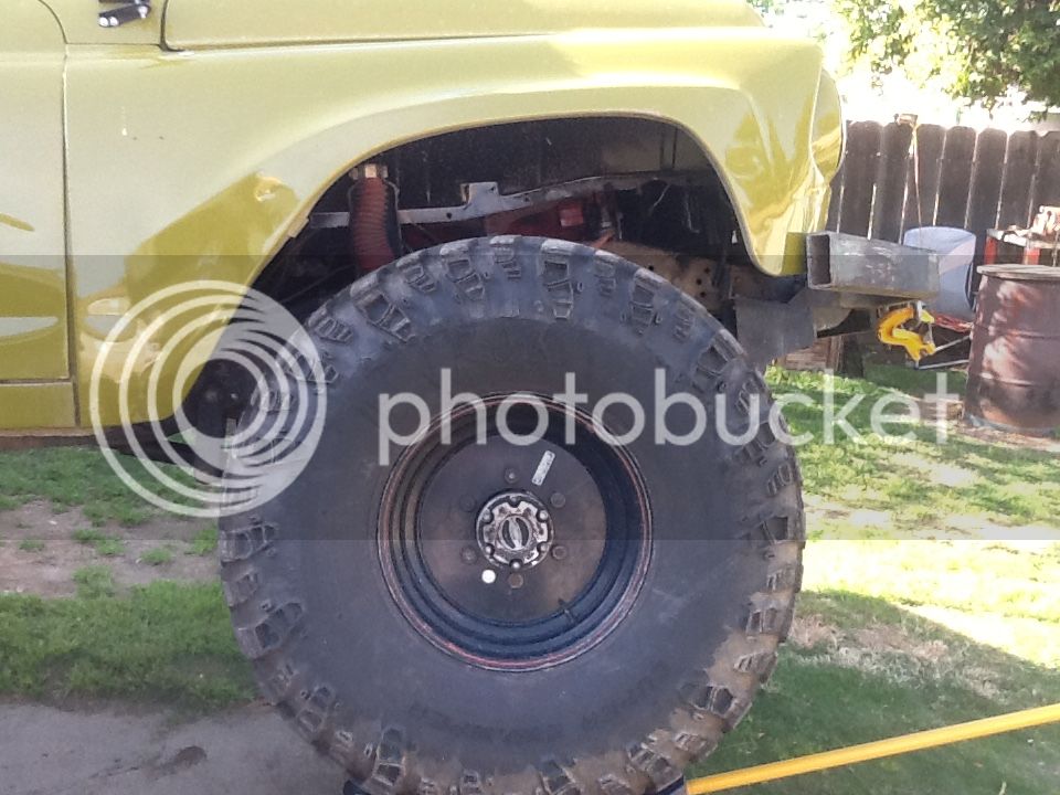

With a block. The log is 17-1/2" tall, and the tire is a few inches above it.
I still want it closer before building the bump stop, I don't know how I would get it any higher safely. My son and I are going camping in an area that has big rocks. We can take the truck instead of the Travelall, and use a rock to set it. Then take a measurement.
