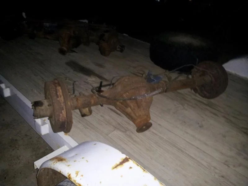

Mace, hows it goning man? You ever put that fj60 rear end from Denver to use? I like what you're doing with the little Scout. I have been an international guy since before I was even born and have had several of them, including the famed 1980 factory Nissan turbo diesel complete with close ratio t18 transmission and Dana 300 t-case. It was a slow dog that started way too hard. I will be following your post's. I think a little v-6 with overdrive will be a nice addition to bring the old girl into the 20th century. If you need some rare part I might have one laying around or at least know where to get one. Lovin that strange top. Might consider running a centered Dana 44 and a factory chevy t-case to keep cost's down ie no adapter plate required.
What's up amigo, that rear 60 axle is under a 40 tub that will be turned into a trail trailer. But that's another project :D
I got a set of HZJ75 axles to stuff under this rig. I was contemplating keeping the D18, but I think a cruiser split tcase will be much better off in the long run. Much quieter and stronger.

I'm playing with scouts and ram cummins these days.Trying to decide what to re-power my 79 196 4 banger scout 2 that I got from my grandmother with. Maybe an LS motor or a 4bt perhaps a 266 that I already have???? That 40 trailer will be sweet. I smell what you're stepping in with 700r4 and an adapter, shoot if you already got some decent axles.... Have you started messing with suspension yet? BTW diggin that floater in the rear.
Rear suspension is going to be 57" chevies sprung under. Front will be 80 series radius arms and coilovers. Gotta bring this truck at least into the 90's lol..
