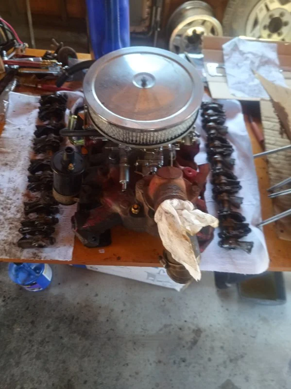

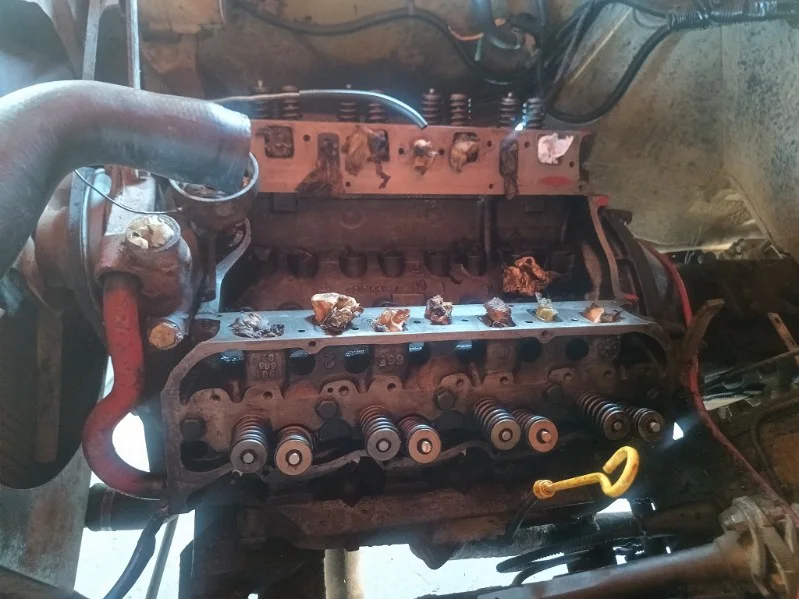

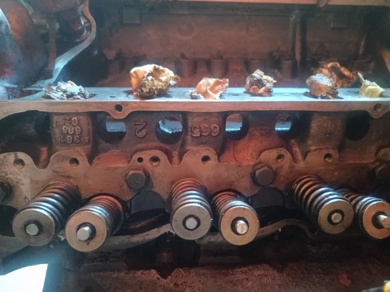

Boy howdy that went sideways! My plan for the day was to diagnose what I thought was a timing issue causing a lack of power, including the possibility of rebuilding the distributor. My friend stopped by to help and has much more of an ear for old American V8's than I have (I have none...). He poked, felt, and listened to it for a bit and then recommended we pull the valve covers. In retrospect I should have done this awhile ago...

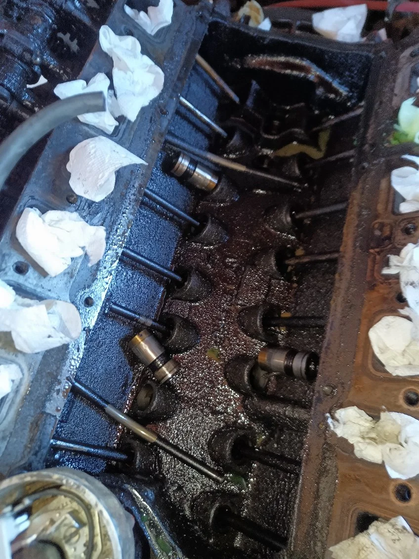

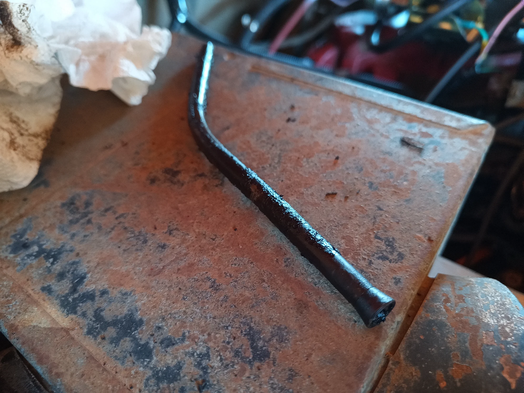

4 bent push rods with 3 ejected valve lifters, and a ton of sludge. Corresponding valves and/or lifters were stuck. I think this led to the bent pushrods. I'm pretty sure the 304 is non-interference so I don't suspect bent valves, but that could be wishful thinking. Some Kroil, a block of wood and a BFH seems to be slowly unsticking the valves.

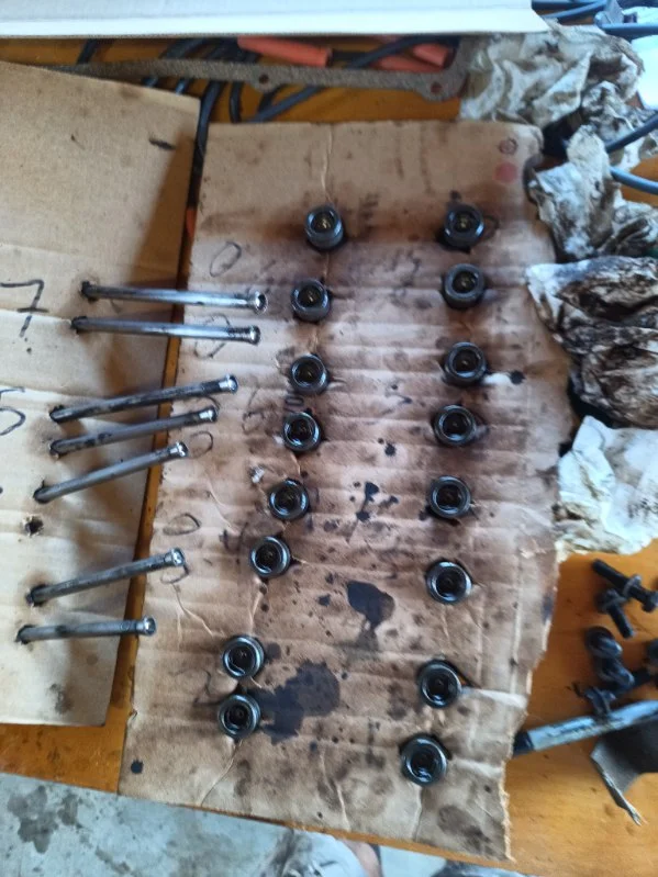

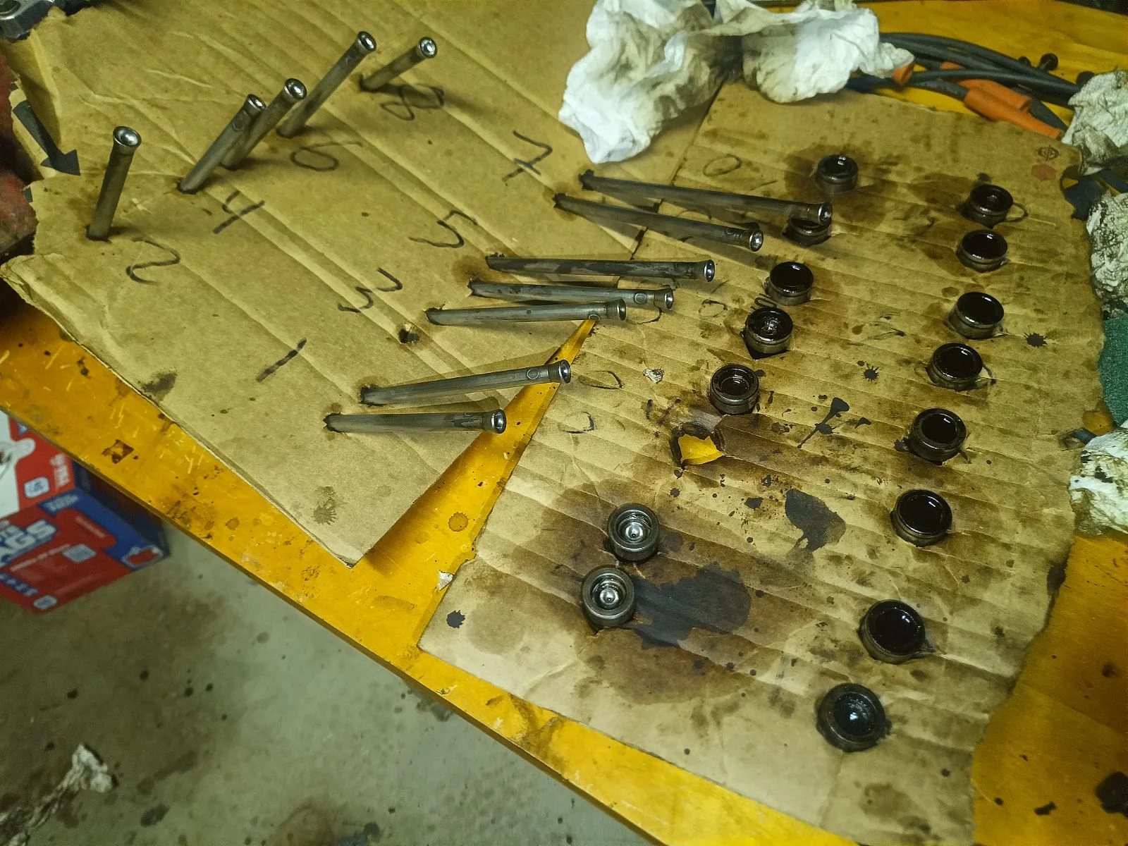

I removed all of the lifters and pushrods. I plan to disassemble each lifter and give it a thorough inspection and cleaning, hopefully unsticking the stuck ones in the process. New pushrods are available still. I am also going to disassemble and clean the rocker assemblies, and give the top of the heads and the block valley a good scrub.

Yikes. None of the cam lobes or lifters got wiped out?
Some of the lifters have some wear (concave on the cam lobe touching surface), but no burrs, grooves or other noticeable damage. If I can get the sticky ones apart, cleaned and moving internally, I'll reuse them. However, like the pushrods, new lifters are also available. I haven't felt the cam lobes yet, but given that the lifters seem OK and none of the loose pushrods made their way into the lifter holes to touch the cam, I think (hope!) the cam is OK. I'll find out tomorrow!

Clean up all the sludge in all of that with rinsing kerosene or diesel fuel through all of it, but do not run the engine with the kerosene in it.
A fair amount of that sludge is lead from the fuels and oils of the past. I had to use a putty knife to clean out all the goo under the intake manifold on my Studebaker.
Disassemble the lifters to clean and relube them. Make sure they are not sticky. Install new push rods.

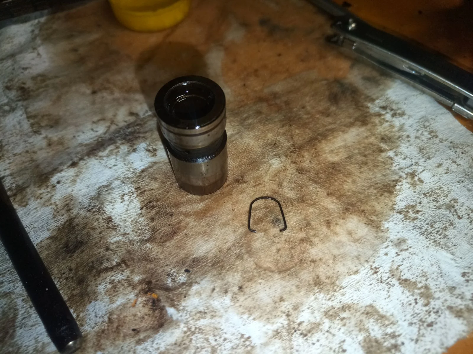

I got two lifters cleaned and reassembled and moving freely, and one of them was a stuck one. Reassembly is easy until it's time to put the spring clip in. The first one went flying...
...are these a somewhat generic part? I can buy whole lifters for $20 a pop, but that's kinda pricey just to harvest the spring clip from it...

What about an internal retaining ring?
I know I'm in the boonies, but I'm not that far from civilization. Or maybe I am?
Maybe? I say that with lots of hesitation because they're not designed with those initially and if it comes loose, now you have all those parts floating around inside there.......
If it was me, I'd spend $20 on a new one to rob the spring clip before I'd use a random Jesus clip not designed for it.

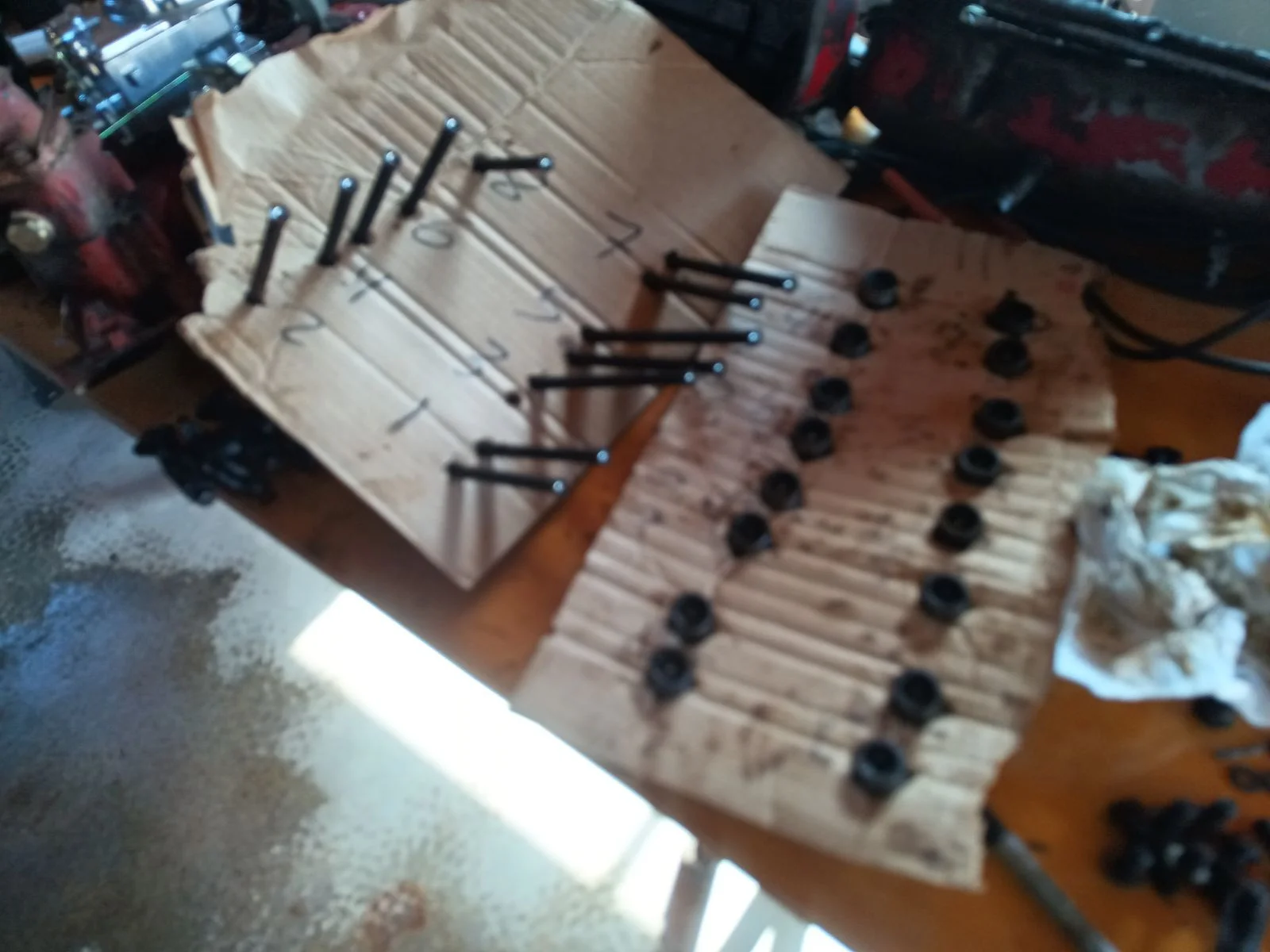

When I pulled the lifters, I arranged them all in the cardboard with that in mind.
I handed a spring clip to my friend with the dyno shop and he's going to see if he can find a matching one (or several just in case!) in his spares pile.

Struck out at the Dyno shop, two machine shops, and a carb shop, but a friend had a pile of stuck Ford lifters. The Ford clip fit darn near perfect!
Lifters done!

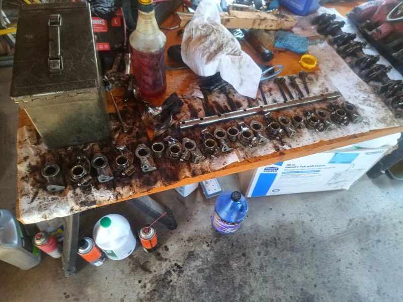

Up next was the rocker assemblies... @BILT4ME you weren't kidding! That was the nastiest sludge I've ever dealt with!
Rocker shafts had some wear, but all of the rockers move smoothly when reassembled with some oil.
