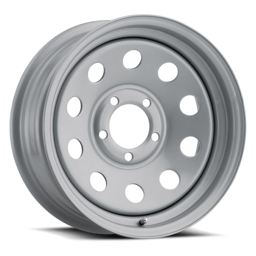

Not to hijack this entirely, but does anyone have suggestions for a 16" steel wheel that will fit a 1966 FJ45?
My new to me FJ45 came with white 15" 'wagon wheels' and nice looking BFG AT 31x10.5 tires, but the date code is either 1984 or 1994 (!). I have some 235/85 R16 BFG ATs from my Tacoma which I could use, but need 16" wheels. The City Racer ones look great, but a little too much $ for this truck.
Any reason I couldn't use something like these:
16x6" wheel with 6 on 5.5" bolt pattern, 3.5" backspacing and 108mm bore. They seem to meet the specifications and are cheap.
These very similar wheels were suggested in another thread, but don't seem to be in stock anywhere:
I don’t see any way the trailer wheels will have a bore that fits over 4X series hubs. It’s tough to guarantee many OE Toyota steel wheels will have a center bore large enough.
The bore ( I assume that is what they mean by 'pilot diameter') on the Dexstar/etrailer wheels is 4.27" = 108mm. My Warn M47 oil can hubs measure at 105mm diameter, so it should just clear. My current wheels also appear to be 108mm bore, is that some sort of standard?
Anyone know what the bore is on the stock wheels?
