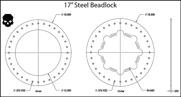

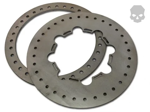

So I found some weld on beadlocks and they are pretty cool...I'm thinking that could be a good route to go.

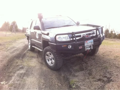

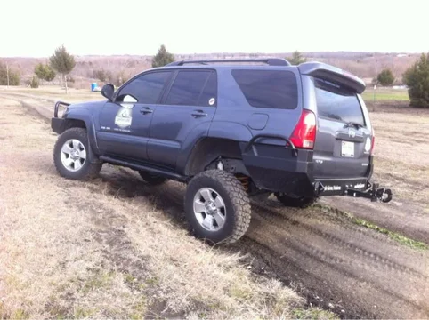

Your 4Runner looks good and I think your tire size is right. I might be biased because mine looks almost the same, minus the bumpers.
What beadlocks are you thinking?
