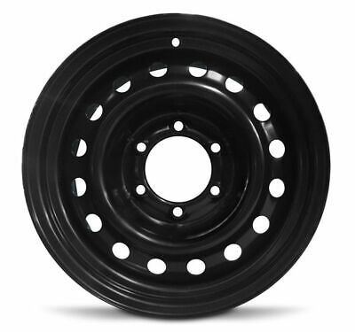

I know you posted this years ago, but I'm thinking about buying these wheels for my '02 Land Cruiser. It seems like Toyota still carries these. Do you know if these would fit without issue?
Thanks,
Z
C'mon, guys! There are so many posts regarding 16s!
OEM 16x6 These fit perfectly. Plus, they look stock.
PN: 42601-60262-03
If you want the "NATO" Wolf style, you can get the Tundra/Tacoma/Sequoia steel wheels. 16x7
Offset is not ideal but they fit.

Try 42611-60A61. Though that PN might be a 17” rim. You’ll need to double check with a region-specific parts professional... most likely GCC.
Stumbled upon these... Do you know if these would fit an '02 LC?
