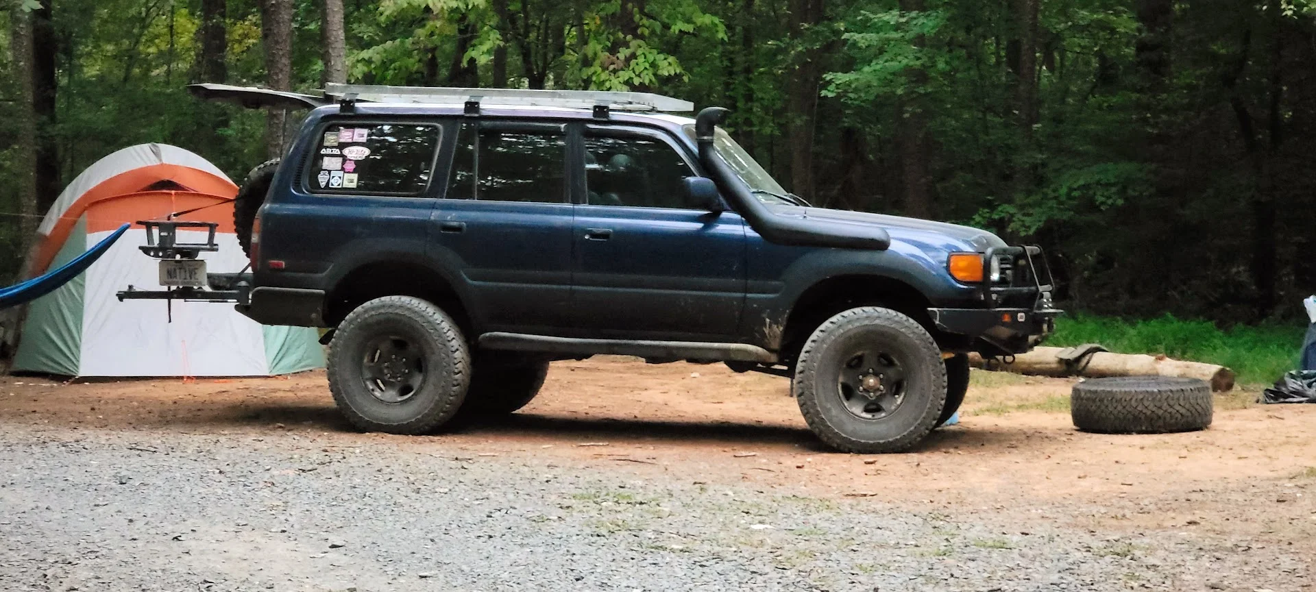

Switched to Braid Winrace Ts + 315/70r17 Kumho At52.
Sure 315/75r16 look better on factory wheels but seems those days are numbered.
Bad pic but you get the idea
