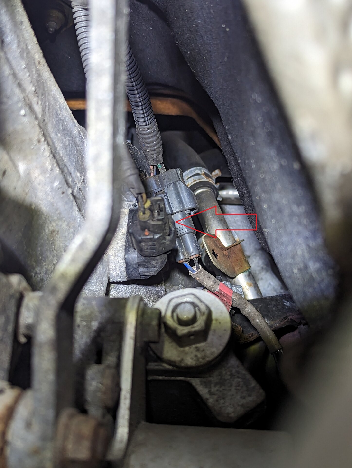

So I was able to fix this on Friday. As expected, the parts diagram is correct - there are two sensors on the passenger (right) side of the transmission. One is at the rear of the trans directly above an exhaust O2 sensor, the other is near the front of the transmission behind the shift linkage.
I was lucky, and the rear sensor was bad on mine - it's far easier to get to.
I'm posting this info / pictures to help anyone who has this issue in the future.
I'm posting this info / pictures to help anyone who has this issue in the future.View attachment 3248141View attachment 3248142
So you just popped the old sensor out and replaced it with new?
Thanks for posting follow up. Good tech
I popped the old sensor out, replaced it with new, and cleared the code (I used the torque app, and a bluetooth OBD2 dongle - I didn't have to break out my old techstream laptop) - done!
