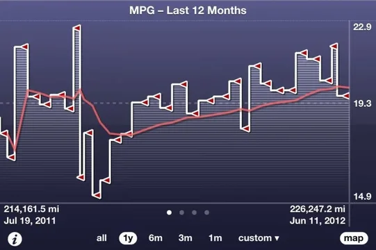

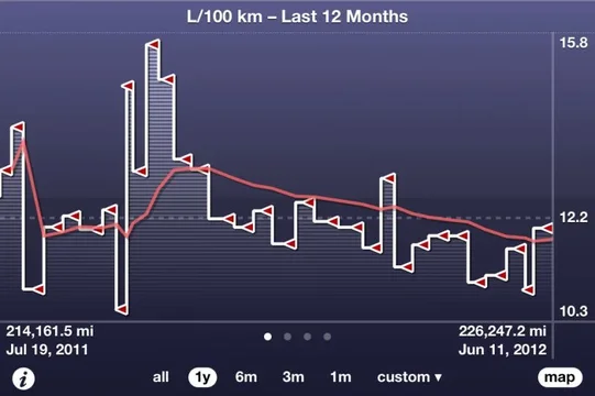

How about some graphs?
I've been recording my fuel consumption for several years now using an iPhone app called Road Trip. I record every fill-up and as a result have some pretty good data.
My '62 with a 12HT:
33" BFG A/T
Full length roof rack
2.5" OME
15lb boost and fuel at stock setting.
H55F, 4.10 diff
70mph (112.6kph) = ~2550RPM my typical max hwy speed
Once in a while I'll toss in a quart of veggie oil and I think my consumption improves a little for tank or two.
These results are with mixed driving. The worst consumption, clearly seen, was from pulling a trailer on the highway.
Engine probably has 100k more than the graphs show. I just recorded my odometer reading (adjusted for the 33" tires, of course).
