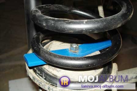

One of these works just fine.
Was thinking in something more permanent but not complicated .. like this
