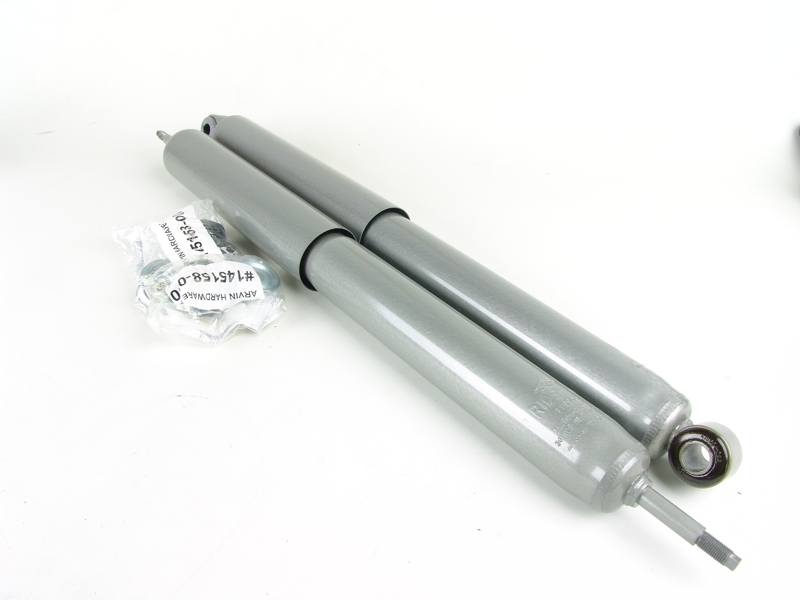

We have had these Ridepro shocks sitting on the shelf for a little bit and we decided to clear them out.
They are 11.5" travel.
See
https://forum.ih8mud.com/ih8mud-com...travel-80-series-shocks-bolt.html#post7141127
