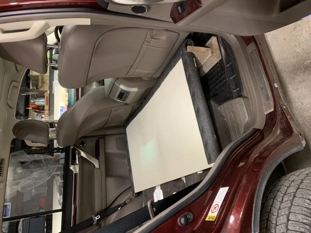

Removed bolts, unplugged seat heat and airbags, removed seats out the back, stuck 2.2 ohm resistors directly into the vehicle side airbag plug, put a piece of electrical tape over the plug to keep the diode from backing out and tucked them under the carpet. Started her up. No airbag light :cool:

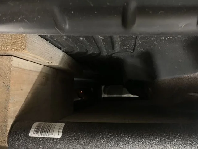

To level out the area I made a quick platform out of 2’x4’ plywood and a few sections of 2x6. Putting 2x6 pieces into a T makes it almost level with the lower sections preventing the playform from gouging the back of the front seats. Also gives you a little storage under the platform in the footwells.
Will do something more permanent if I like the set up. Dogs are happy with the extra space.
