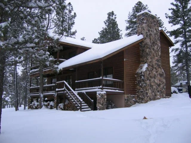

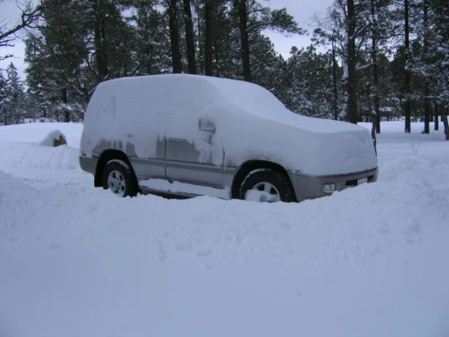

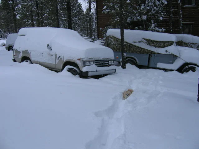

Here' a couple of non winter pictures from AZ :beer:
