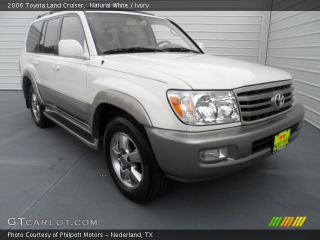

These sound like what I am after, could someone post a picture, we don't have much here in Australia to choose from, many thanks
