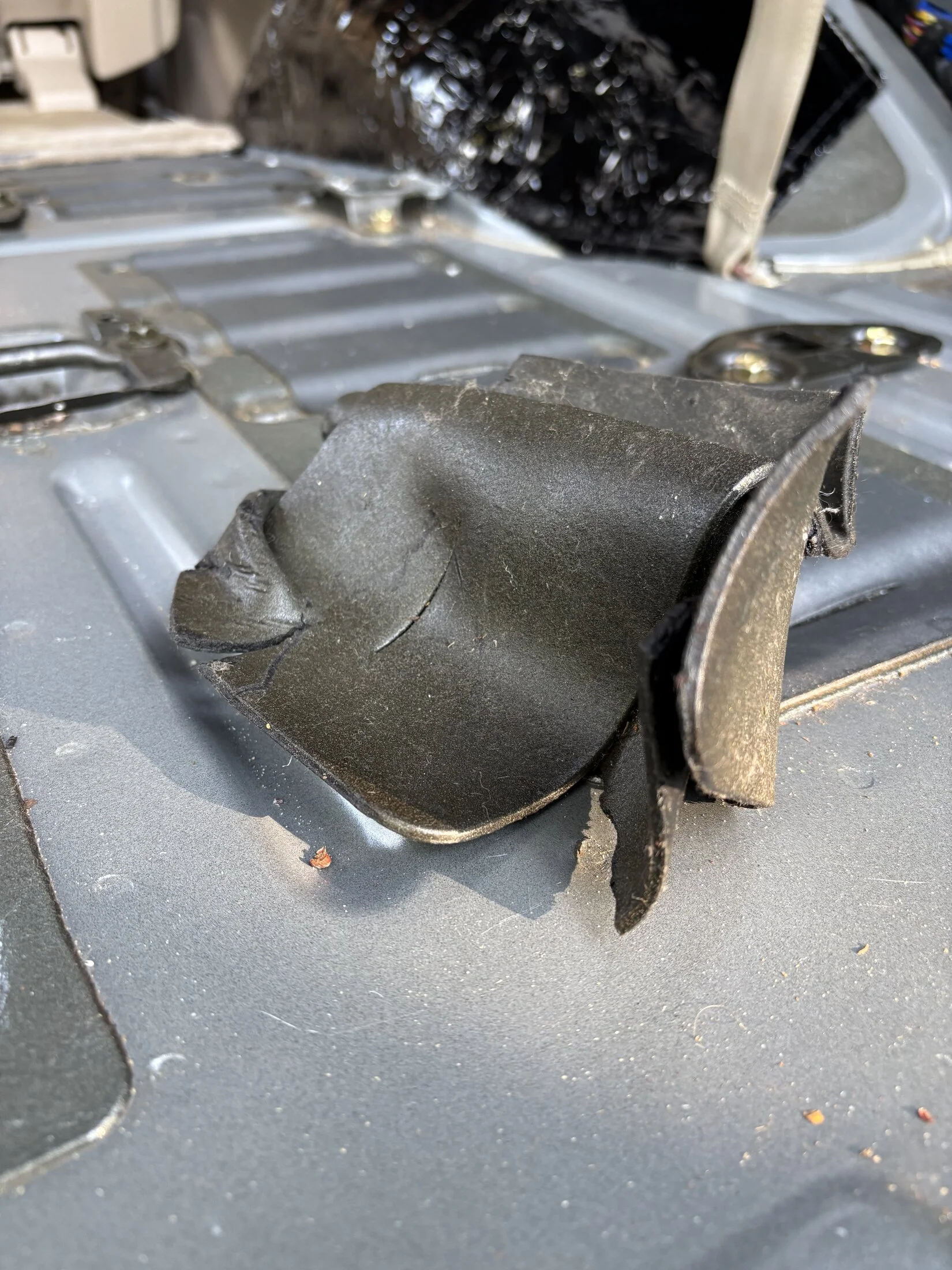

Revisiting this thread as I tear apart my rear cargo area this weekend looking for a rattle/vibration that has been driving me crazy. Turns out that the factory CLD on the passenger rear quarter panel failed and was in a heap, and occasionally would find just the right position to vibrate on the un-deadened sheet metal. Should have it buttoned up again tomorrow after new CLD, Fibermat, and Thinsulite where I can fit it. [ edit - turns out that was not the only noise! Still tracking down another… ]

That’ the thing with making it quieter, and solving “the g’damn noise”… you will now just hear the next loudest noise… on and on… but the end results are so much better than where you started.

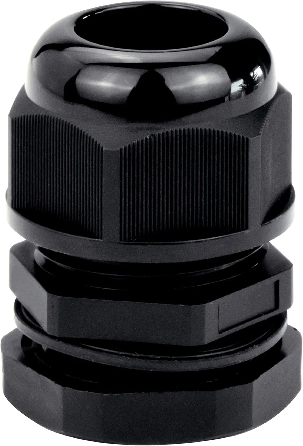

Say, does anyone need nice firewall grommets? I bought 2... but didn't see it was a 5-count per bag... so now I have 10! Okay, I used 2, so I have 8. For 0/1 gauge, black. They seem nice, tighten down to waterproof seal. Just pay shipping and I'll send them.

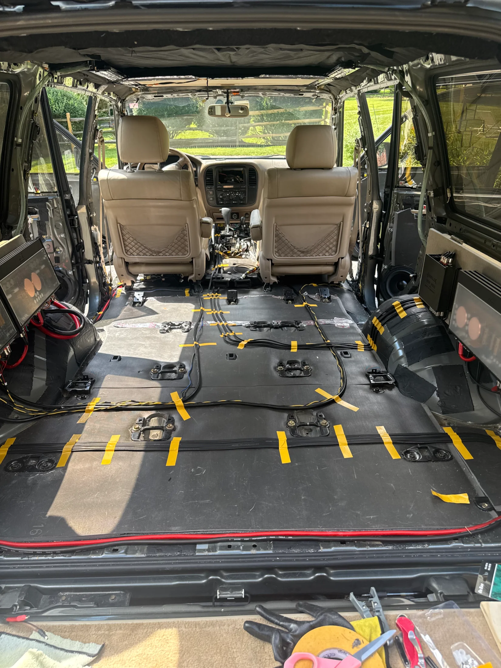

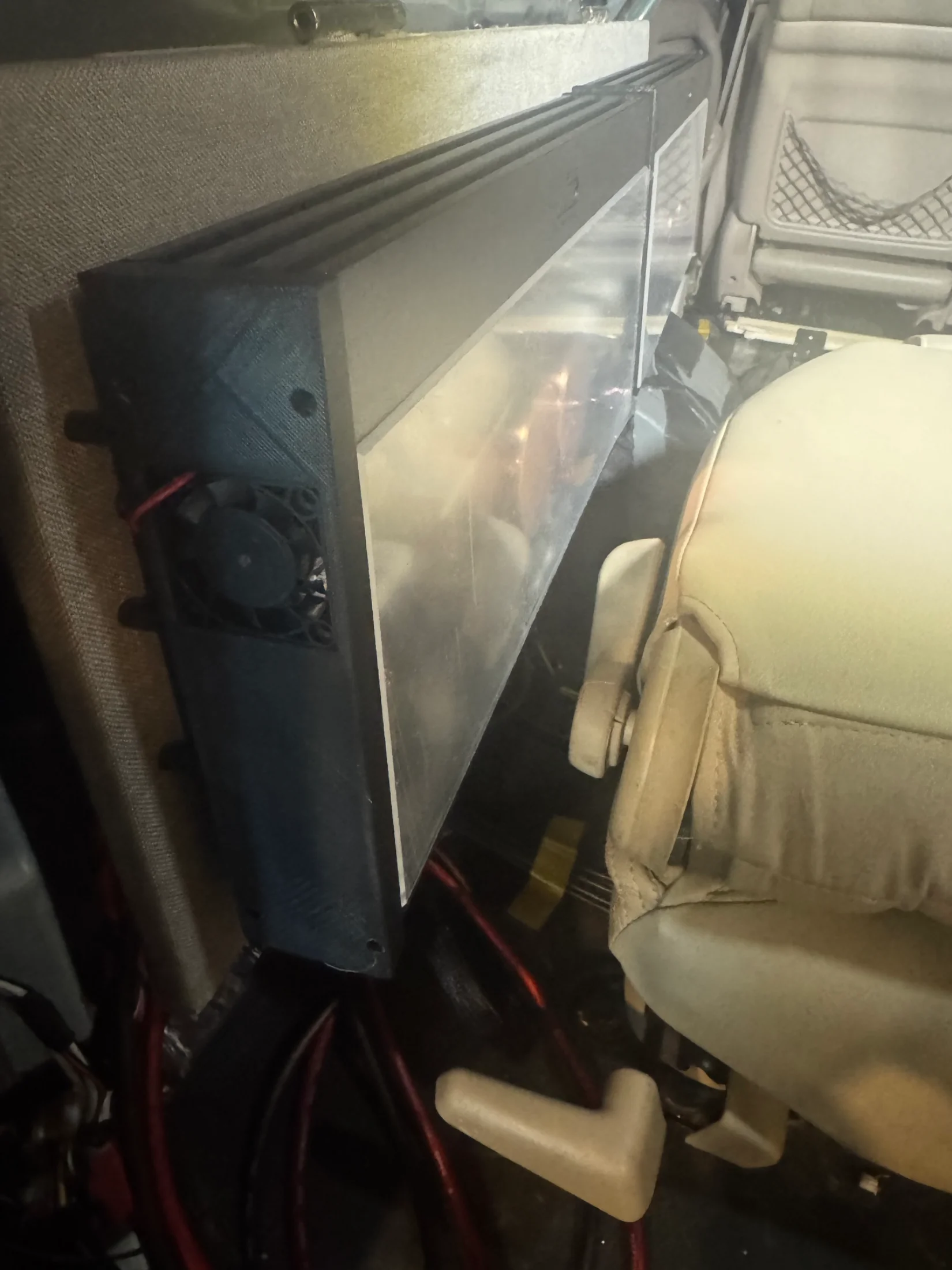

Sometimes in projects you fail to see the cumulative effects of small decisions until they add up to something. I realized Saturday that my earlier decisions made it so my rear seats won’t fit back in, if I finished the build as is!
First, I bought previously owned but unused amps of the brand I wanted, but of higher wattage for less over on DIYMA… great ! But realized after receiving they each are.1.5” bigger. That 3” made me too long to fit behind 2nd row seatbelts and where the rear curves back in by liftgate… so I had to pull them out toward the center to get more room. Then my amp rack got deeper, as I wanted it hinged to get to all wiring behind. Finally, I used spacers to run wires under amp and keep hidden. Total? Blocks seats!
Last night I had to pull most of the wiring out to plan a new build. Looks like I willl be using under seat area, which had intentionally left empty. Real pain is I used the Resonix cut-to-length rca cables…. which were easy to use and quality… we’ll have to see if I can repurpose wires or if I am screwed. I think it will still workout. Fingers crossed.
I know many of you have been here (but maybe not as many hours invested before you saw the problem) in projects… audio or mechanical… little decisions are still decisions that can impact the whole, make them carefully!
Bummer! But that’s going to be a sweet setup.

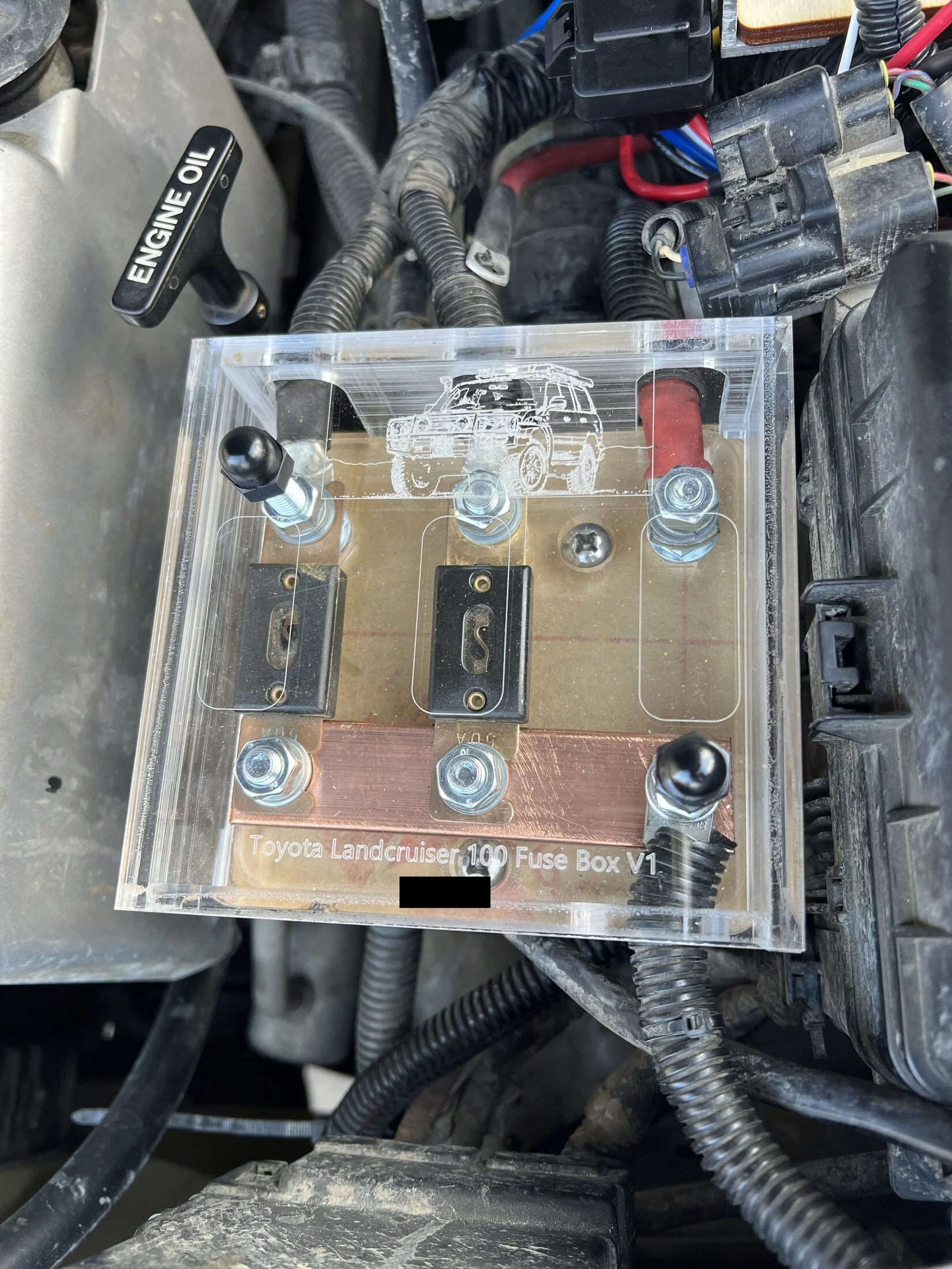

This is my build from a few years ago. I've since built a new sub cabinet for 2 x 12" BA subwoofers, Swaped the alpine 500 for a Kicker 800 watt sub amp, and rockford Punch 600.4 for the mid ranges. Also laser cut a new fuse holder, no more rotting plywood. Still sounds good and turning up the subs is a nice party trick. Would like to get a nicer amp for the midranges eventually.View attachment 3859452

@Njck22 , you said this fuse panel was custom made? Could more be manufactured or was this a one off? I'm still trying to find a solution to mount my winch power cut off switch which is currently ziptied and floating in that location .

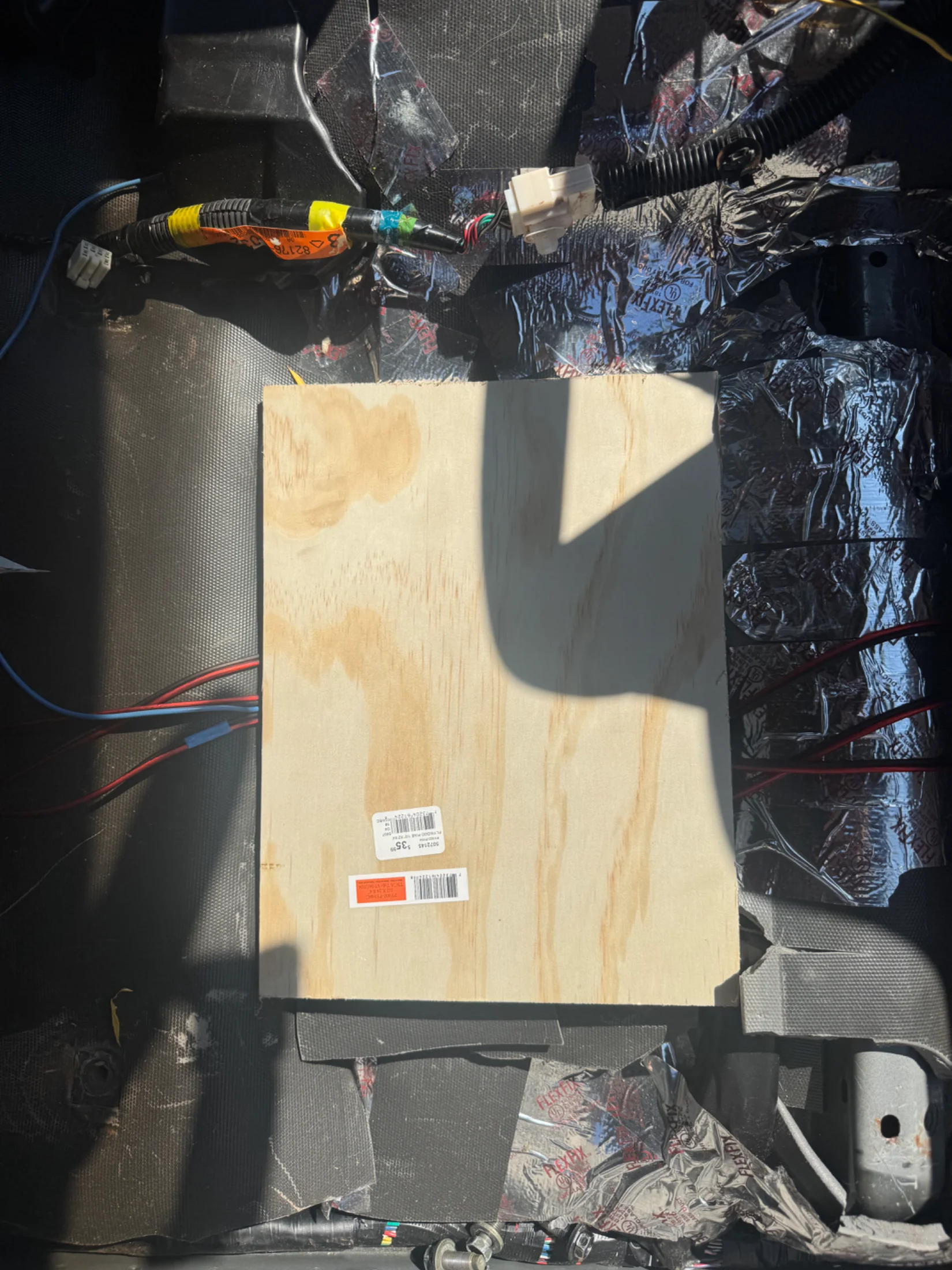

Both - for ventilation and wire management. I haven’t laid out my amp rack yet, but will be installing a Mosconi One 6|10 under the passenger seat. Dimensions are 12x8.25x2.25”, and wires come out of the short sides. It seems like it may be snug getting everything in, and i dont want to worry about damaging things if the seat moves.
I am also tracking that there is a stock ground point under the passenger seat, but haven’t seen this with pics and don’t have time to be taking my seat in and out frequently. Same with amp rack attachment points - I’m not sure where my best attachment points are yet, but I’m guessing it’s the stock amp locations. As I type this, I really do need to just get in there twice and be done with it ;)
Yes there is a ground point under passenger seat.
Board in pic below is 13x10 and seat bolts are 18x17.

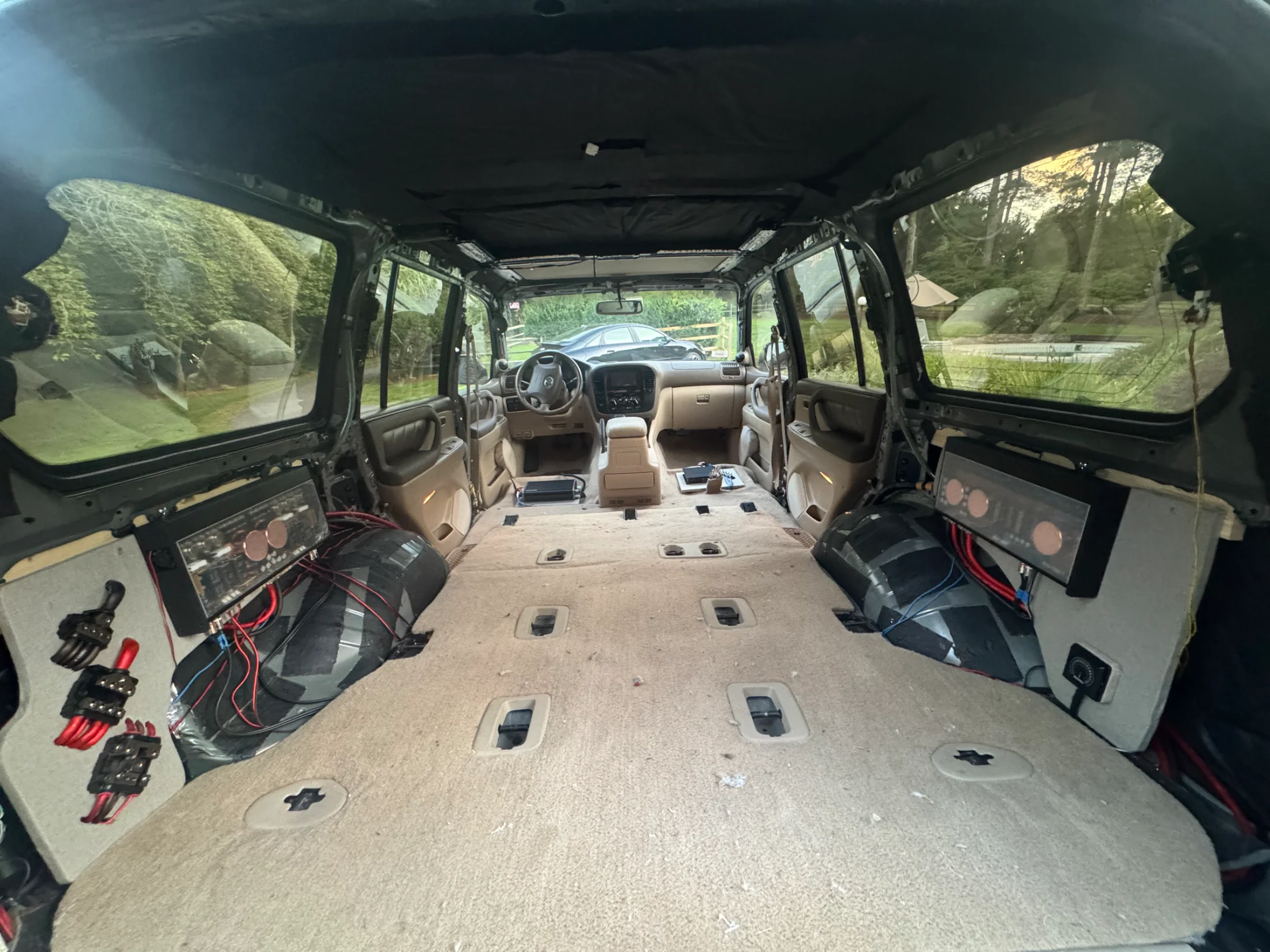

Okay, earned back all that I lost by having the 3rd row seat issue, and new carpet in… mostly. Seats in tomorrow, then starting to power up! Still have to set gains and dsp, which will take time, even for initial.
Had lots of sound deadening before, added more… and an absorption layer too. Deadened lots of plastic interior before going back in.
Do not have a plan for a sub yet.
