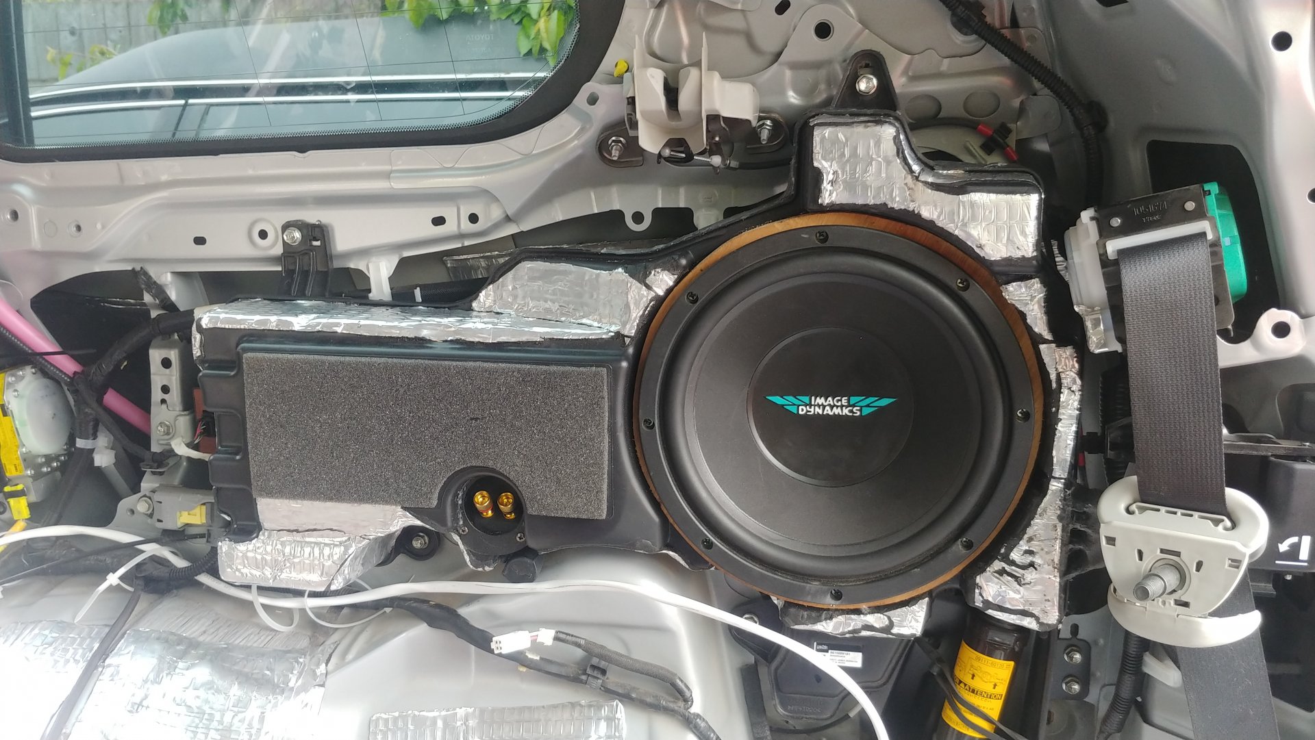

Took a chance and ordered the ML LX570 enclosure. It was only $150, tough to beat. Fortunately the 5.5" overall depth IDQ10 will fit perfectly, even with a small spacer. Could probably get away with 1/4", but will probably go with a 1/2" to be safe and leave plenty of extra room between the magnet and the interior wall of the cabinet. And I'll have an entire LC sub assembly, plus ML 10" driver for sale to make up the $150 spent! Score!

Just confirmed it worked out beautifully! Thanks again grinchy!

Nice flex putting in speaker terminal posts
Good eye ;)
Wired 4 ohm DVC's in parallel. Measuring 2.2 ohms (DC) between posts....should pull about 560W RMS out of my Gladen RC600. Sub is rated 500W RMS. 12awg OFC CL2 rated wire, gold plated binding posts, a dab of thread locker so terminals don't rattle loose.....should work beautifully.
Sub currently has no batting/fill inside. I'm going to test with/without fill and choose the one with better LF extension and reduced harmonics.
