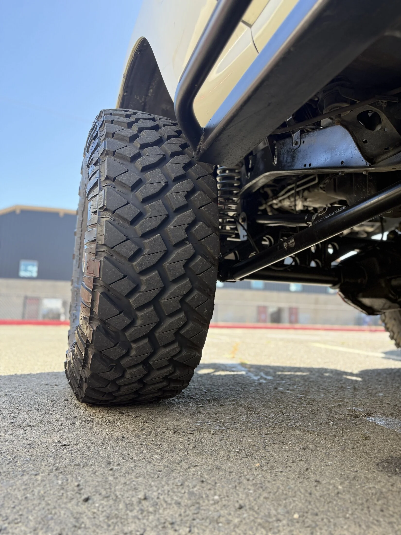

So this week I will be picking up my first 1996 LC80. In the past I have owned LC100 and LC200. Pretty stoked to get this new to me LC80 that’s built on 1 ton axles, and a million other cool mods.
First thing I need to sort is the brakes. With the 1 ton axles (Chevy front- Ford rear) and bigger brakes the brake master is undersized. The brake pedal goes almost all the way to the floor. So I’m looking for a master cylinder upgrade that can handle the extra capacity. I have searched the web but can’t seem to find anything. Help!
