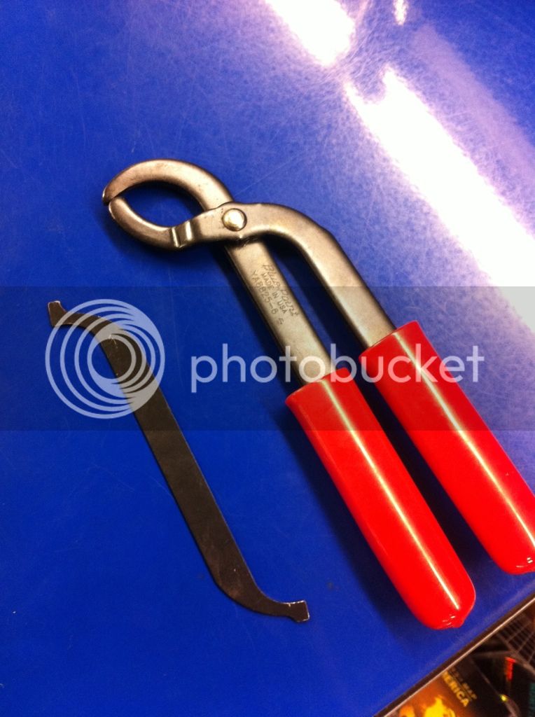

If you get a seal puller like the one below (should be common at any parts store) and cut off one of the hooks, it works great for getting the shims out. Hook under the cam shaft, and pry down on the bucket lifter, use a dental pick or something to pop the shim out. Way cheaper and easier than the SST. I used it on my 1HD-T and I think the 1HZ is the same...
Themorb:
That is genius, I have been thinking something like this would work but haven't been around truck to try sense I discovered valves were out.
Thanks!

Ya I tried the Snap-On one first, but it isn't thick enough to push down on the bucket... I guess the cam is farther up on the 1HD-T than other trucks.
