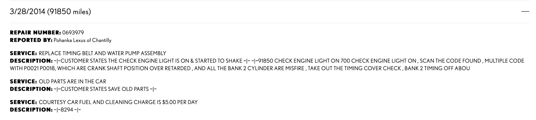

The good news is that it has overwhelmingly been serviced through Lexus, so there's a plethora of service history. After reviewing, the one entry that I'd appreciate feedback and insight on is the following codes, P0021 P0018:
I searched this forum and found a post that seemed more to do with the sensor, rather actual errors that this vehicle demonstrated (crank shaft position over retarded, bank 2 cylinder misfires). Clearly, you can see that the timing belt and water pump assembly were replaced.
My big question: Is this a red flag? Would seeing this message make any of you more knowledgeable forum goers steer clear? The car seemingly went on to have a healthy and overwhelming long life up to the current mileage of ~158k.

10 yr old diagnosis and another 60k on the odometer would lead me to believe that there is no underlying issue for you to deal with... I would ask the dealer to complete a baseline health check (fluids, filters, spark plugs, alignment, check for leaks and worn suspension components) make sure the frame is sound, exhaust is solid, all electricals work and it drives as it should... then go and give it a once over in person.
Hope it works out! Good luck!!!
What serviced were performed before that? I would want to work backward to see if anything else could have caused that…
Am I understanding that the belt and water pump were replaced to remedy the issue? Or this happened after the replacement?
Either way, you need to do the entire timing belt system service as its over due. Dont roll the dice on that amazing VVTi 2UZ.
