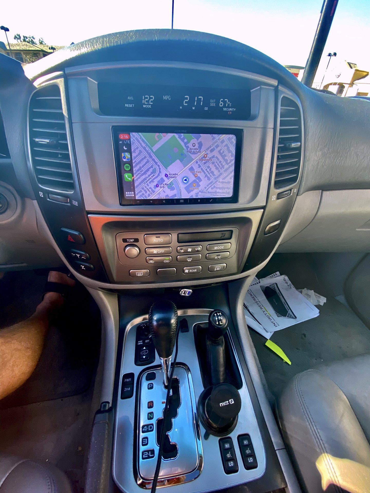

The difficulty in 03-07 US based LCs is the stereo is integrated with the nav system in the touch screen, so you can't change out the head unit directly. It's sort of a two step process where you first have to convert a nav equipped 100 (LC or LX) to a non-nav 100 by adding button style controls for your HVAC (parts sourced from outside the US where there were many non-nav 100s being sold), then you can add a head unit from a traditional manufacturer like Alpine, Pioneer, or Kenwood. Jerryb here on this forum is the authority figure on this and makes a harness that greatly simplifies the process.
I would trust this kind of conversion much more than a Tesla stye screen because at it's core, you're using established companies - standard double din head units and the same Toyota HVAC controls the rest of the world uses. I'd be much more comfortable with the long-term stability of that kind of system even though the Tesla screen looks really cool.

It's been well over a year since I bought all my parts so I don't remember for sure (plus I bought them over the course of maybe a year), but I seem to recall the conversion parts themselves were in the $1500 range plus the cost of the stereo system itself. There are a few of the parts that have become quite difficult to find and pricey. I've heard you can recover a good chunk of the conversion cost by selling off the touch screen and some other parts, but I haven't done that yet... they're still sitting in a box in my garage.

It's probably not as bad as it looks if you started reading that thread at the beginning and didn't make it to the end. Early on, Jerry and a couple others were still perfecting all the differences between various versions (LC vs LX, 2003 vs 2007, etc). The thread is just sequential as things happened and sometimes goes off on tangents, so isn't well organized with only the latest and summarized collective knowledge. It is a pretty well documented process once you weed through it, though. My recollection is the wire harnesses you buy from Jerry require maybe 1-2 wire splices plus one loose pin where you need to open up one of the wire bundle connectors to insert the pin, then close the connector back up. Other than that, it's just connecting together the appropriate wire connectors together and you have new HVAC controls. I wish sourcing the parts were so easy.
Installing the stereo IMO turns out to be more difficult than the actual nav deletion, especially if you go all out and do everything - new amp, speakers, USB port, etc.
I'd rate this project high on the fear and intimidation scale, but not really that technically difficult. At some point midway through the project, it will look like somebody tossed a live grenade behind your dash as you'll see a gaping hole in the center console with tons of wires sticking out, but I was able to do it and I had never done anything more complicated than a stereo install... and that was very poorly done and in 1990 (and no, it was not an 8-track). Planning is the key... read the thread multiple times and really think about everything you need to do - mic location for calls, USB location to connect to the deck, power for your amp (assuming you add one), backup camera (new or convert OEM), etc. I think when I did a writeup of my experience in that other thread I estimated I spent about 80 man hours on the project, but half of that was wasted because I did a crap job of planning ahead and only thought about things after I got inside the dash.
Cost is an issue for sure. The end result is really rewarding - google maps, high quality hands free calling, Spotify, etc. plus the confidence your car is future proofed should new tech come out or Apple / Google make major changes, but it's a good chunk of the value of an older car that most buyers will not fully appreciate should you need to sell your LC. I'd only recommend it for people who plan on keeping their LC for a number of years and who's primary complaint about their car is the lack of modern stuff.
