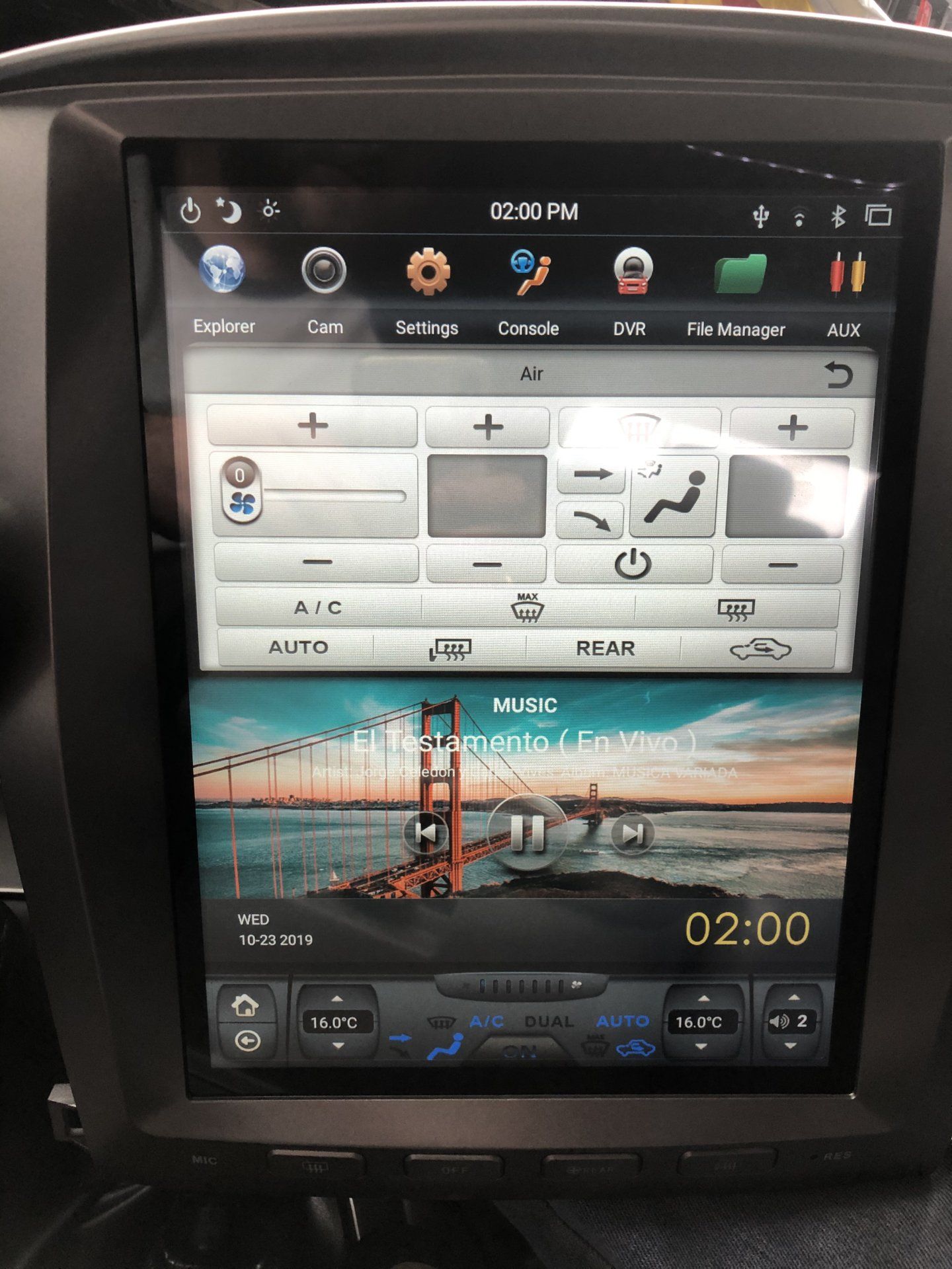

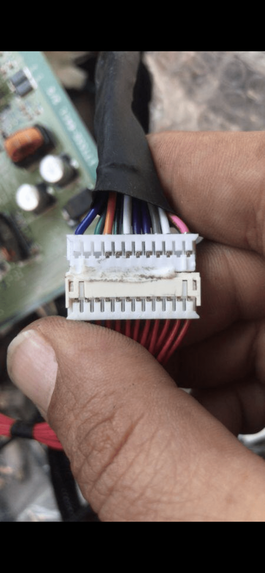

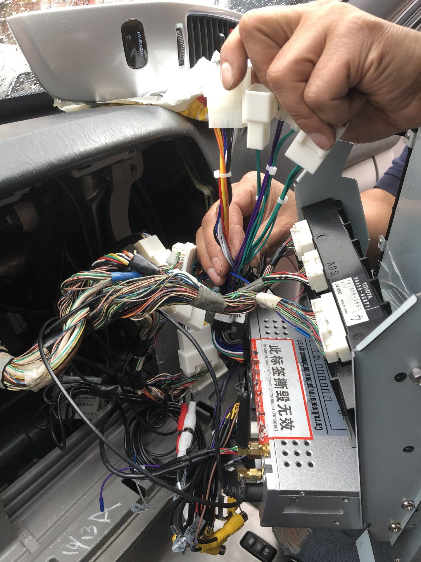

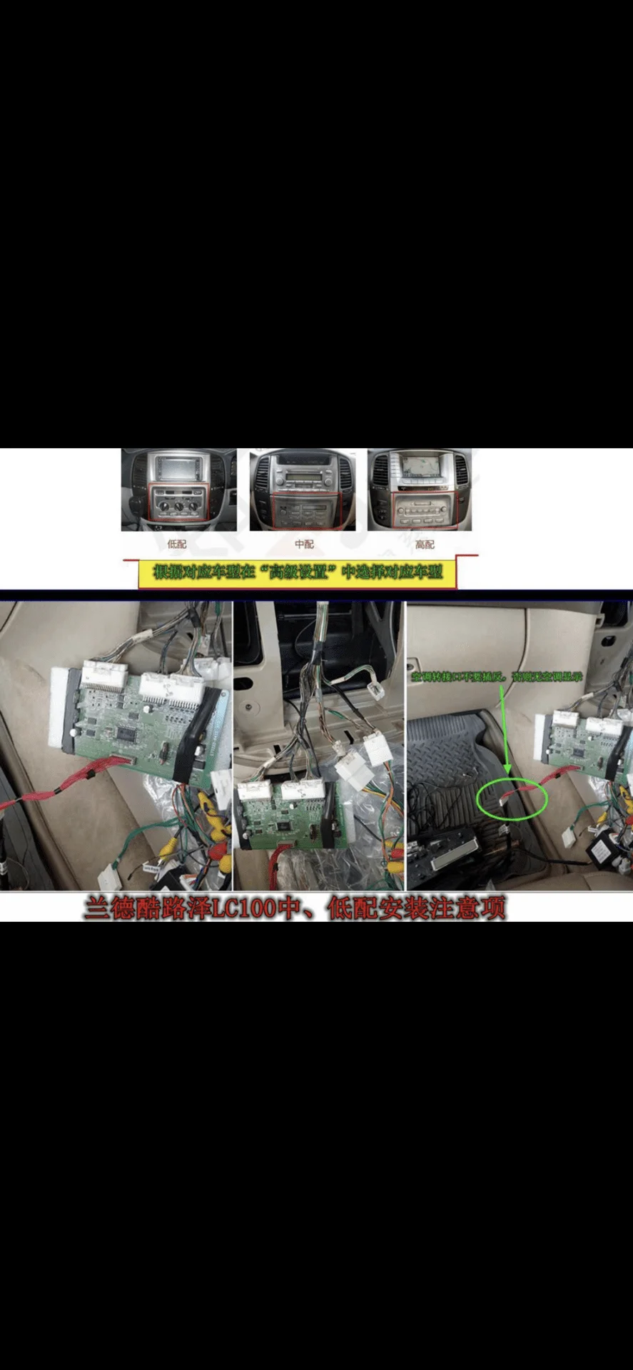

Hello @mvo,
Mine is a 2006 with Navigation and electronic A/C.
Attached are my connections where the OEM HAVC has been transfered to the tesla style screen (Picture 1).
Still A/C controls don’t work (Picture 2).
Have been trying to find out what might be done because some people talk about a “Premium harness which I already got but still does not work” and now other are talking maybe there needs to be done what is shown in Picture 3 and Picture 4 but don’t know if messing up with the OEM HAVC Box.
If you have any recommendations they will be gratefully recieved.
Those red wires/connection from the board is something that I didn’t have to do. Your harness from the decoder looks different from mine. You would need to take more detailed picture your harness (from decoder) for me to confirm.

It looks like you have the air conditioning working because I see blue highlight on the bottom with 16.0C. Try just pushing the + or - on the screen since it resets to <blank> when it's been a while since you started/rebooted.
