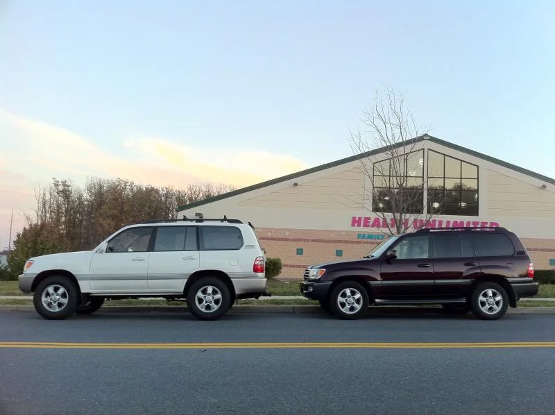

The spacer and torsion bar crank is definitely an inexpensive option for those of us driving an otherwise stock truck. The rear spacer is 1.5" and I've been adjusting the front to find the right combination of lift (appearance) and drivability (comfort/safety). My PS CV boot tore, possibly due more to age and mileage (117,xxx) than anything else. Before replacing the PS CV boots, I installed a Slee Diff Drop and also lowered the front a smidge. I was at 21.75" up front. Admittedly, this was too high (i.e. not enough droop, about .25" higher than the rear although it looked level). I backed off on the torsion bar a turn at a time (in my experience 1 turn equals .25" of ride height change) until I got to 21". At 21" it measures .5" lower than the rear, or .75" lower than before starting the adjustments, and I have 2.5" (63.5mm) of droop. Most would say it "looks" level, though I can see the slight rake.
The picture below is pre-adjustments, but is a great example of stock vs. stockish.
attachment.php
4Peanut, dude that is an awesome comparison thanks for the photo. I will be working on getting mine looking the same way. I can't tell in the photo but do you have front mud flaps? If so wear did you get them cruiserdan? You may have mentioned it in an earlier thread.
Thanks again
Never added front mud flaps when I took my running boards off still not chips in the paint.... knock on wood.

4Peanut, what year is that maroon LC in the photo and what size tires are on that one? I already have 275/70/18's on my LC but yours on the white one look bigger than 275's
Also do you know what size came on them from the dealership?
Which tire do you have specifically? All tires are not created equal. Among tires of the same nominal size there can be both a difference in perceived size (due to tread pattern and sidewall design) but also actual size. My 275/70-18 BFG ATs measure 33.25" in diameter at 50 PSI. The maroon Land Cruiser is 100% stock, so I can only assume it has 275/60-18 Bridgestone Dueler H/Ts on it. Here's another shot, nose-to-nose.

Thanks again, those pictures are really helpful. What year is the maroon LC?
I honestly don't know. We belong to the same gym, and when I saw it parked out front I took the opportunity to take a few comparison pictures. It has the same headlights, tail lights and grille as my '03.
