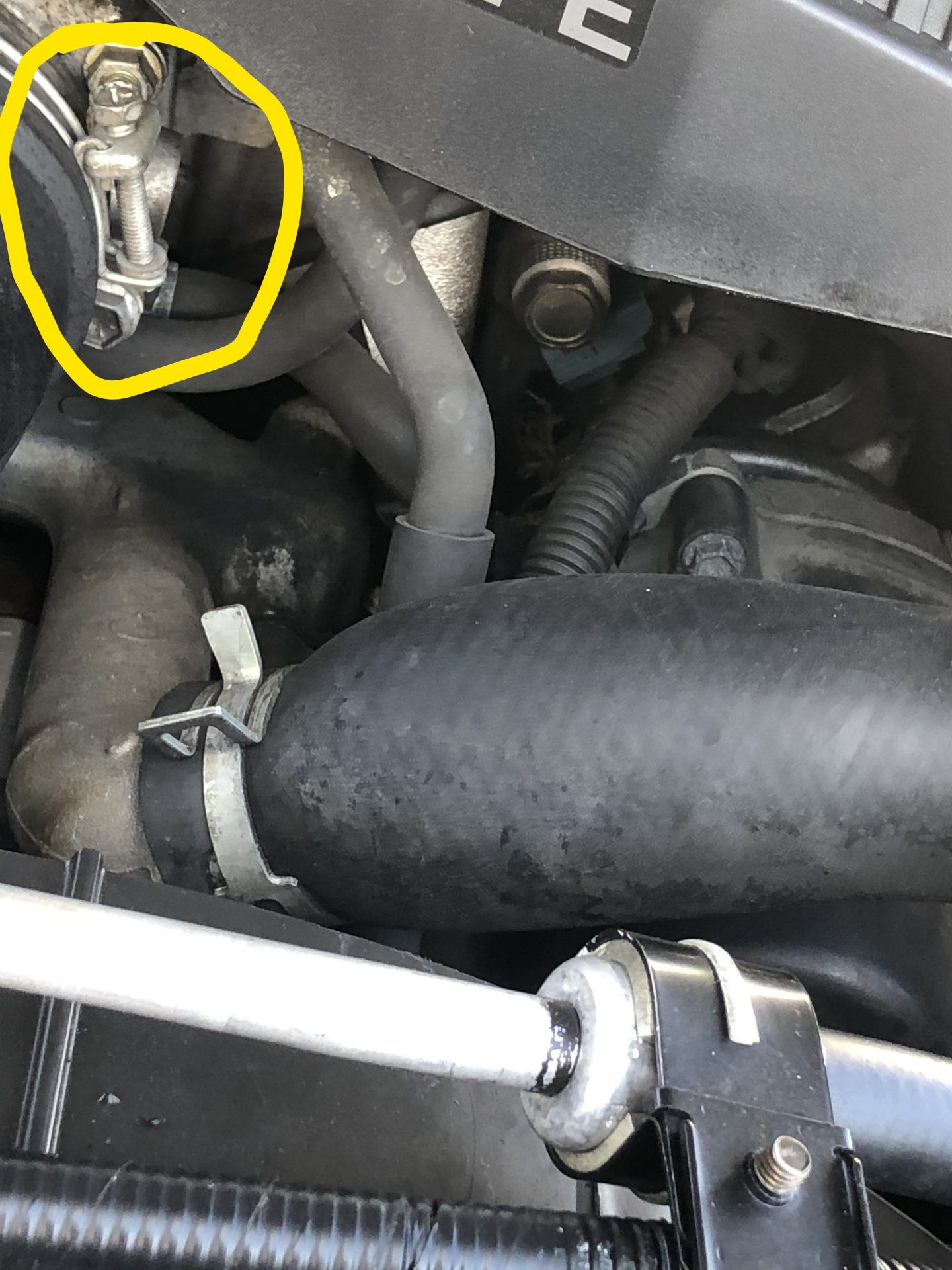

Hey all. Ended up purchasing an LX470 that was making a little rattle noise last week. It was delivered today, 225k on the clock. I determined it’s making a rattle noise when the heat is tuned on. Was looking it over today and realized the radiator hose was swollen like a balloon after running the heat for about 10 mins. Any ideas on this. Rattle noise seems to be coming from the top/thermostat area but it’s hard to tell.

Man thats rad hose is crazy. Your temp needle stays in the middle while running?

BTW the hose clamp on the fresh air hose to the throttle body is beyond loose

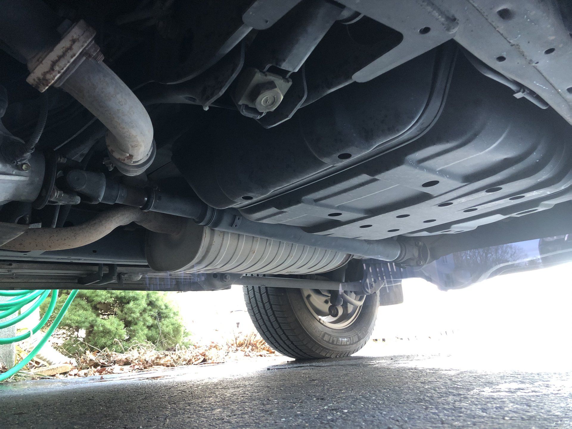

Spotless undercarriage. I hope you plan to coat that beauty pronto.
I know it’s scary to have in CT. Really terrifying some of the ones I come across up here. Honestly I don’t think I’m going to drive it on wet days up here at all. I plan on fluid filming it and then doing all the baseline, should buy me time til it’s nice in April and no more snow. Going to continue the rust beat down on the 4Runner in the background for winter time
