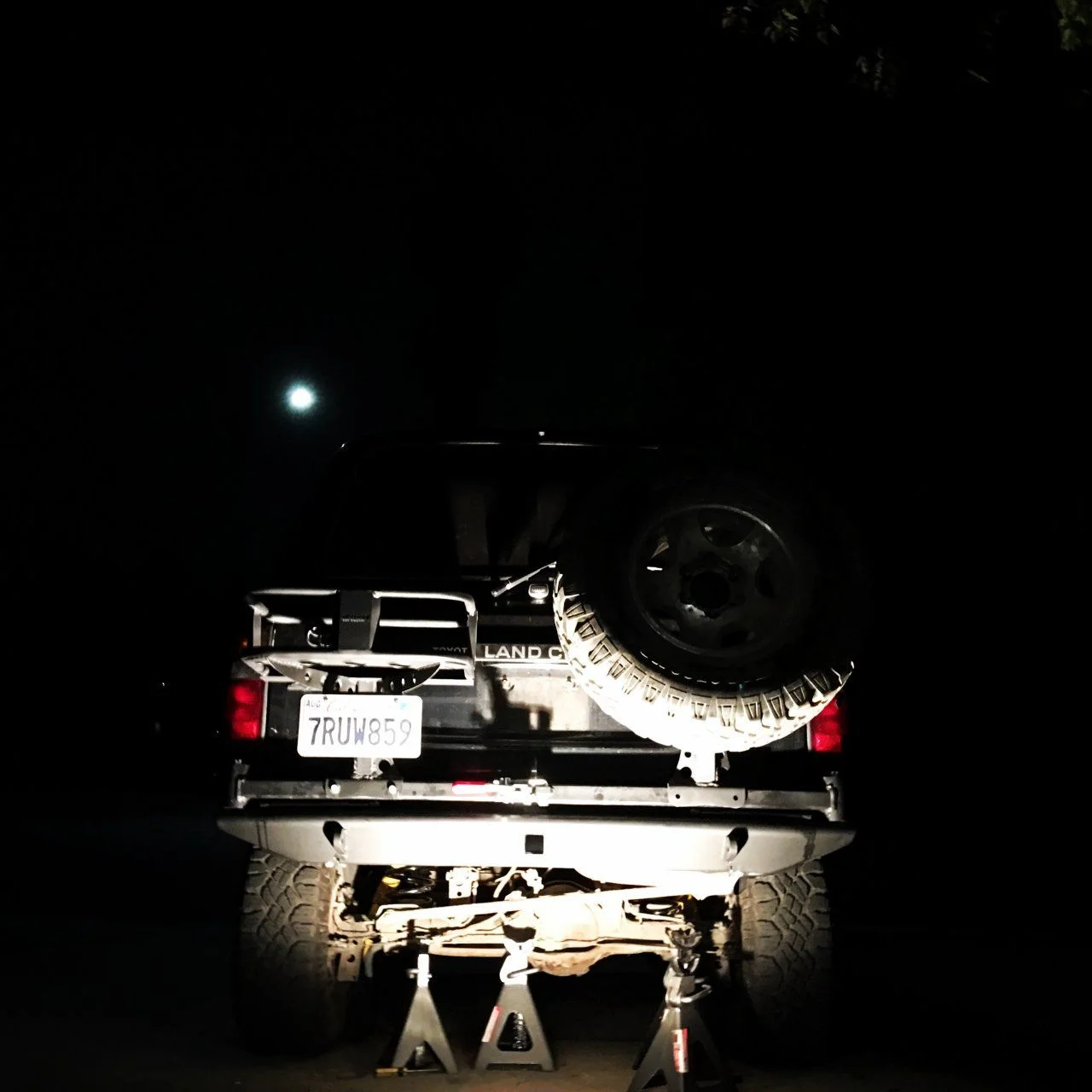

How did your Labs bumper turn out? I welded mine up with my Lincoln 140 using .035 flux core and no one is dead yet. In fact I beat the hell out of it on Rubicon.
Pretty well, used 035 with solid core. Also no deaths :D
.035 with gas and a full current weld and no worries. I'd consider flux if using a small welder on thick material. up to 5/16 and I'm good with .035 and CO2, and a good surface for the bead, with my lincoln 140. over that, and if I couldn't get my hands on a big MIG, then I'd consider the flux core...flux core will penetrate deeper, but is harder to make a clean weld with...
Lincoln 175 and used .35 fluxes on all my project builds (6 different sets of sliders, 3 rear bumpers and now front)
Just build the front last weekend 12 hours of welding and grinding. The rear is a lot faster to build.
