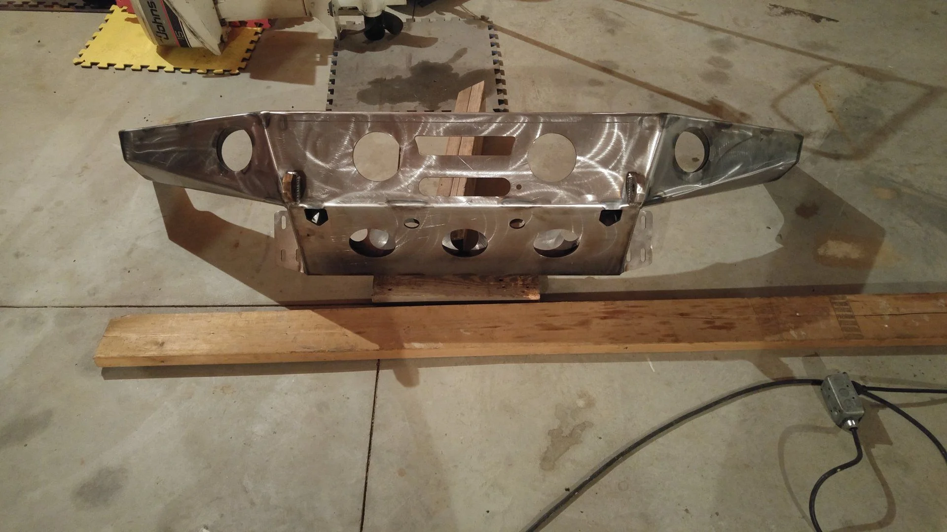

Bumpers and Winch: Relentless Fabrications stealth front plate bumper and Engo E9000 steel cable winch (currently not installed, needs to be primed and painted when I have time), rear is stock or whatever is left of it.

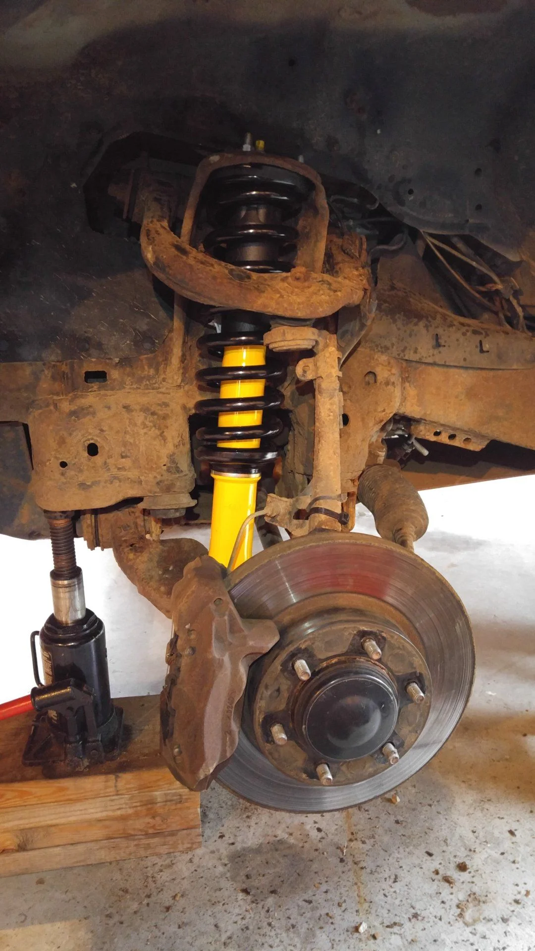

Suspension: Front, Recently (yesterday) swapped the stock coils and old part number Bilstein 5100's on 4th notch to Toytec OME 885 Struts/coilovers. Rear, stock leafs and stock reg cab overload, tapered 2" blocks (from a previous Rough Country 2.5" Lift kit) with Bilstein 5100's, Ruff stuff u-bolt flip plates and u-bolts, custom welded Ruff stuff 1/4" shock mounts.

One of the best days I've ever had, picking up this awesome bumper

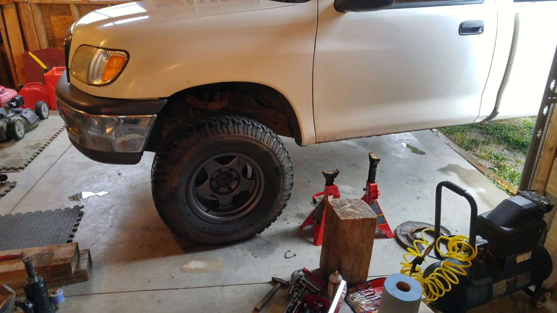

Currently how the front sits with Toytec OME 885 struts, will they be sprung enough for the bumper and winch? I guess I'll find out. Currently the ride is very firm but not uncomfortable, I think these will work great with the extra weight on the way.
