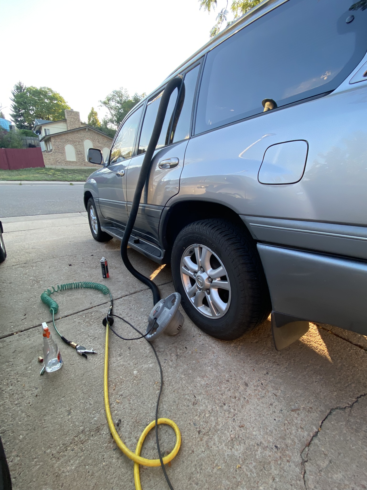

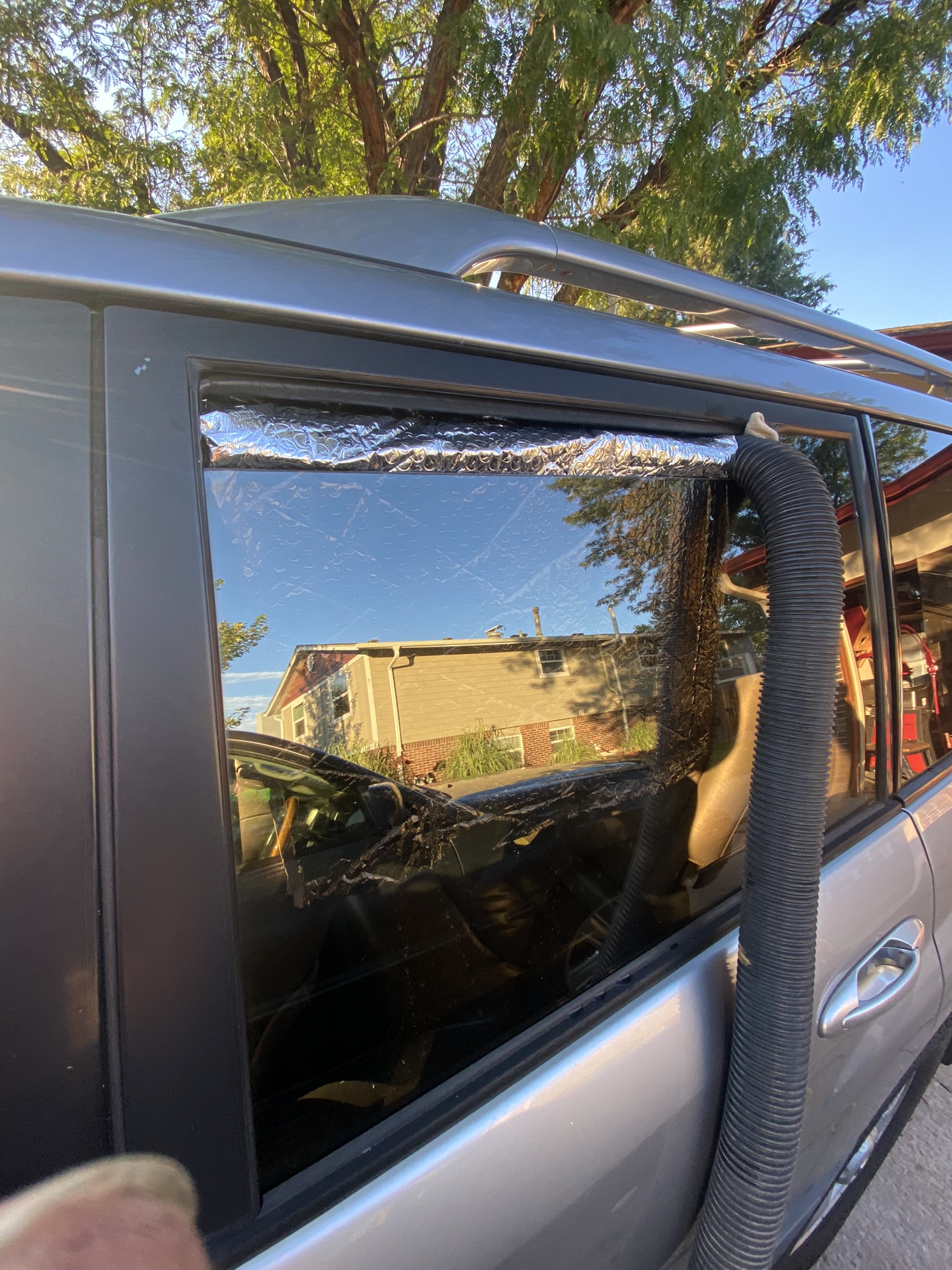

When I hear water related electricals issue. My first thought, is water entry into cabin, and getting on/in connection points. This can be circuit to or on ECM. Water entering around/under windshield molding, is common when windshield replaced. But very uncommon. If factory windshield and molding, still on and never removed. So I'd first test for leaks, if not factory install.
Pressurizing cabin and looking for air escaping, is one method.

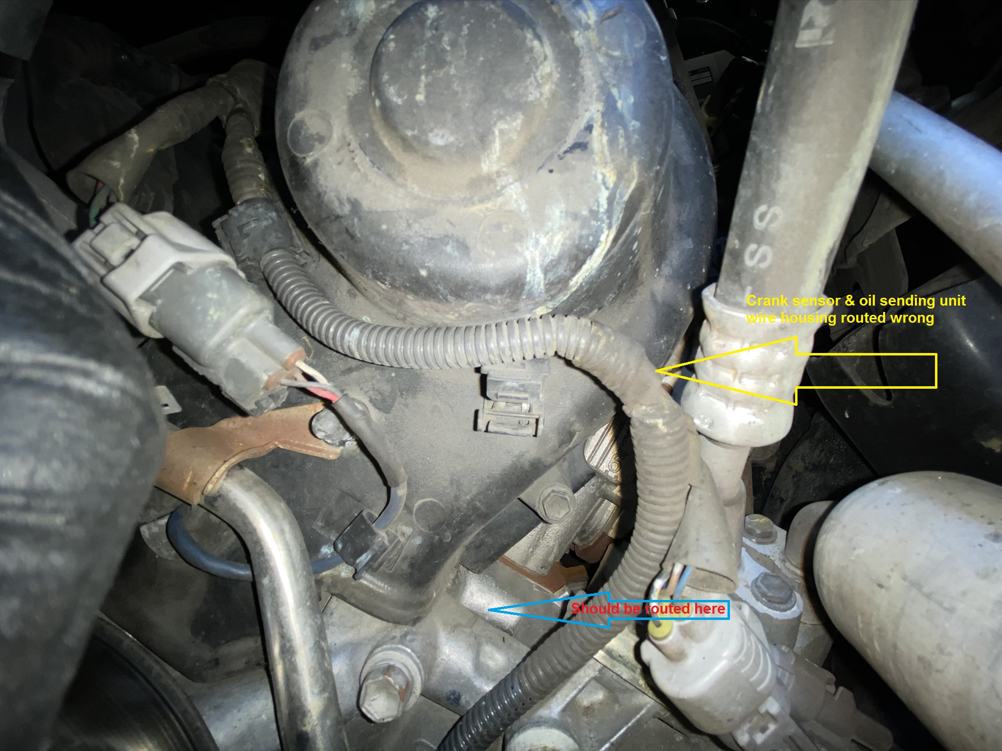

Looking under hood, would be a first step. But is my, second though. It's an issue we see, after timing belt or fan bracket service. All to often the crankshaft sensor and oil sending unit wire harness is routed wrongly, in front of fan bracket. Wires then very often rub on fan belt of one of it's pulleys. Wire housing, sheathing and wire are cut be the rubbing. If wire only partially cut. Water entering sheathing. May may create a temporary short circuit, between partial cut wires. Thus changing resistance, and confusing ECM.
"Second though" Since difficult for water to get to wiring in front of engine, just going through a car wash. But can happen.
