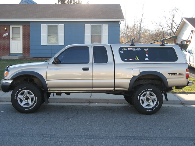

Old Springs vs New w/ AAL installed in pack

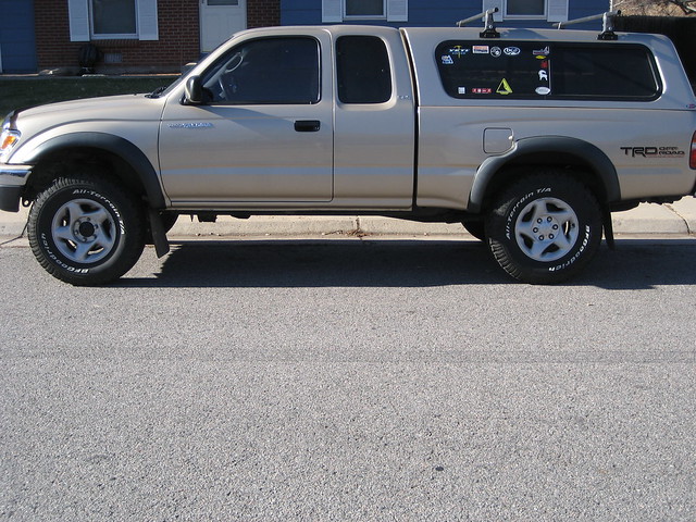

Finished product. A little tail high but hoping it settles a little. Makes the 265/75 look a bit small.
