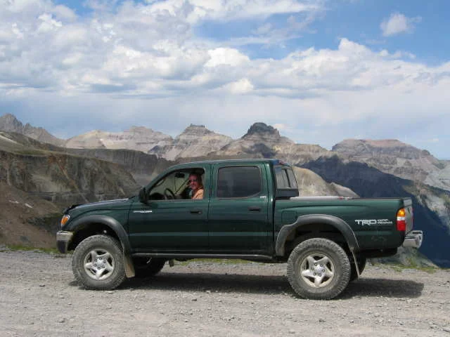

Eron's 2001 Taco (TRD 4wd xcab) came with a Fabtech 3 ro 4" suspension . We bought it for her used a months ago from a Toyota dealership . We love the ride and handling manners ...

Razor , that is the system Eron has on her Taco ... if I can remember , I'll take some pics of it tomorrow for you . You'll love it ...
