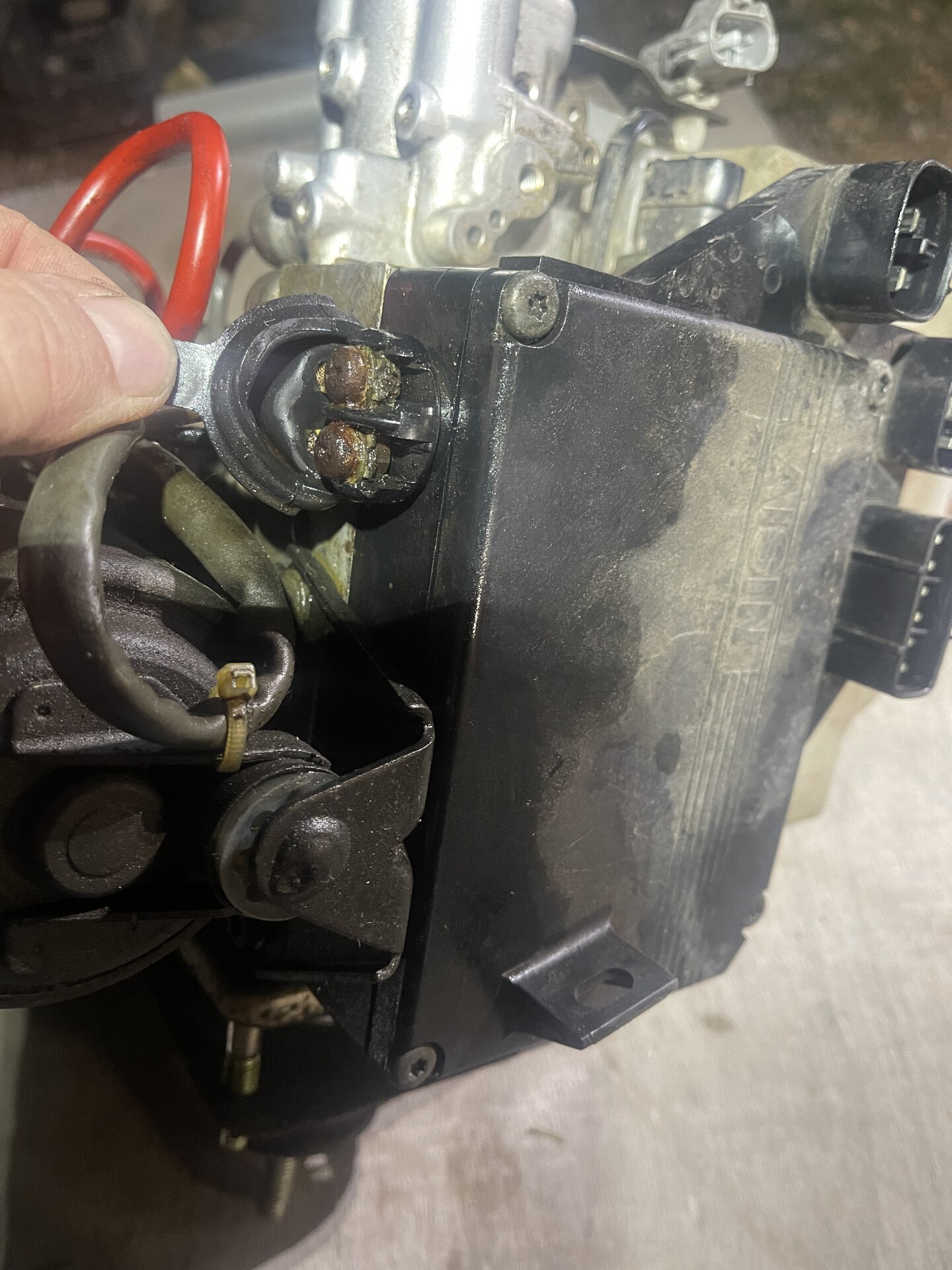

I pulled the brake master cylinder assembly and found the the brake booster pump terminals were corroded and the boot was filled with brake fluid from a weeping leak behind the ABS module.
My theory is that when coming to a stop the booster motor was shorting out through the fluid in the boot causing the engine to die and not throw a CEL code.
