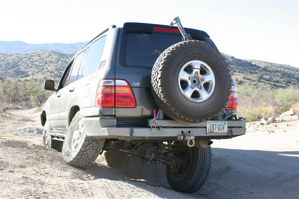

The FJ's suspension weekness is the same as the 100's....reduced front travel. We both have about the same 7.5-7.8 inches. Changing that is difficult.
What transformed the 100 for me was the N74L 80-shock. Since this mod, I can hardly tell the 100 from the 80 on even the most twisty and challenging terrain. The difference is tremendous. The truck is so stable and capable that I wonder now how I ever lived before.
It's very possible this mod will work for you too. I'm not the expert to tell you Y or N though I'm sure the needed experts are out there.
Here's a few examples suspension travel and the link to what I did is here:
http://shottscruisers.smugmug.com/gallery/856625
