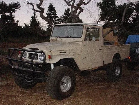

This is the truck the day that I bought it.

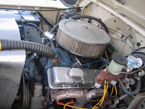

Here is the motor when I bought it.

Another SoCal 45 owner here! Mine is a 64 and it's my daily driver. ;)
From your engine bay photo, it looks like you not only have the later model brake booster system [not standard on 65s], but also the correct firewall brace for that booster.
Perhaps your cab is from a later model truck than you realize.:confused:

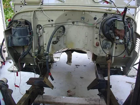

Firewall
You are very observant. Yes someone has done a real nice front clip to correct the problems created by the brace that would cuts through the updated brake system. This clip starts at the floor boards. The windsheld is also a later model but they kept the old style front bib and split hood. There are some things that are done very clean and others that make me sick.

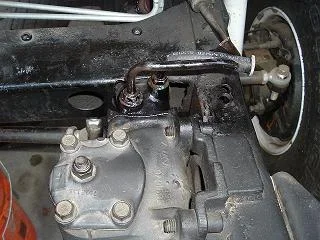

The hack job on the power stearing unit.
Here is a better picture of the firewall with the motor still installed.

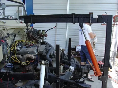

Here is a picture of the motor removal.
And my helper/son Brian.

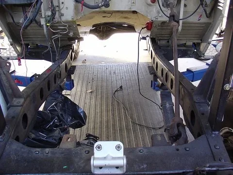

Ok, we got the motor mounts out as well as some other unwanted items welded to the frame.

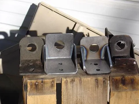

Here is a picture of the differance between the old school and the new and approved advanced adaptors motor and transfer case mounts.
Here is one of the frame minus mounts

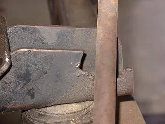

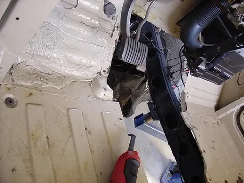

This is the front clip welding job on the floor board for those of you that asked about that.
Now it's time for lots of degreasing and sanding on the frame to get ready for primer.

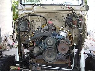

I have started back to work on the FJ45. I replaced all the body mounts with parts from TLC. It was interesting what was being used for these mounts by the previous builder. The TLC kit was expensive but a very nice kit or should I say two kits. We put the motor on a motor puller slid it in between the frame rails then slid the new Turbo 400 and an empty transfer case under the truck and bolted them together. Then we bolted in the Ron Davis aluminum radiator. Once that was completed we used another motor puller on the tail of the transmission and started to get things in place. We found that the new Advanced Adapter transfer case mount was too wide for the FJ45 so we ended up using the old one that came off the truck. It is not in the best of shape but it fits with a little grinding to where the new rubber mounts will bolt up. We will sand blast it and repaint to try to dress it up a bit. With everything in place we figured out where the plates needed to be welded to the frame. Then we pulled everything back out and welded in the plates. Because we are not only moving the motor forward to gain the needed clearance in the rear we are dropping the motor a few inches. We hope this will help the center of gravity and the driveshaft angle. With the motor in the new position we found that it will allow for greater air flow through the radiator because the motor will not be blocking it as much as before. This required shaving off the outside ends of the motor mounts so they would fit between the frame rails. Next step is to put it all back together and get the motor and transmission mounts in their proper location and tacks them in place. Then everything comes back out to weld in the mounts. By then I figure I will be able to remove and replace the drive train in record time. Unfortunately this is the busy time of the year for my company so weekends have been used to make money. The good news is the rebuild fund is getting larger.
