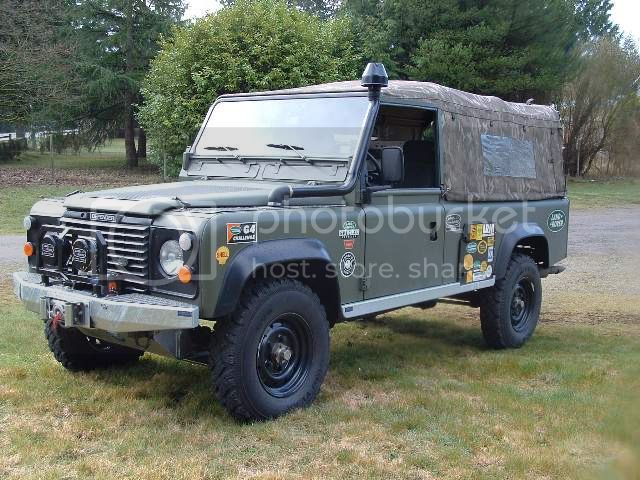

maybe after this you might not like me.......my other truck is a Land Rover Defender 110....C/W with all the armor built in Langley BC.....also not cheap
Gord
...that engine & Tranny/Xfer paint colour remind me of Yanmar....
I love the paint, my BJ70 will look like that someday. It lacking the toyota emblem turns me off, although I know the defenders are good truck, I like buying my parts from toyota, not ford.

I like my cruisers, but I also admire other rigs, yours is one of the cooler looking ones out thier.
Rob
Gord
