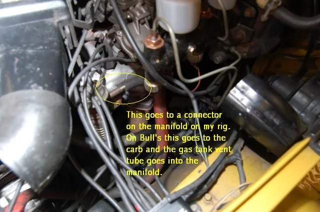

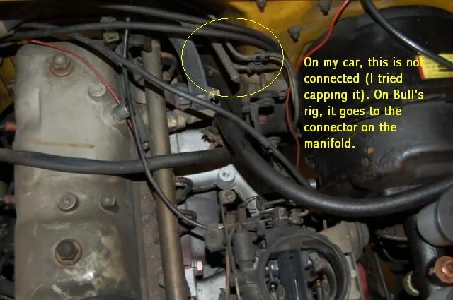

When I stopped to fill up with gas tonight (maybe 1/8 tank remaining) when I pulled the gas cap off, it practically blew off. POP. Tons of pressure in the gas tank.
While we were working on the rig today, we capped a few vaccum tubes and other non-connected items, including the 1/3" metal tube that is attached to the firewall to the left of the motor (behind the carb). Apparently this is supposed to connect into the manifold (I don't know if it is intake or exhaust) where the excess fumes will be burned. But because my rig (a '78) has a '75 carb on it, there is no where for this tube to connect up to.
See pictures (unfortunately I do not have a pic of the manifold where these tubes connect).
We capped it, and I think that's why the pressure built-up. I have since un-capped it.
Is my hypothesis correct that I should NOT cap this thing?
Where should I route it? I mean, the way it is now, I'm getting gas fumes in the engine bay, and that may be part of the reason my rig smells like gas...

on my 76 one of the bigger lines was the return line (capped off) the vent was out back buy the filler neck under the cover. it went back to the seperater and then down threw the floor (metal line) next to the quarter panel were it heads forward towards the engine. i just left it unhooked down along the body panel and have had no problems and its been 4 years know, maybe this summer i will run a rubber line up to a vacum port on the carb and see what happens ?
I have never seen a charcoal cannister that connects directly to the carb. It doesn't need much vacuum. On my '76, it connects to the VSV which in turn gets manifold vacuum. Get a factory vacuum diagram that shows what goes where.
bull said:
Its the line from the charcoal canister to the carb. It was disconnected and making the cab smell of gas. Eventually TEQ will have everything hooked up correctly. We plugged it to see if the gas smell would go away.
There shouldn't be a line from the charcoal canister to the carb. It must be switched by the vacuum switching valve (the black thing on the driver's side fenderwell with the octopus of hoses, as seen in the photo).
On the 1978-newer USA trucks there is a direct connection from canister vent to carb bowl vent. If you don't have an emission FSM, see fig 13.3, p.271 in the Haynes book.
The truck in question should have 1978 evap sytem. The 1975 carb doesn't have the large port on the carb for the outer vent hose. As a temporary fix (until a 1978 carb air horn is installed), you could reduce the hose size down and connect it to one of the vent fittings on the aircleaner.
If there is still significant pressure buildup in the tank, you can also swap the two hoses on the top of the canister, labeled "tank" and "purge". Hooking the tank hose to the purge fitting will allow the tank to breathe easily through the canister.
