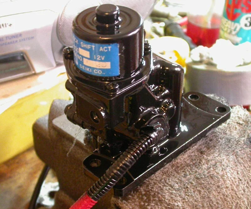

Just got done refurbishing Her rear diff lock actuator, thanks Raven for your insight, invaluble...

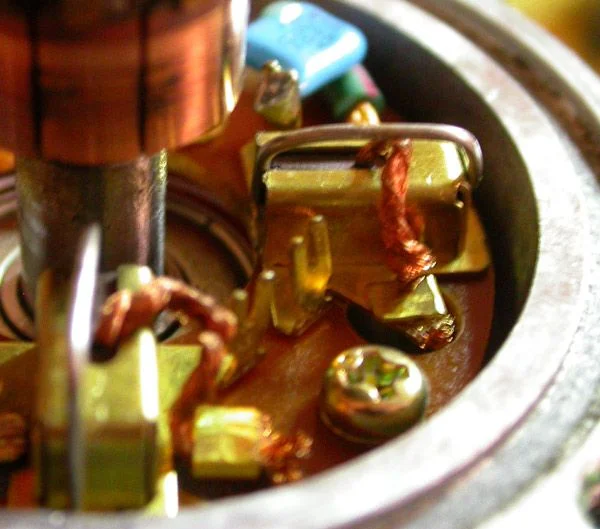

The rig in question is a new to Her '96 LX450 with 125k, I bought it knowing the rear was not locking and that it was a common, fixable problem (and leverage against the seller). After some time in the archives and driving around in circles I took it apart, found that a PO tried his hand at a refurb also. The magnets had been reglued, O-rings lost, and as it turns out reassembled incorrectly. I marked eveything, took measurements, got all scientific and everyhing, wouldn't work the PO's way, then I started from scratch with the help of Raven's post. Using all of his measurements I was able to get it working, it would extend and retract when I jumped it (briefly) from the battery, when hooked up to the wiring harness I would only get a little movement in the wrong direction (clockwise or plunger IN when I switched to lock). Take apart/put together/take apart/put together...same thing...so I get super scientific and break out the EWD...to make a long evening/not so early morning of trouble shooting short: turns out somehow the motors polarity is reversed. Lock juice from the computer to pin 3 at the motor had the effect of UNlock juice on the motor...cut the wires on pin 2 and 3 on the motor pigtail and swap 'em, now all is well....

well now that i have a star some pics,
swapped magents sounds like a good posibility, also did you get the cover the magents are mounted to lined up propperly?, I do remember some small line up tabs
Two of the three ears on the motor cover have little dimples in them with corresponding dimples on the case, mine is on right....why the motor acted in reverse is beyond me, I'm just happy I found it and made an easy fix

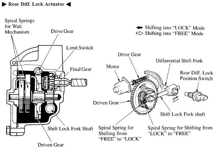

3. RavenTai, where did get you get the diagram of the actuator? Thank you for the writeup, the diagram and the pictures.

3. the diagram comes from the 96 LX450 New Car Features manual in PDF format, a very interesting manual, it talks about how things work with drawing and schematics, no instructions on repairs just "how it works"
each time a model is redesigned a full NCF is produced for that year, after that only changes are discussed, so if you have a 97 LC you need each manual from 1991 on to get the full set, for instance for your 97 to see the body info you woudl go to the 91 manual, for the interior the 95 manual, for the engine and lockers the 93,
since the 96 LX was a "brand new vehicle" as far as Lexus was concerned a full NCF was produced for that year, if you own any year FZJ80 it is the one to have,

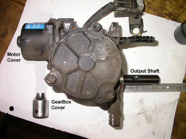

1. The measurements as given work. The picture was worth a few words as well.
