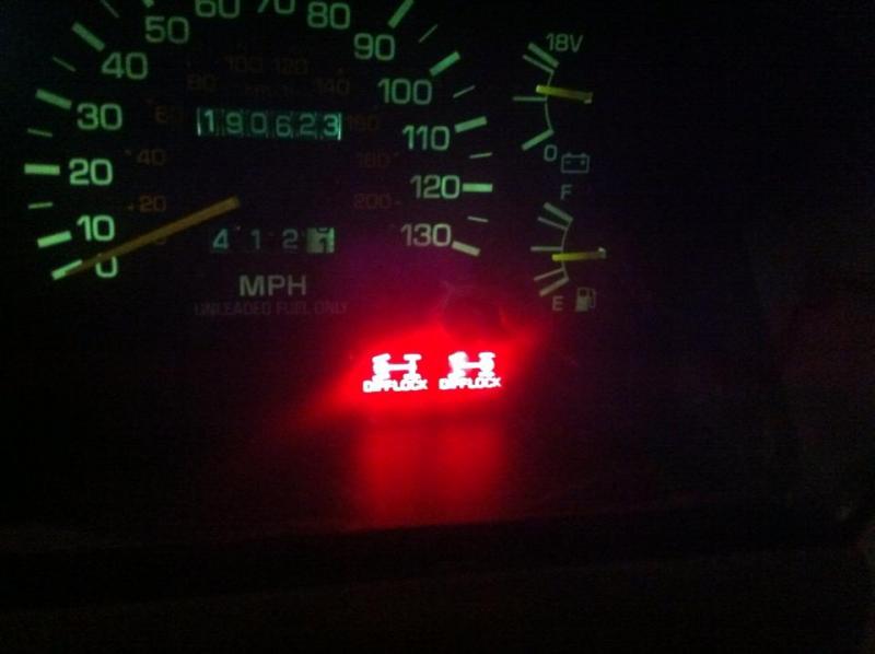

Officially triple locked again. Thanks for the help!
